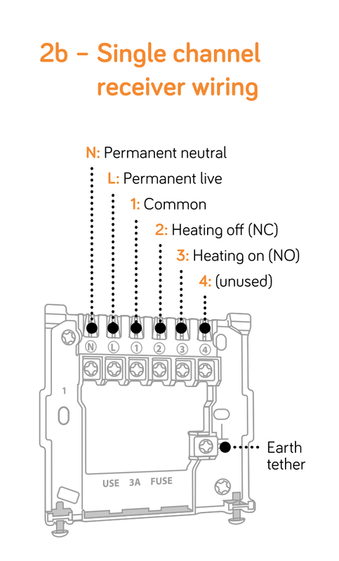

Hi everyone
I'm going to install a hive acting heating system.

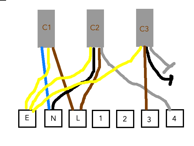

I have a system boiler (Glow worm 30sxi) + Maxiflo - edited thanks to Chris W with Honeywell controller and a wall thermostat
Does anyone know why there are three earth wires and should I connect them all to the earth hive?
I will wire the N and L the same and 3 and 4 the same but can anyone spot the wire to the thermostat I could leave disconnected in the Hive?

you have the wrong Hive for a combi boiler, it might be able to be used depending on what boiler you have, if your boiler is low voltage switching then that Hive cant be used
Ah sorry my mistake I do have a single channel hive , this is the wiring diagram for it

That’s not a combi boiler. You have a system boiler with an unvented cylinder. The first wiring diagram shows the correct hive you need.
Ah thanks very much - I will exchange the hive - for when I do get the correct dual channel hive, any pointers on the wiring?

I think the wiring looks the same, so maybe leave the backplate in, and fit hive to that?

For clarity this id the wiring of the existing controller
Shall I just wire the hive up the same and put the wall thermostat on max? Or can I disconnect the thermostat wiring?
