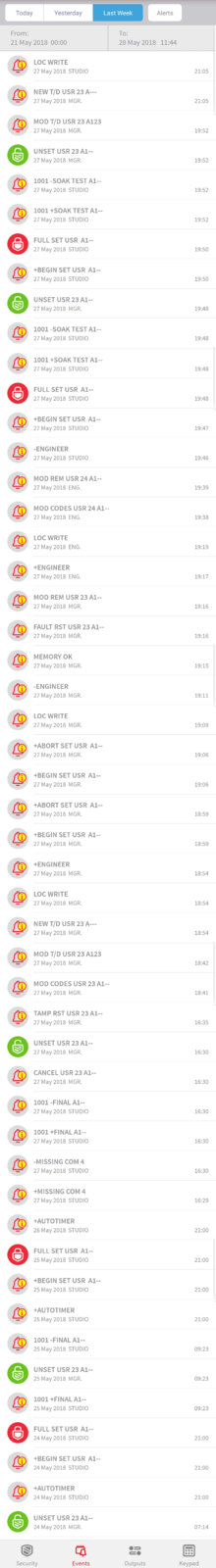

It started when my home router lost power, sometime later my studio (a separately alarmed building) started alarming. My wife went to reset it and told me it said something about Com 4.
When I got home from work I had a look at the situation, it appears that when my router in the house lost power, sometime later the studio went into a alarm state with external sounder triggering. As I only have the Ethernet board to allow me to connect and reset the alarm should it trigger while on holiday I do now want it to trigger a full (or any) alarm should it lose connection to my router or the internet!!!
So that's the first issue, I want to disable the com 4 error triggering the alarm.

Obviously you can see from the log below I was into several menus trying to find the things I wanted.

Shortly after I had a visit from a neighbour, saying my alarm was making a noise. On investigation it was chirping for about 3 seconds every say 2 minutes roughly. The keypad would cycle through the 'normal' home screen I have then ****************** on the top row and nothing on the bottom row, then blank, then back to the home screen. sometime during this sequence the the outside sounder would sound as above. I could not enter anything on the keypad.
I tried dumping the mains, then the mains and the battery to reset the system, after a few goes I appeared to have control again. As you can see I also put the zones I use into Soak as it was starting to get later in the evening (the only time the clock was 100% correct on the log below is 21:05 other times are not accurate)
So as well as my disabling Com 4 error question above I would really like to know what sent my alarm crazy, was it me trying to set up remotely on my phone app? was it com 4 playing up again? Maybe the log will tell an alarm guru what was going on, if so please let me know.

Flex 20 Log

Can you post your panel and Ethernet firmware versions? Use 'display system' to get the panel version and menu 61 diags for comm's to get the Ethernet module version.
I hadn't noticed the log you posted when I looked at your post first time. The Ethernet module dropped from the bus and started up again. You cannot disable that, as it's a fault. The module should not drop. As above, what versions are you running?

I would suspect a power rail issue. This would align with the module dropping, stars on keypad and chirping bellbox. Check the voltage on the 12v rail with and without mains supply. As it's a 3.18 I assume that you've had it installed for some time? Is the panel located in a warm area, as this can impact the life of the backup battery.
It would be better if I could connect and run full diags to check the system and full log.

Just to close off this thread, thanks GalaxyGuy for the tips and advice regarding my system both in the thread and by PM/Chat.
I have replaced A083-00-01 with the newer A083-00-02 following GalaxyGuy advice and hope that the fault no longer appears and the Ethernet card stays connected to the RS485 bus.
