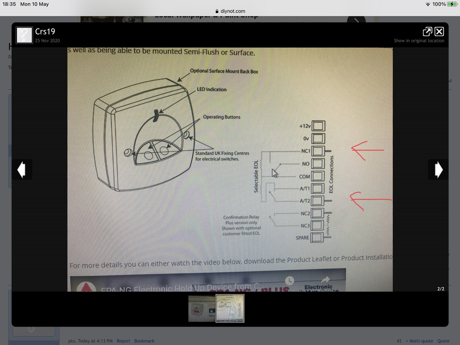

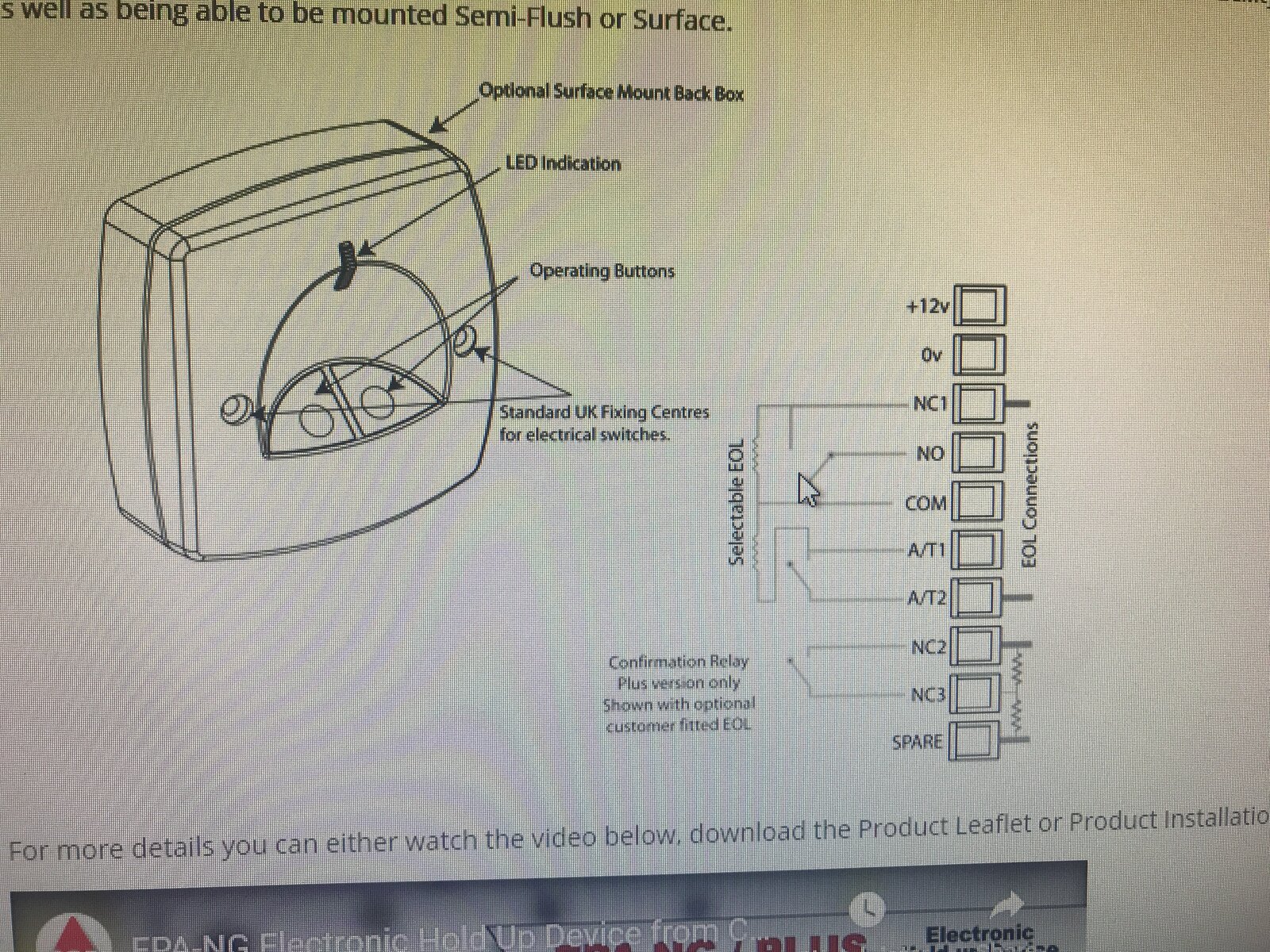

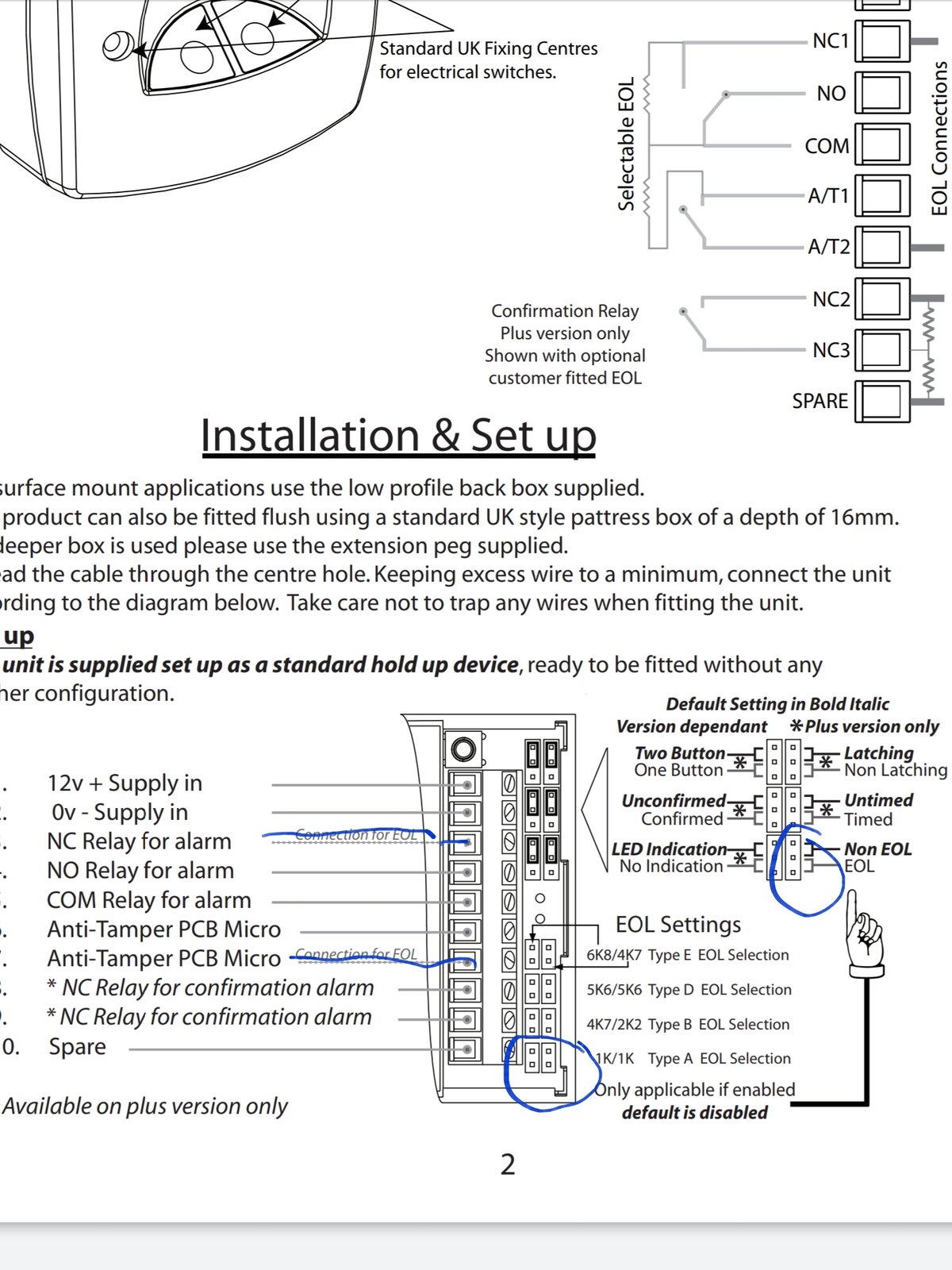

Looking for some guidance on adding a pa to my flex system
I have a pa alarm with build it resistors however no matter how I wire it it won’t work it I mainly get +mask error
Any help would be amazing
Am using the built in 1k/1k
One wire to a/2t back to zone
One wire to nc1 back to ov
Wires to +12 and 0v for power

Screenshot_20210511-081516.jpgcheck that the EOL jumper is on the correct pins for EOL Wiring format. Also check that the 2 jumpers are on 1K/1K value .
