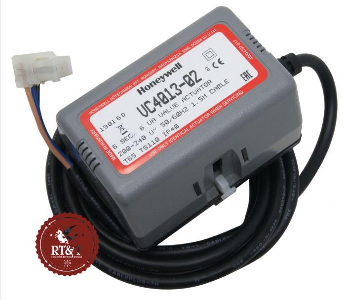

Hi there !
All the best wishes for 2024 !
I am hoping someone can help me ?
I have been reading about the Honeywell MOMO Divertor valve. ( Ports A, B and AB ).
I understand the valve only moves when mains power is applied - there is no spring inside this valve.
There are 3 wires going to the head of this valve - Brown (Permanent L) Blue (Neutral) and Black (Switched L).
As the Brown wire is permanently live I take it that all the switching must be done by the Black wire ?
Is the operation - apply mains power to Black wire - the valve moves from A to B and then stops ( assuming it is parked at A ) - mains power is removed from the Black wire, by the circuitry inside the head, when the valve has finishing moving.
Apply mains power to the same Black wire - the valve moves from B to A and then stops - once again mains power is removed from the Black wire, by the circuitry inside the head, when the valve has finished moving.
Is this correct ?

From a position of "I haven't tried this" my assumption is as follows:
Brown to L
Blue to N
Valve drives to one position, possibly A
Additionally connect Black to L, valve drives to the other position, possibly B.
Remove Black, valve returns to original position.
There are only two positions, A and B.

Connecting brown and blue to supply will do nothing.
Black is the neutral leg and brown or blue the drive wires giving MOMO operation
