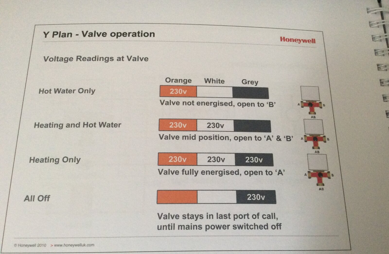

Honeywell st699 to Hive issue
Hi, yes, the diverter valve has 5 wires. White, Grey, orange, blue & Earth
I've also just noticed that I had a typo in the wiring centre ...there is a red also to the boiler in terminal 8 (I've updated the list)
If the swop from 699 to current controller is as per diagram, it should work
It would seem HW NO is disconnected
The grey should have 240 volts
With CH on, white should also have 240 on it
If I am wrong, sure I will be corrected
