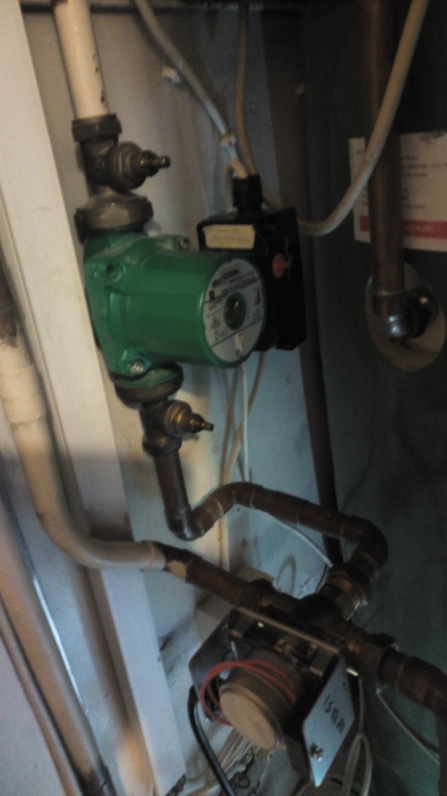

I have refitted the replacement and now there is hot water on both side of the y valve i.e. heating/how water but so far none of the radiators are getting warm. The pump casing and the pipes above are all hot (see image) and if I put a screwdriver to my ear I can hear the motor running so the hot water is going somewhere but this stops as soon as the HW demand is turned off on the programmer

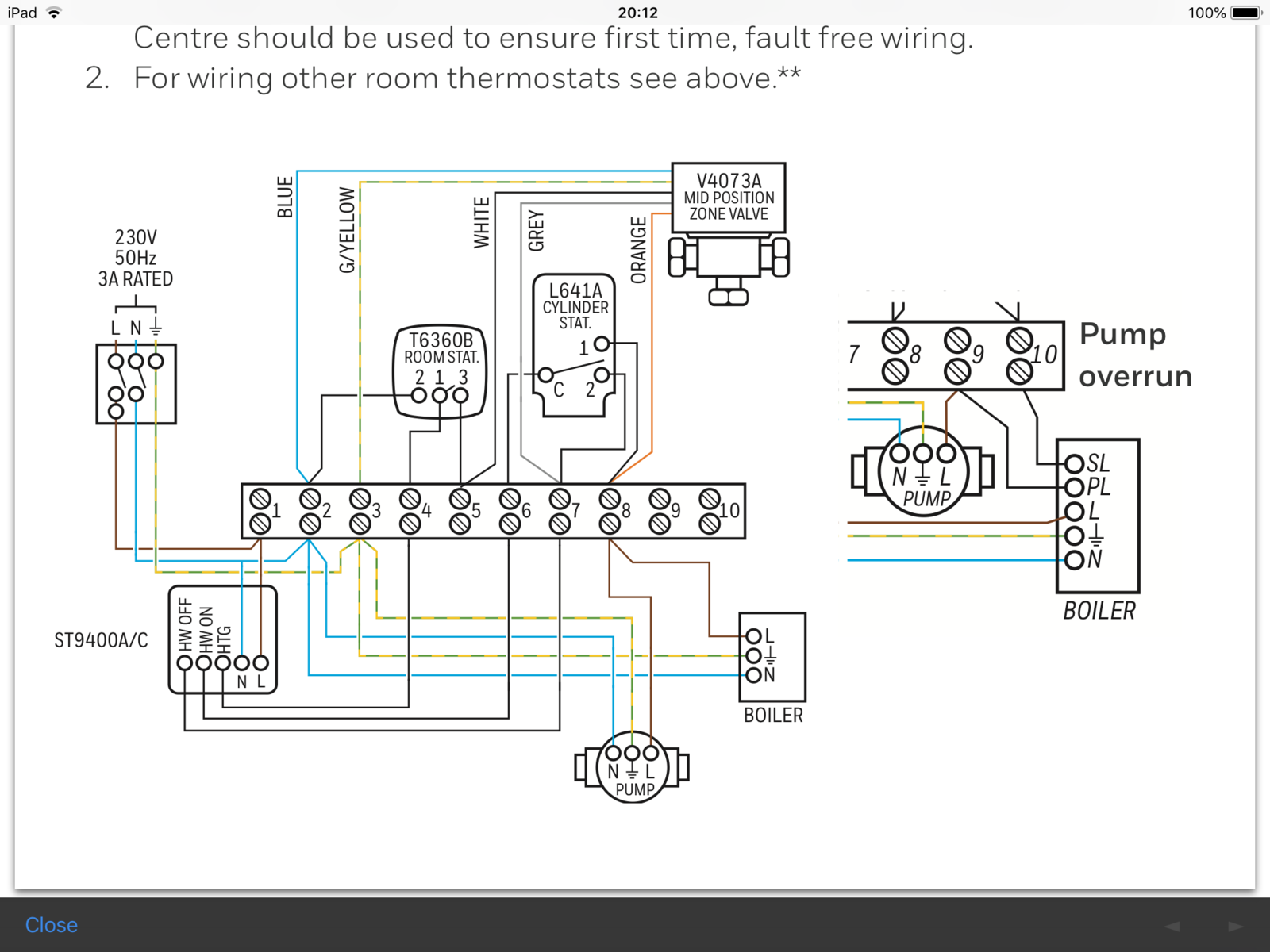

Or this if it’s easier? I can’t understand what you’ve done with the wiring you quoted.
Thanks for two very instructive replies. It's clearly a wiring issue but not show what I have got wrong. I will compare both diahrams with my own to see if I can trace the problem and also draw my own current wiring circuit for comparison and post for further help if necessary.

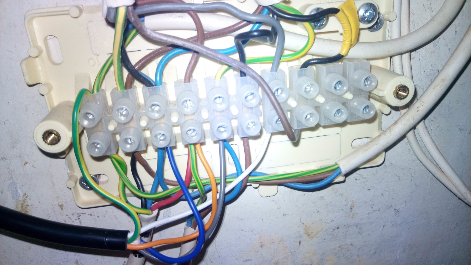

Hi, thanks for the reply. I have managed to get a better picture of the wiring which I hope will help you understand better and come up with an answer.
The black cable coming in from the bottom left is the new y-valve head can and to the best of my knowledge all I did was a simple one out one in, I shouldn't have touched anything else.
I am also trying to create a hardcopy wiring diagram but it's taking me time.
I have decided to ignore the numbering on wirine box and treat as standard i.e. number 1 is first left. For the y-valve this gives:Green/Yellow in 1, Blue in 3, Red in 4, Grey in 5 and White in 7
Photo is much better, thanks. If you’re saying you swapped like for like, then only other thing is it’s been fitted wrong?
Hi well I fitted it myself and it's not really possible to fit wrong, at least I don't think so as the screws wouldn't match up.
Going back to the wiring picture can you see anything that looks wrong. I could have made a mistake I suppose. If you need clarification on anything then please ask.
