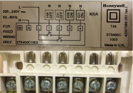

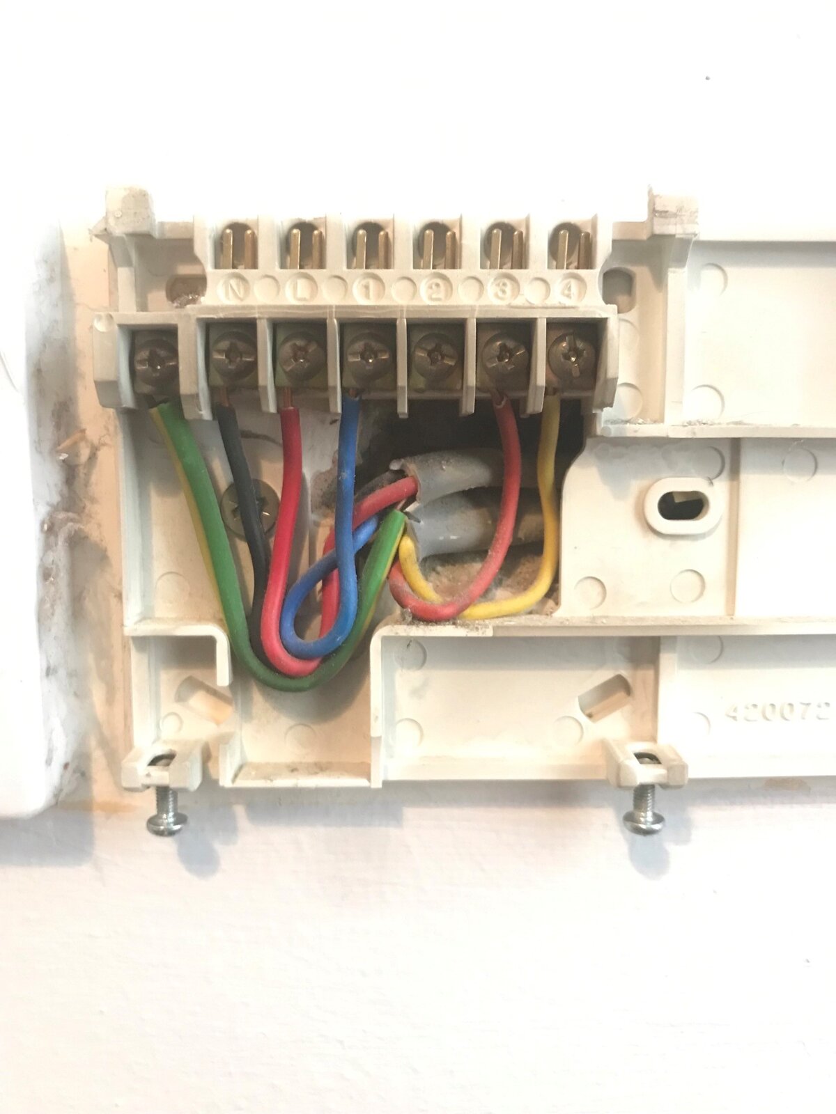

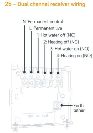

Hi All,
Just a question to confirm my wiring to Hive from a Honeywell ST6400C.
I've attached a picture of my current wiring into the Honeywell.
I have not got a room stat installed the rads are all controlled by TRV's.
I'm assuming that I just connect the wiring as is now into the Hive back plate?
I hope I've given enough information to get an answer.
Thanks in advance
Paul.
If you have the Hive dual channel receiver, then it should just connect onto the backplate as is, should you wish, as it’s an industry standard backplate. However if you want to change the backplate, then yes, it’s the same wiring.
The Hive Dual Channel version of the Hive has the same connections as the Honeywell ST6400C.
If the radiator in the room where the Hive Thermostat is located has a TRV on it, this should be removed, or at least set to its maximum temperature, otherwise it may interfere with the correct operation of the Hive as per the Hive manual
Hi again, just wanted to say that the Hive is now fitted and working, thank you for your help and replies. :)
Cheers Paul.
Thanks for the feedback, not everyone takes the time. Glad to hear it’s working ok.
