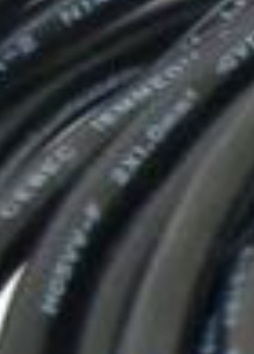

Expensive, but genuine spare:
https://www.ransomspares.co.uk/part...-(henry)/power-cable-lead-plug-10m/146188.htm
The writing on the wire in the picture says 2 core, 1mm!
I looked at those and it seems a lot for a 10m bit of cable. The plug on the hoover end I will have to cut of as it goes straight into screw terminals inside and I've already got the 3 pin plug. I can get 10m of 2 core 1.5mm² flex for less than £10 online. It's only an old hoover i keep in the garage for hooving the car out.
Thanks for that. It was kind of what I was thinking but its nice to know other people think the same. Good spot with the photo RandomGrinch
