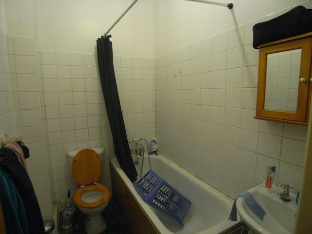

Hoping some of you might part with some wisdom please.
25 Oct 2013
3
Bristol
My girlfriend and I have just bought a ground floor flat and it needs a new bathroom. We're not big on baths, so we have had the idea to rip out the old bath and replace with a nice sized shower cubicle instead. In order to do this we'd need to also move the toilet to the side wall.
A non-plumber mate has suggested that this would involve moving the soil stack which could be a real pain and therefore also very expensive.
Does anyone have any advice or experience to whether this can be done and how much work might be involved?
Current
Desired layout apart from we'd leave the sink where it is.
Could really do with some pics of the existing bathroom and position of stack pipe.
Shifting the loo position will always be an issue, especially if the drain goes into the floor and not through the back wall.
We really need a plan view of the bathroom to see whats what, but it could be possible to pull the shower cubicle back towards the basin and relocate that......small bore drains are always easier to shift, and there's obviously outlets at that end of the room anyway.
John :)
I suspect the WC has a vertical outlet straight into the floor, in which case moving it will cost ££££££££, if actually possible. Unless you have very deep pockets, the WC will have to remain in same position, the new shower/basin will have to be fitted in around it.
Looking at the picture I thought the outlet was through the floor to the left of the pan.
It's a bog brush holder! :roll:
Easiest: Move pan to the left, fit cubicle where the bath is.
BTW, sinks are for kitchens, basins go in bathrooms. :wink:
