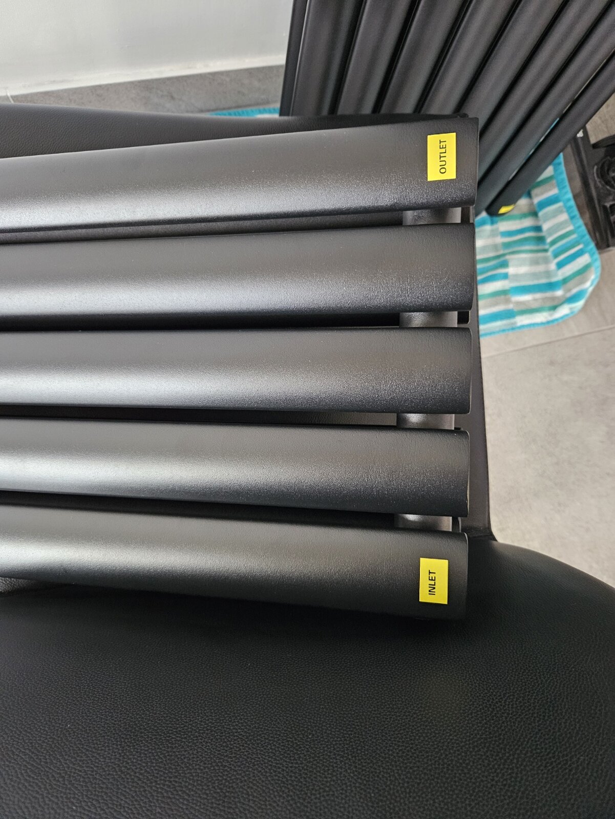

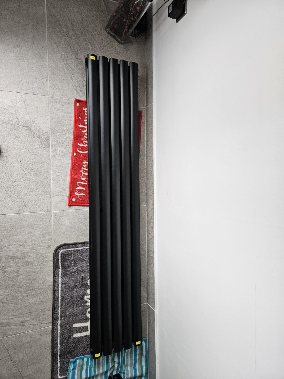

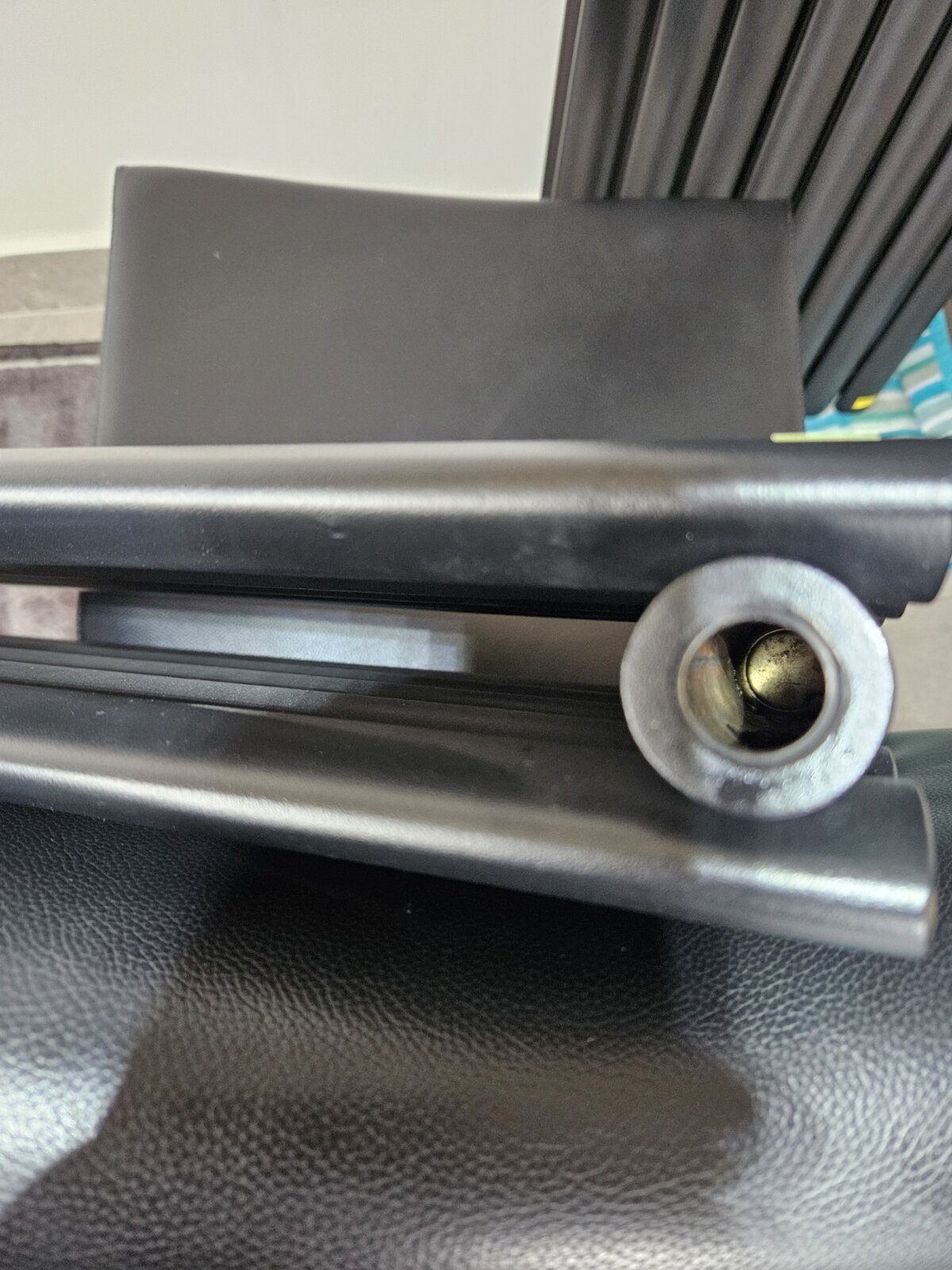

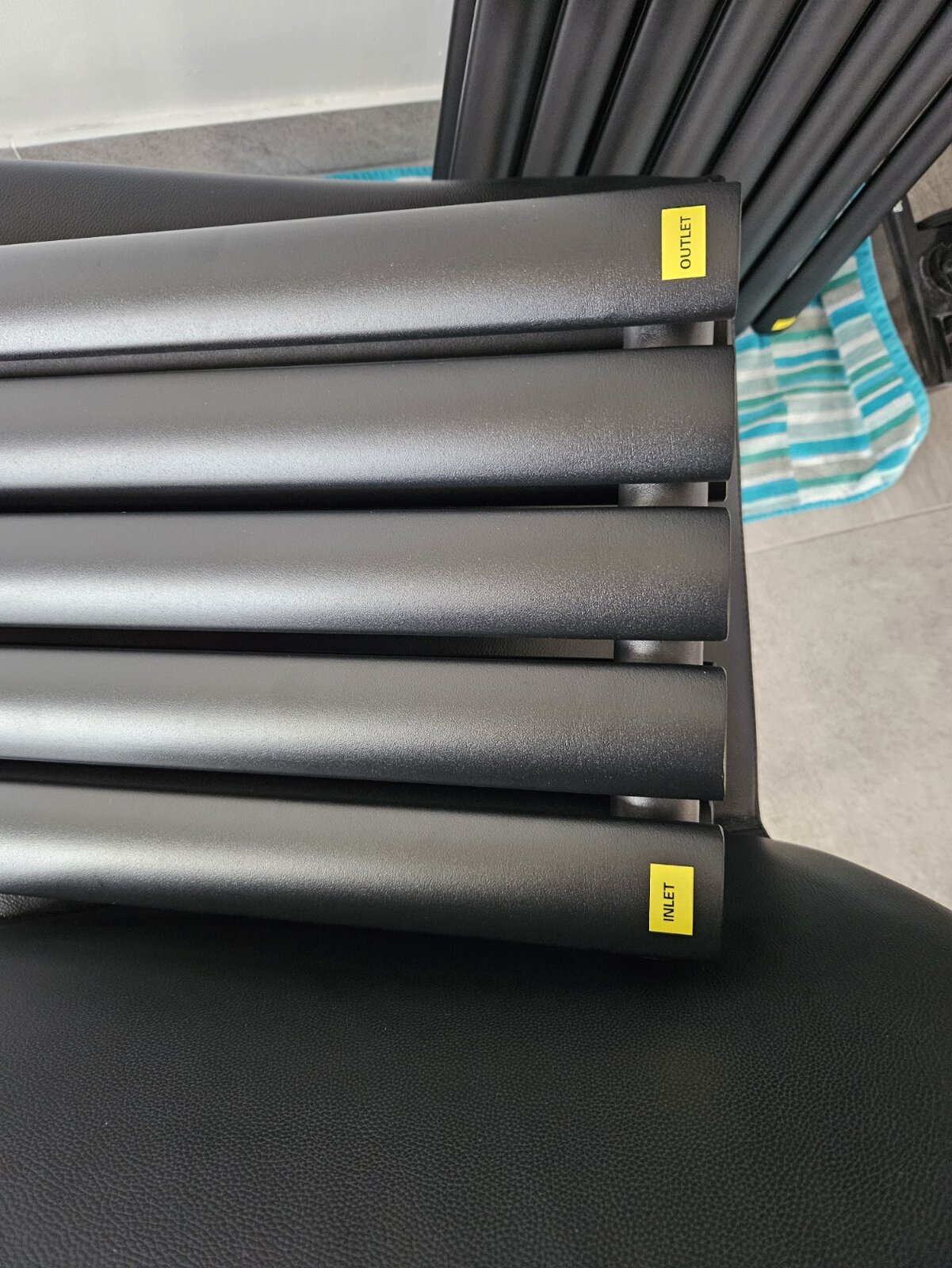

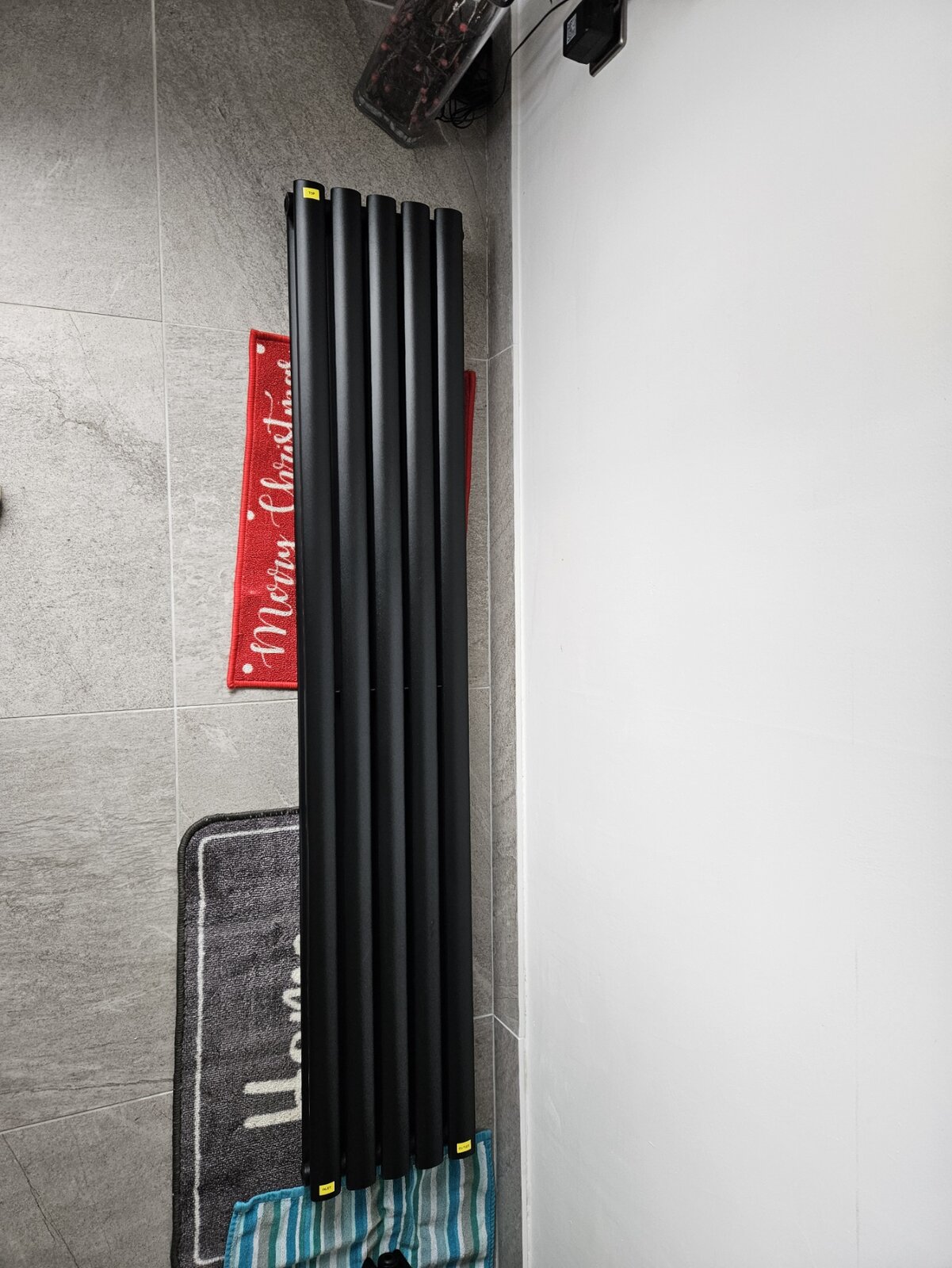

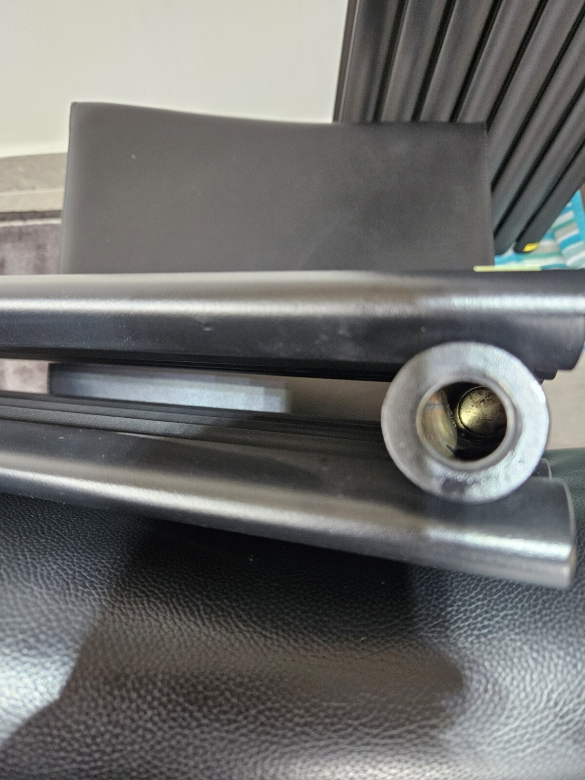

Hi
Bought a Radiator from Victorian Plumbing as a Horizontal Radiator. (I believe the radiator can used in either Horizontal or Vertical orientation) The drawing that came with the Rad shows the rad in Horizontal mode, and has a Note next to the end of the rad that a says 'Blocker - knock it off before installation'. The rad has 5 horizontal tubes and the drawing shows this 'blocker' is inside the end tube level with the middle tube, at the end nearest the Inlet/Flow connection. (See photo looking inside tube from Inlet hole) I am assuming that this blocker is for when the rad is used in Vertical mode and I need to knock it out using a hammer and a longish piece of doweling or something similar. Could somebody advise if possible? If it is to be knocked out of place isn't there a chance that this piece of metal disc could potentially cause a blockage if its floating around inside the rad? It looks too large a diameter for it to come out of the threaded inlet hole. Any advice welcome

I doubted him given that the wall fittings used small grub screws (I was concerned that the fittings would not hold the rad up) . I emailed the manufacturer, they confirmed that it should not be fitted horizontally. They additionally mentioned the baffle (not removable).

What kind of brackets came with the rad, if they are hooked brackets as in the pic then they are only designed to support the rad vertically via the top and bottom horizontal tubes.
What is the rad replacing, please also be careful, these rads will not replace normal convecting rads when their output is like for like. They will not heat the space in the same way and as efficiently, unless the room is on the smaller side.
Hi Madrab
The brackets supplied are the ones on the right ie NOT the curved ones !! So for the Horizontal mounting.

As far as the baffle is concerned, using a punch to knock it at one edge and you should be able to leave some of it connected so it will allow water to pass but won't be loose rattling about in the rad. Alternatively you can 3/4 size drill it but then needs flushed to get the swarf out.
