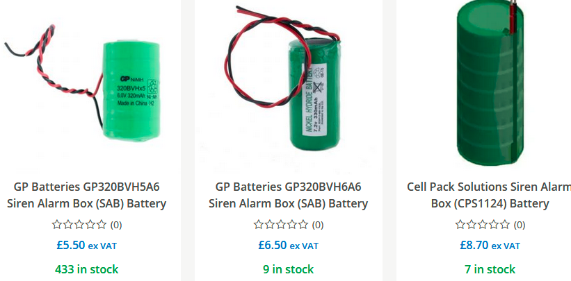

On cellpacksolutions there were these. They have numbers after (and are different shape, although I don't mind that) - am I looking for one without numbers after?
are batteries of multiple cells joined together, that's why they form a longer cylinder.

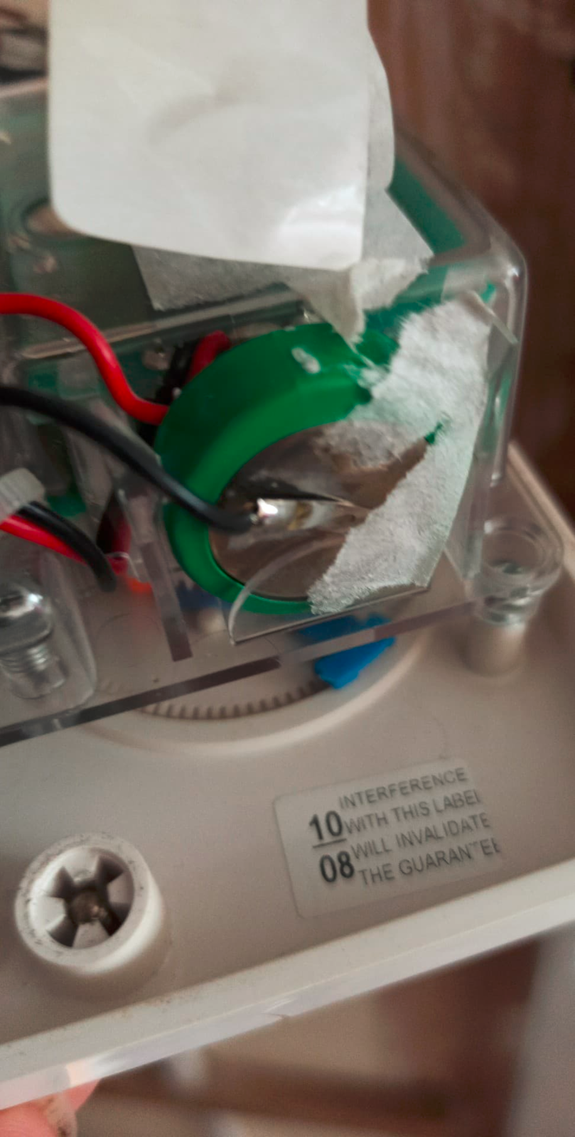

does yours look like the illustration?
Thanks for further input & info, John.
yes it looks similar or the same (see green in photo - are you able to see it or would a better photo be better?), although I haven't measured it yet. Many button batteries seem to look like this!
If there are several cells packed into the same wrapper, it would be 1.2v each, so you could have five connected and wrapped together in a 6v battery. It is tiresome if the wrapper did not have a reference number.
Yes, this is why I have started looking at multi packs - I'm assuming I can take them to bits. Only problem is the tails (are "tags" what the tails are connected to?)
