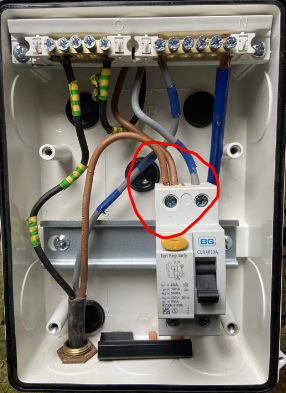

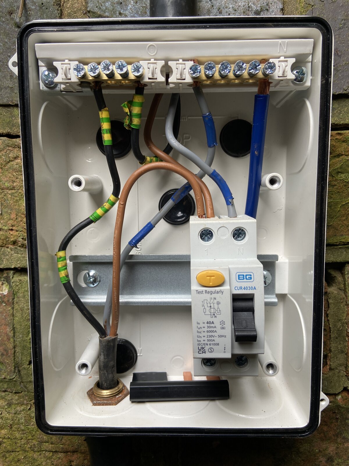

This is what I find weird,
see attached pics which may help in explanation

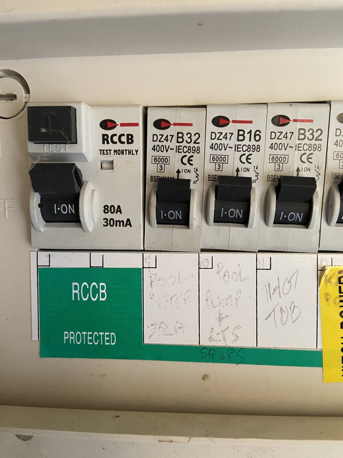

1/ first pic shows the CU in outbuilding - RCD protected B32

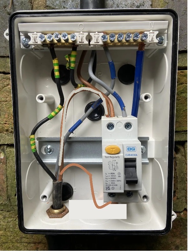

2/ pic shows wiring to the smaller IP65 box adjacent to tub (feed coming in the top, wiring to tub going out the bottom)

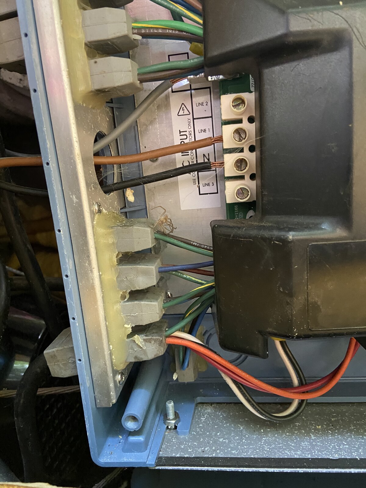

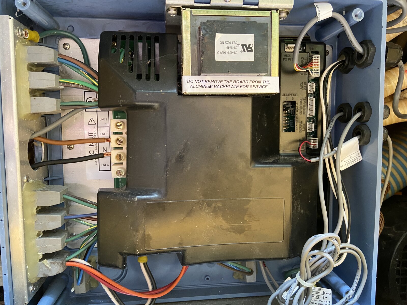

3/ pic shows inside the tub, the wiring set up. Top ‘box’ diagram shows an earth symbol (obscured by that bundle of wires), then in descending oder ‘LINE 2, LINE 1 (with brown wire) , N (with black wire) and LINE 3’. (I’m assuming Line 1 = LIVE and LINE 2 + 3 unused) as you can see form this it appears earth and neutral are swapped in the tub.
The 40Amp double pole switch 100% works as is brand new
and the B32 switch also definatley ‘functions‘ as an on off switch and also ‘trips‘ if tested

I would suggest that you supply good, clear photos of all connections, RCD's and MCB's with the covers removed, including one of the name/rating plate itself, on the tub.

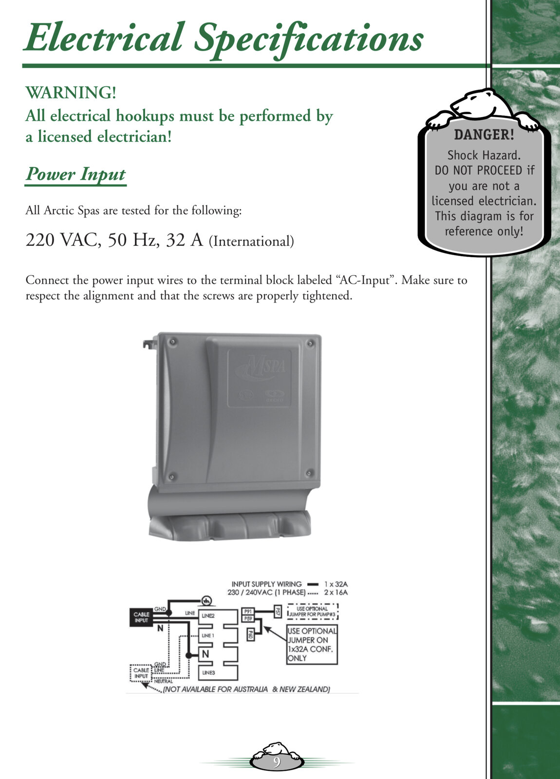

found the instruction manual for tub…

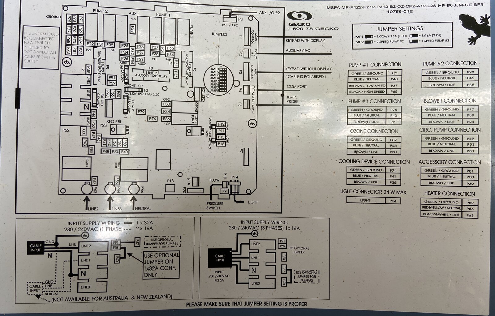

in the current set up LINE 1 is assumed as LIVE…. Looks like it’s actually LINE 2 that should be connected?
anyone any thoughts on this before I go do something stupid….
looks as if it was connects as if it was set up for 2x 16amp in stead of 1x32…. Would this be the reason for the trip?
They appear to be - but could there be a junction box somewhere where the wires are swapped (for some reason)?
OR
Does that plastic cover come off and perhaps the tub wiring is wrong?
So load (tub) should be connected to underside left hand side of the RCD?
Yes.

Found this diagram handily on reverse of tub panel….
appears that brown LINE 1 wire should indeed actually be in LINE 2 socket,
maybe this is causing the trip as it’s mistakenly trying to 2x16amp power and causing issues?
