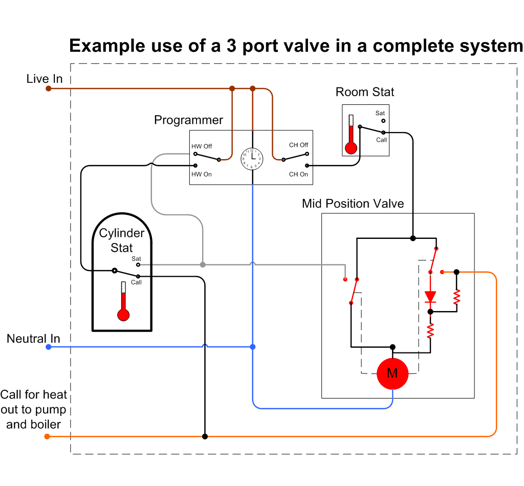

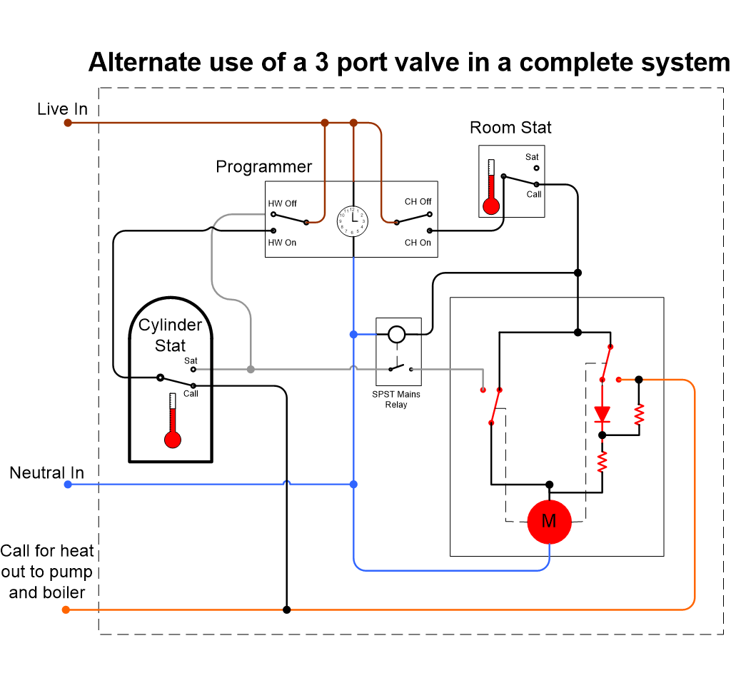

Losing excessive heat overnight can also occur if the mid position valve's last port of call was HW heating which can cause gravity circulation through the heating coil, a spring loaded NRV just before the coil inlet should stop this.
Yes, my system does have that isssue (MOMO 3-port valve), but the heating comes on last thing on an evening, which to some extent prevents it.
I can see that the tank is insulated with 35mm thickness of spray foam insulation. This really isn't all that thick, and adding more insulation over it with definitely improve heat retention.
This was noticed by someone who had been doing the same as you, heating on last at night to reduce it (by a very substantial amount) but then installed the NRV and modified the Y plan so that the valve is powered only when both CH & HW requested or CH only so allways returns to HW at night.
