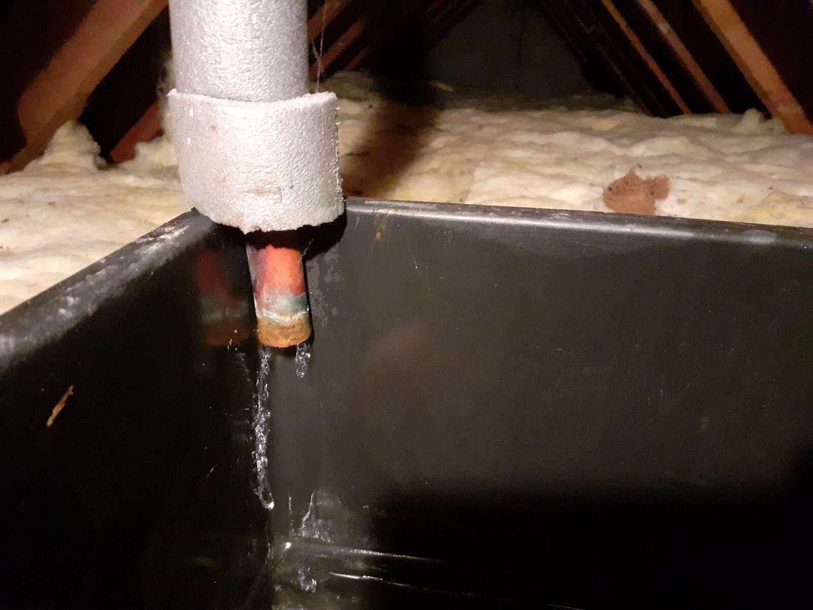

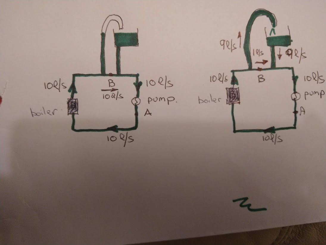

Yes it does, it is a feed and expansion cistern, the cistern takes up water expansion through the feed.

With the pump off the water level in the F&E cistern and vent pipe will be same, therefore having the same pressure. It doesn't matter how far apart they are.

Until the customer goes, oooo, what's this for, lets close it ....Keep the valve open, then it's an open vent system.

Excessive expansion (aka venting) goes in EXPANSION pipe (aka vent pipe).

Ok I can do that, how long can i safely leave the x400 in the system for? Thanks
