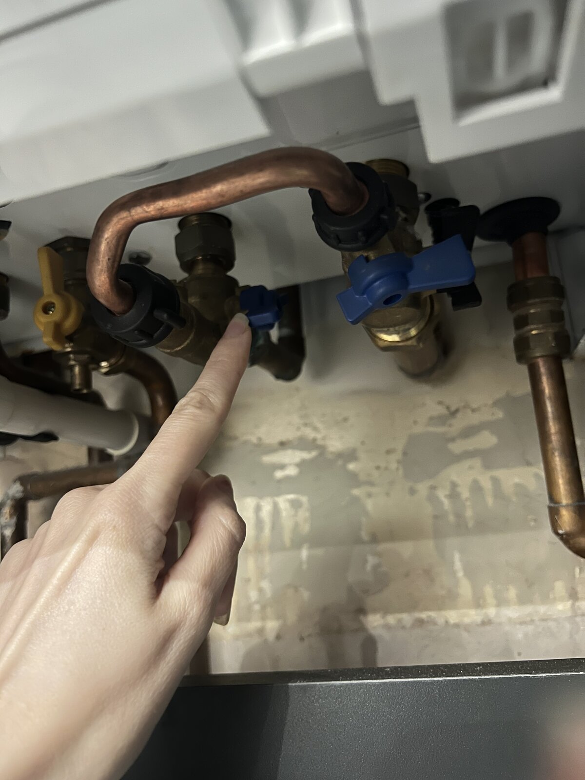

You won't have any pressure when its "falling" out of a bath tap spout but you can still have a very high flowrate. OK then, assuming its now shut off get someone to listen by the boiler and open the same tap very slowly until the boiler fires up and stays firing, then run into any known volume container and measure the time in seconds to do so.
I will test properly tomorrow…
But have just under the boiler opened up the flow rate … and the boiler just shuts down (not actually) but the hot water display on the front goes to 0 and will not go warm at all…
The valve you are pointing to is the cold mains into the boiler and should be fully open, the short piece of copper pipe connects into the CH return and is used for topping up the pressure in the boiler via the other isolating valve which is shut.
Can you post a photo of this "hot water display on the front goes to 0 and will not go warm at all…" also any other gauges on the boiler front.
Of course. Tomorrow I will send a video.
What I did was I ran the hot water (mixer tap) in the kitchen - had it running full.
Then I opened that blue value fully and the water flow was very high (from boiler I can see the kitchen tap)… that’s when the temperature on the front of the boiler went from like 55 to 0 instantly and as I continued running the hot water the display remained at 0 and the water remained cold until I started to close it down… I had to fiddle with it for a bit though as the boiler was hissing at some points so I kind of moved the value until that hissing went away and the boiler sounded happy…
I’m not sure though, that’s the only value the plumber told me about. So I do not touch any others!!!
OK, thanks, can have another look tomorrow but think you need someone who knows what they are doing, will have a look at the attached later.
