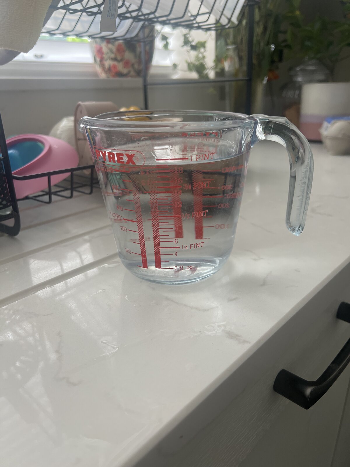

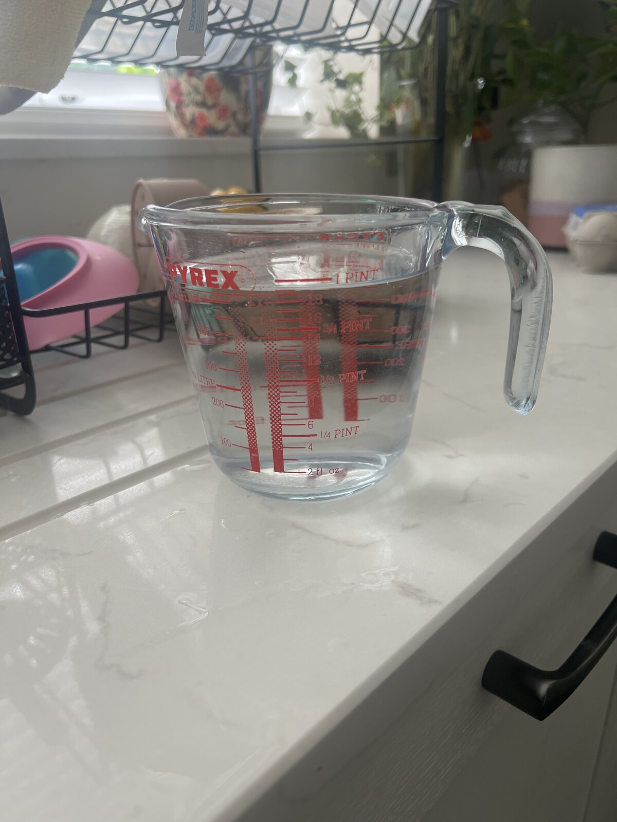

I have done another FLOW test
Kitchen HW tap (boiler 00) so water is cold.
4 seconds and 50 = 900ml
Bath HW tap (boiler really slow… 2 minutes only on 25 degrees but boiler has kicked in)
3 seconds 19 = 1 litre
