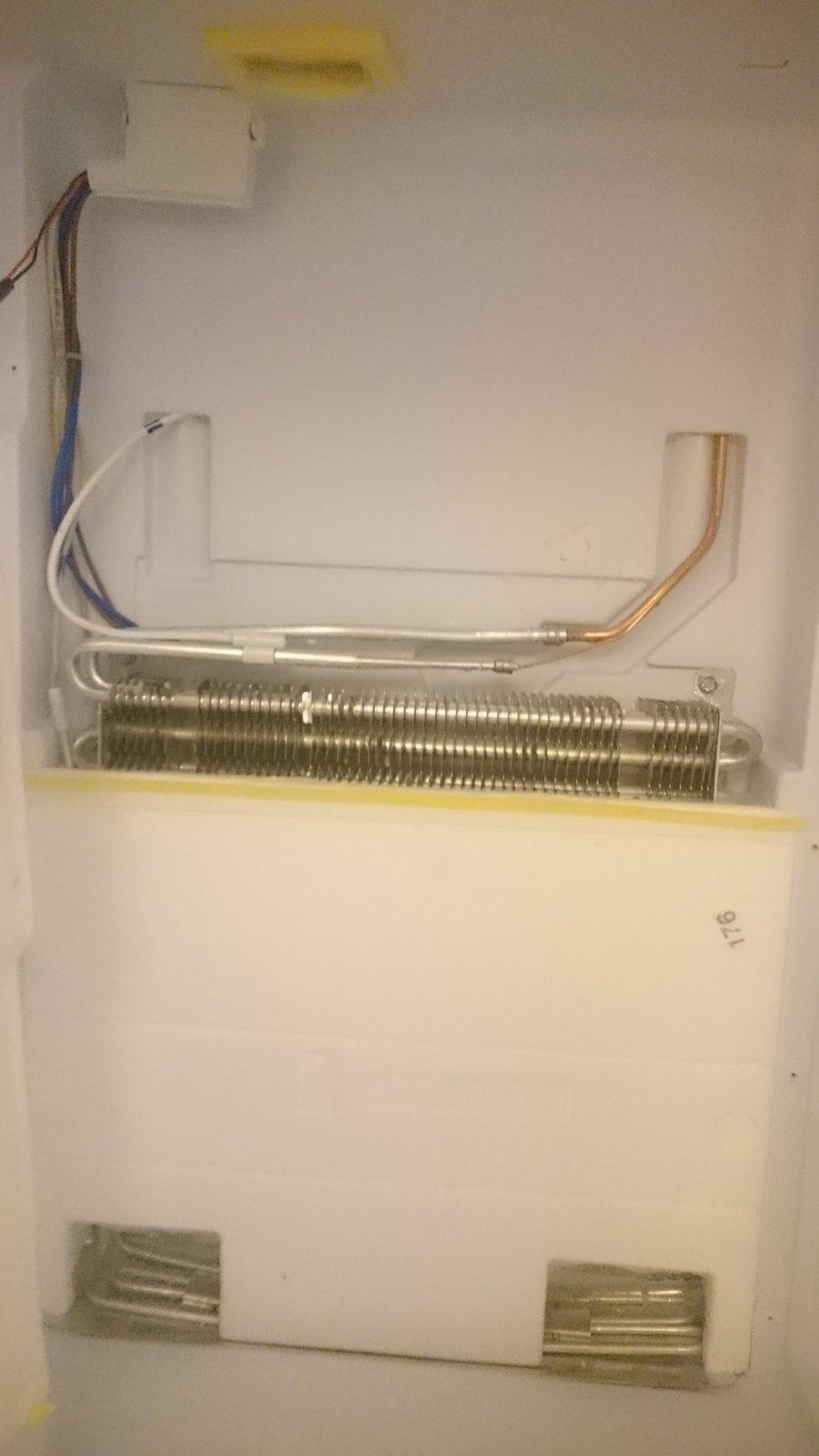

Need some help trying to resolve an issue with my 2-year old Hotpoint Fridge Freezer (FSFL 1810 G).
First noticed yesterday morning that the upper fridge compartment was not cooling when my milk was warm. Checked the lower freezer compartment and it was cold but not freezing.
So far I have switched off and unplugged for 2hrs during the day and then turn back on. Did not make a difference. And then last night I again switched off, unplugged and removed all the freezer drawers to check the coils. They were fully iced up (images attached) which I managed to clear. Switched it back on and left overnight. No difference this morning :(
Any advice would be much appreciated.
FG
you need to thaw out the internal build up off ice in the internal void
use bowls off warm to hot water inside to help melt the ice
may take several hours changing for warm water every hour or so
you should defrost at least once a year for efficent operation

pretty good as the external build up can only really happen as an extension off an internal build up off ice
That's reassuring, thanks.
I can't physically get to the block of ice as the white (foam?) is covering. Do I just leave the door open and leave bowls of hot water inside?

yes fully open and as i said just keep changing the water when it cools

thats why i prefer non frost free
as when the visible ice has gone the job is done
quilt on the floor
freezer baskets on the quilt
two quilts over the top
about 1 hour with many bowls off hot water
another hour of scraping and more hot water job done
the bottom shelve will tend to have a well off some sort so you can capture and remove the buildup off water rather than it damaging the kitchen floor

Just wanted to message to say thank you very much for your help!
I did as you advised and it worked....have been monitoring temperature over the past week and it is staying cool.
