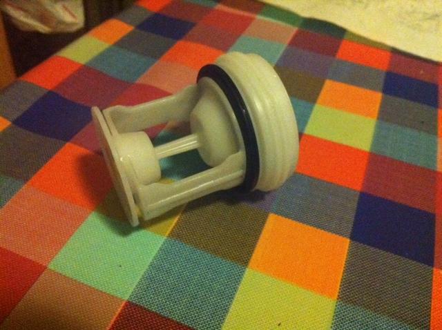

This is my filter. I've trimmed a small bit of the stick (stalk?) thats in the centre to see if that stops it sticking.
I do wonder if there something in the waste pipe or one of the others as the water comes out quite slow, more than a trickle, but I can remove the waste pipe from the drain whilst its pumping out no problem.
Right, filter is Ok. you have a blocked waste pipe it is poss block unclip it from the pump and flush it though with a hose pipe

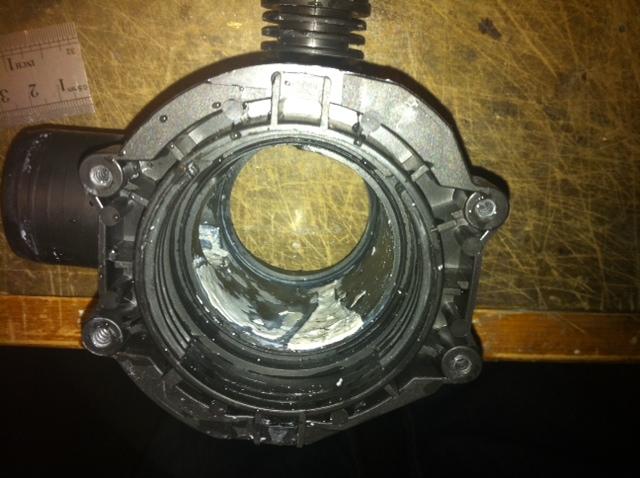

I've got the waste pipe and pump out. there wasn't any significant blockage in the wastepipe that I can tell, some buildup was flushed out.
The pump itself looks ok, I've cleaned it all up. There was a channel in the outer pump case that was completely bocked, seen in the lower part of the image, but I think this is just a channel to let water out the front when you release the filter.
I've not removed the pipe that goes from the sump to the pump. Can't feel anything in it, and when I pour water into the drum it draing straight out.

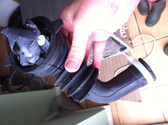

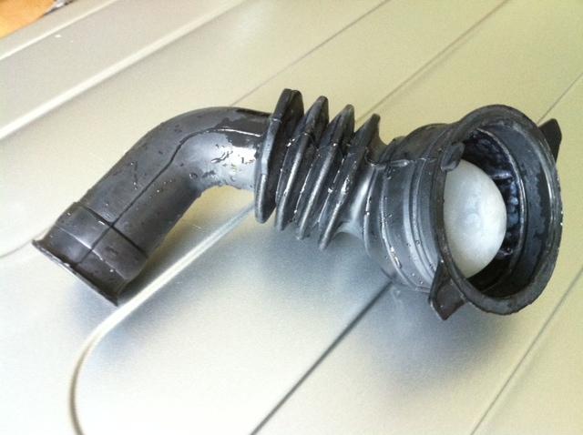

Rocks, thanks for your help you were right about a blockage, not in the waste pipe, but in the sump. Removed the sump pipe and found that these colour catcher sheets the missus had been using where blocking around the ball (which I assume should be there!). Have cleaned this all up and run through two washes without issue. The pump out also empties the water much quicker.
Before..
After..
