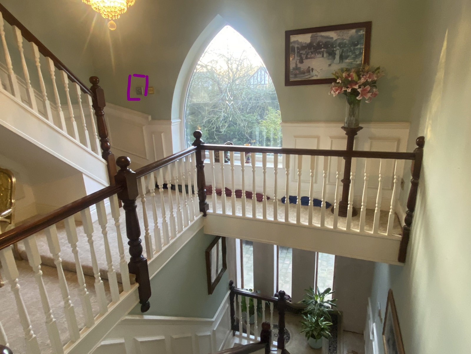

Hi all,
I'm trying to track down and fix a problem we've noticed this Winter where we're waking up to a really cold property, some mornings it's been as low as 7.5 degrees inside and we believe there's likely a bunch of issues contributing to it. We're dealing with fixing the loft insulation on a separate post(which has become quite a long thread)
Last night for example, we had the heating on for a couple hrs, went up from 12degrees or so, upto 17space, which is fine, but woke up again this morning to about 11ish, over the space of only 8hrs or so. I've atached the hive logs so you can see how quickly it's dropping too, this is not normal right? It was about -2 overnight outside but even still it seems like it's dropping super quick.
I've noticed the landing floor is always cold, so I lay down on it earlier today and I can feel a slight cold woft of air and have noticed some fabrics on the stairs moving round a bit as if being gently blown by wind, the wife think's its just convection of air but im wondering if its a draft on the landing somewhere. Pic below (thermostat in purple)
I guess a couple questions based on the above,
:- What's the best way of tracking down the source of drafts? I tried for 30mins this morning holding my hands to surfaces and slightly gaps in the landing skirting boards etc, but no joy.
:- where the ground floor vertical windows are on that photo is a recent small front extension, If any of that was letting air in, would I be feeling that on the landing floor higher up than it? or is it likely coming from a different source, such as the big landing window? or somewhere higher up?
:- fixing Poor insulation in the loft isn't going to fix the symptoms i've explained here right? im correct to assume this sounds like two seperate issues that both need addressing?

Are you living in a converted church with solid walls? And open to the roof so all warm air rises away from the living area?
Tell us more about the insulation and draughtproofing you have, the size and construction of the building, and how many kWh of heat you have been using per average day for the past freezing week.

That big window wont be helping nor will those windows downstairs. Curtains will help to keep the heat in, it may spoil the aesthetics but it will help to keep you warm and reduce bills.
Appreciate it won’t be helping re: the windows, though they’re not that old, landing window 2008 ish, verticals down stairs only fitted a few months ago.
Given how ’new’ they are, could they be the culprit for the drafts I’m feeling when I put my head down to the level of the landing floor carpet? I’m happy to consider replacing the landing arch window for thermal triple glazing and/or happy to add secondary glazing to both the landing and verticals downstairs if needed (verticals are already double glazed acoustic laminate)
