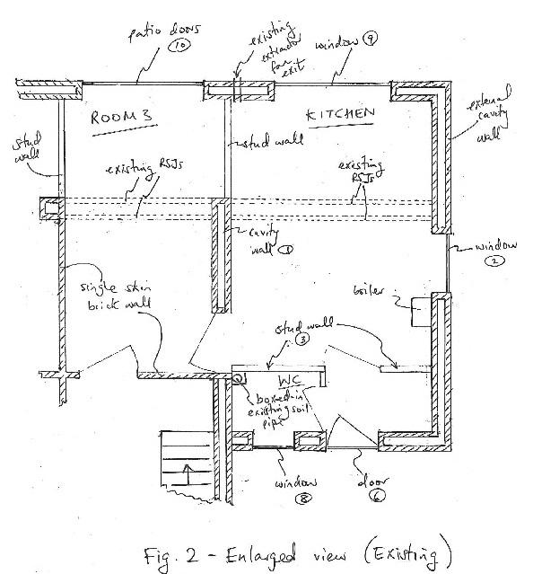

We have a 1930s semi-detached house in south Manchester, which was extended by the previous owners. There is a two storey extension to the side of the house and a single storey extension across the back. Here is a layout of the ground floor (the scale is probably not that accurate):
We would like to change the layout of the ground floor by knocking through to create a decent size kitchen diner. We would like to keep the downstairs toilet but would like access to this to be from the hall rather than the kitchen and we would like to add a shower.
Part of the wall we want to remove is load bearing (a section of the original cavity wall) it is also propping up a steel support from the previous extension out the back.
Here is a (reasonably to scale) sketch of the existing layout of the part we want to alter:

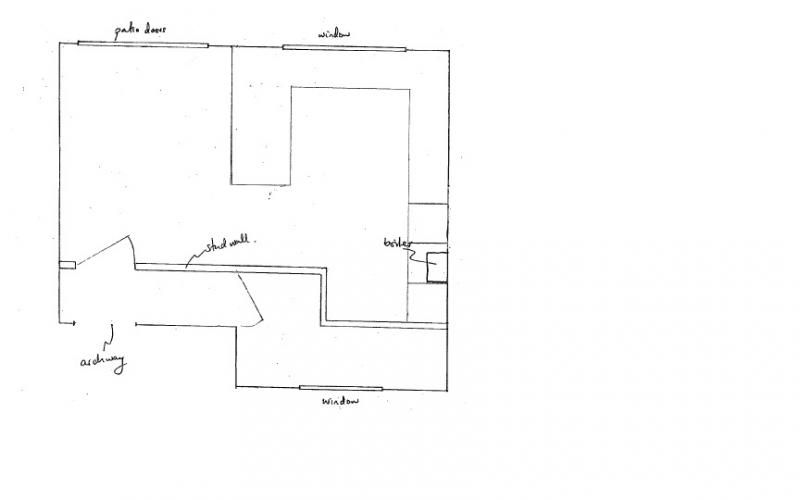

and a proposed new layout (the precise location of the new stud wall and the units/worktops are not quite decided yet):

3. With our constraints, I don’t see that there is a great deal of design freedom but can anyone see any obvious flaws in our proposed layout?

1. If i visualise your sketches correctly, you will be doing a "double knock-thro" ie. knocking thro where it was opened-up before.
You will therefore have a point load ( the original corner of the house ) approx. in the middle of your steel.
Both the above are well within the skill of experienced builders, but both offer more than the usual difficulties.
2. You will be losing quite a bit of floor space and creating an odd layout for a semi. Oddity does not sell so i'm told. Have you had say, an architec. tech./designer give you a view on what you propose?
3. Given the disturbance involved, can you, in one sentence, say what it is that you wish to achieve? Do you have some sort of multi-occupancy in mind?

It seems like the obvious solution. The horrid dogleg corridor will be a nightmare.
Simon.
1. You would be well advised to submit a drawing and take out bldg. regs. and calcs. BCO's are often a fund of similar, previous experiences, and excellent advice before and during the job.
2. Why cant, or wont, you go thro the understairs? Moving any utilities eg. CU is relatively strightforward.
3. the access lobby you create is the odd bit, and its an awful waste of space. Any estate agent will probably advise the same. Why not call one, they too have experience.
4. Do you have any experience of this kind of work, and what your structural proposal entails?
5. in brief, you really should get some, on the ground, design advice.
I now notice and note that simon, above, says the same thing about the lobby.

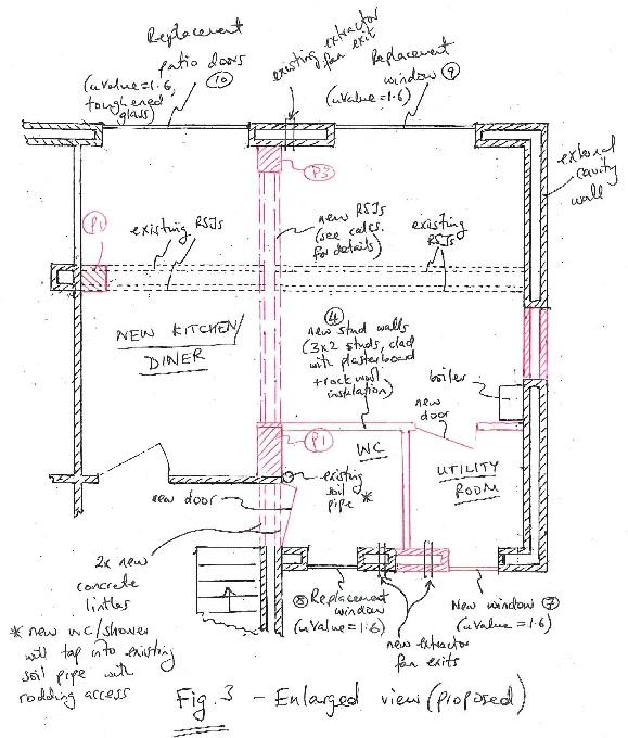

Following tim00 and simonjay's advice, we did end up going through under the stairs to access the WC. Here are the drawings that we submitted with our BC application:
Existing
Proposed
The work has started now and I'll try to add some photos soon.
