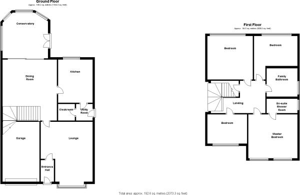

We have seen a house that we really like but there is one main thing that i dont like about the house, it does not have a hallway. I was wondering if there was any possible way of converting the garage some way to form a ? study/play room and hall. I dont know any builders, does anyone know of a web site u can send a floor layout to to see if there is any possibility of changing the layout? Thank you for reading this post.

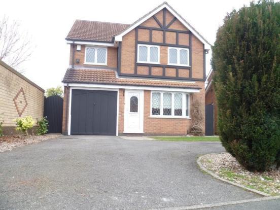

I think i have uploaded some photos. I do love the house just do not like the layout and not having a hall. i had thought about just putting a hall in from the door to the stairs but really makes the living room too small. Its quite an small odd shape as it is.
If I were you I'd download a free version of Google Sketchup and start sketching. It really is pretty simple and quick to use.
Looking at your pics etc I'm not sure there's a simple forum answer, really it needs drawing up to see what it looks like, the obvious solution as you've surmised is to convert part or all of the garage and get a hallway in there although maybe moving the front door, maybe adding a window to the left of a new front door (or not), possibly bricking up the existing front door or inserting a window or maybe widening the existing lounge window, the possibilities are endless but without seeing what they look like its pretty difficult to determine. I would say an attractive solution was probably available but it really needs drawing up to find it

You seem to have the added issue of not being able to move the doorway between the lounge and the dining room.
What about adding a side extension on to the living room to make it a bit wider and just continuing the hallway straight down to the dinning room.

With due respect to freddy - I think the hall could go straight from the existing bit to the door opposite - then the " lounge" becomes the dining room and vice versa :idea: and your lounge has the conservatory off it then . Just one point - will that layout/use mean the conny/living room is N. facing - maybe a drawback , one I have in my present bungalow , but I`ve got a 100 foot garden to look out on as compensation - do use the heating a bit longer in the year though.
But it you do that Nige you just get a long dingy corridor with no light. I’ve had a quick play around, I’ve made a number of assumptions:

Light is your issue therefore I have tried to use the windows that exist. I think you would be better off using the dining room as a lounge and have labeled the plan accordingly. I’ve put the door where the garage door is because there is already structural support there so no extra work required. So basically you are providing a new front door with sidelight (possibly re use the existing) a couple of stud walls, a couple of cupboard doors, 1 new internal door to office (or reuse kitchen door if you put in an archway as I suggest). I’ve suggested an archway at the end of the hallway to keep it as open (and light) as possible. I’ve also suggested opening up the entrance from your existing dining room to the kitchen to give the illusion of more space. You will need to brick up the old front door and some of the garage opening. Obviously if you were able to you would probably put a window in the office.
All measurements are guestimates but you should be able to relate them to the reality. Hope it helps

Of course the possibilities are endless but as I stated in my reply I have assumed that the original poster does not have infinite amounts of money to throw at the job therefore I went for the simplest design to achieve what they said they wanted - no alteration to drainage, minimal structural work, mimimal disruption to habitation - it's a floor plan to show what's possible why does it need an elevation? Just imagine a door and side light in place of the right side of the garage door and bricks where the front door is at the moment - surely that's not so hard?
