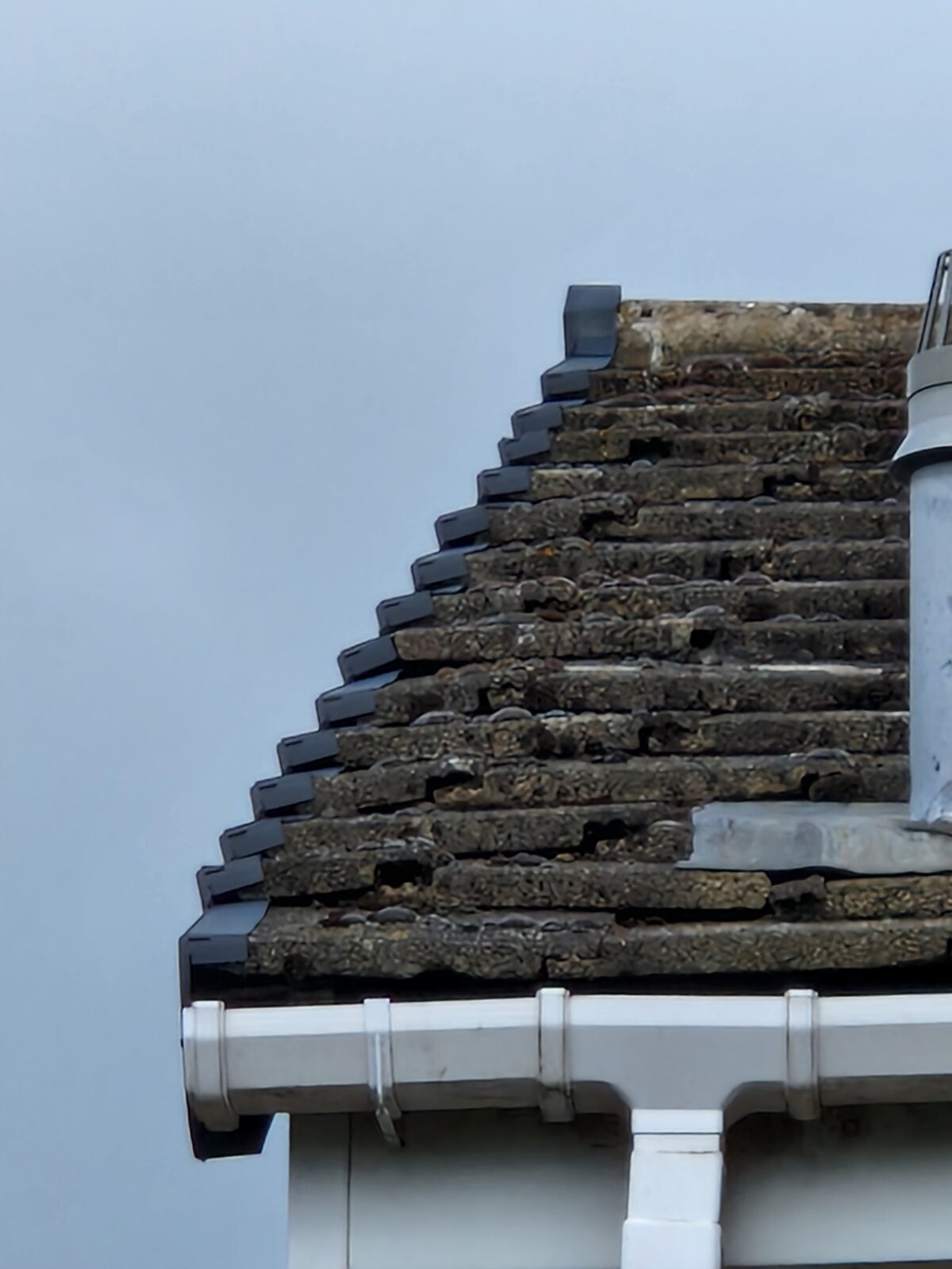

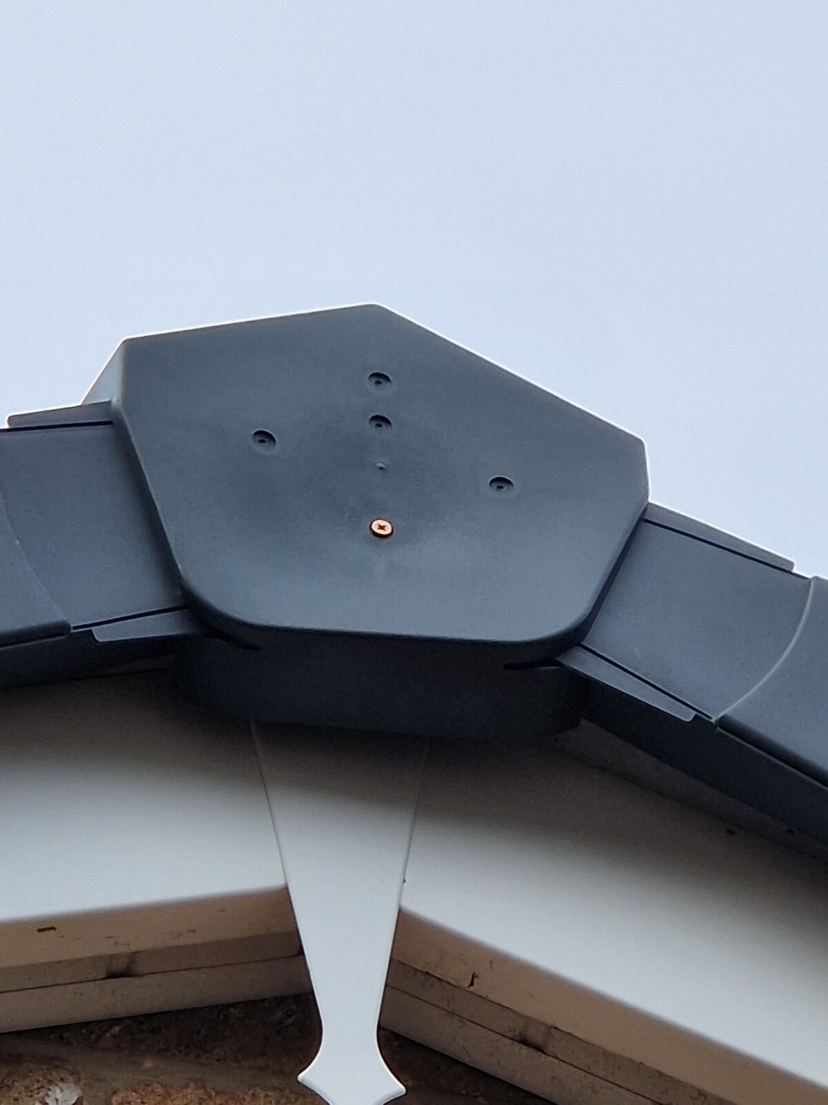

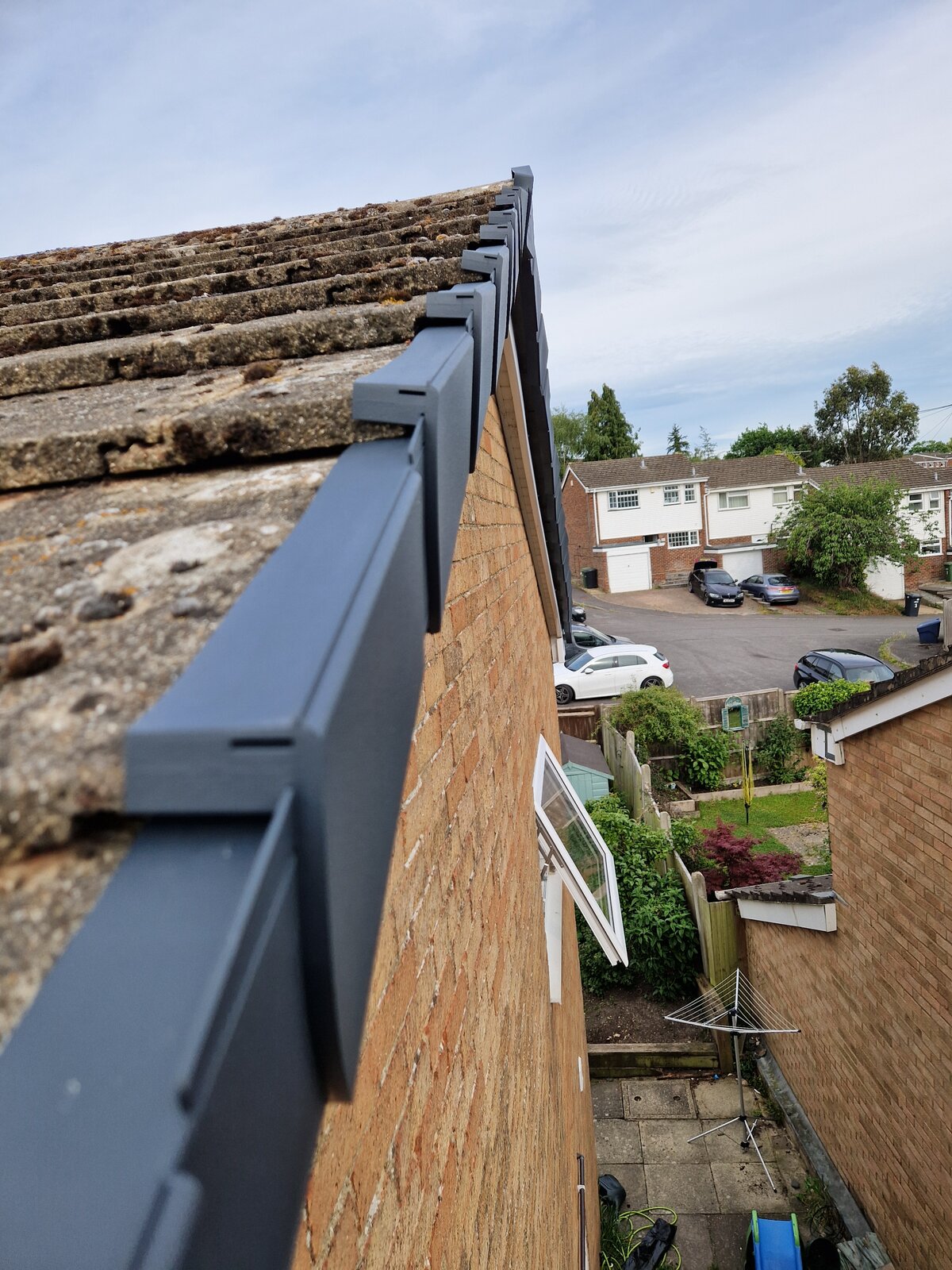

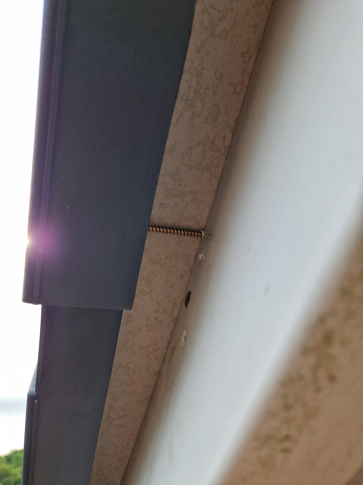

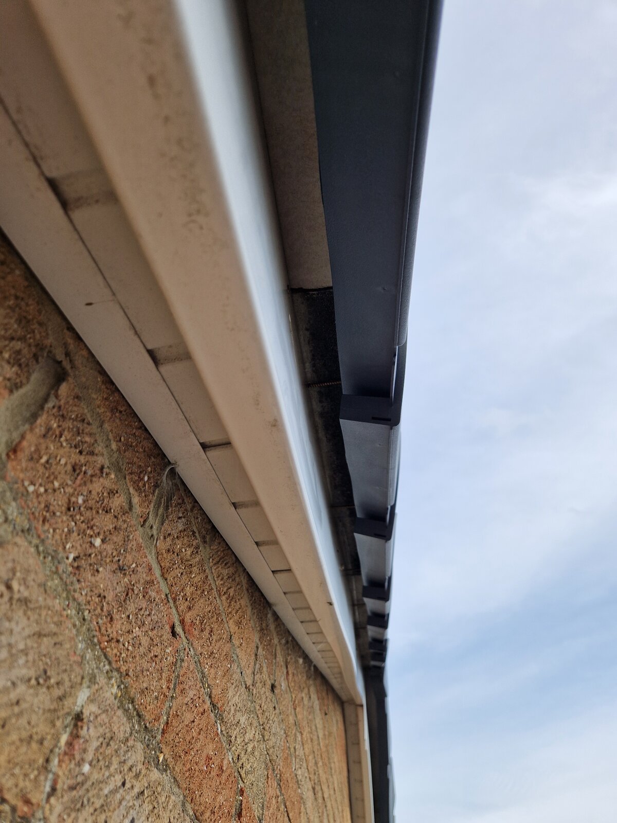

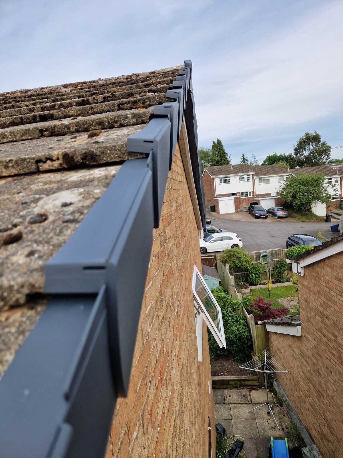

I'm pretty sure I've well and truly had my pants down here. I have paid £1800 for this monstrosity.
I wasn't really sure how bad it was until I started doing research into it after he left.
Pic 1 looks like it's lifting tiles as he has screwed directly into the verge and not into the battons (this can clearly be seen in pic 3), which is pulling the tiles up. There is also more of a draught in the loft than there was before .
The tiles have obviously not been cut back either hence why the verge is bowing so much and doesn't fit over nicely.
The gap between the house and the verge looks massive compared to any other house I have seen with this system.
Is there anything else I'm missing?
I have the roofer returning in 2 days.
I've never felt so ripped off in all my life and feel like he has now taken away the water tight integrity from my roof.

Seems a bit of a dogs dinner ; did he not advise taking the tiles back or building out the barge board? Or even replacing the wet verge?

It looks like he's fitted the dry verge units with the tiles still in place. This means that he hasn't extended the tile batten. He's also used regular screws and not stainless.
There's lots wrong with it. Poor quality, not much attention to detail etc. They should be firm and straight with the bottom lip tight up to the fascia or brickwork...

Needs a tower scaffold, the tiles stripped back to the 2nd rafter and new battens extending 40mm beyond the barge...obviously the existing wet verge removed and the tiles cut back to suit. Did they do that off a ladder?
