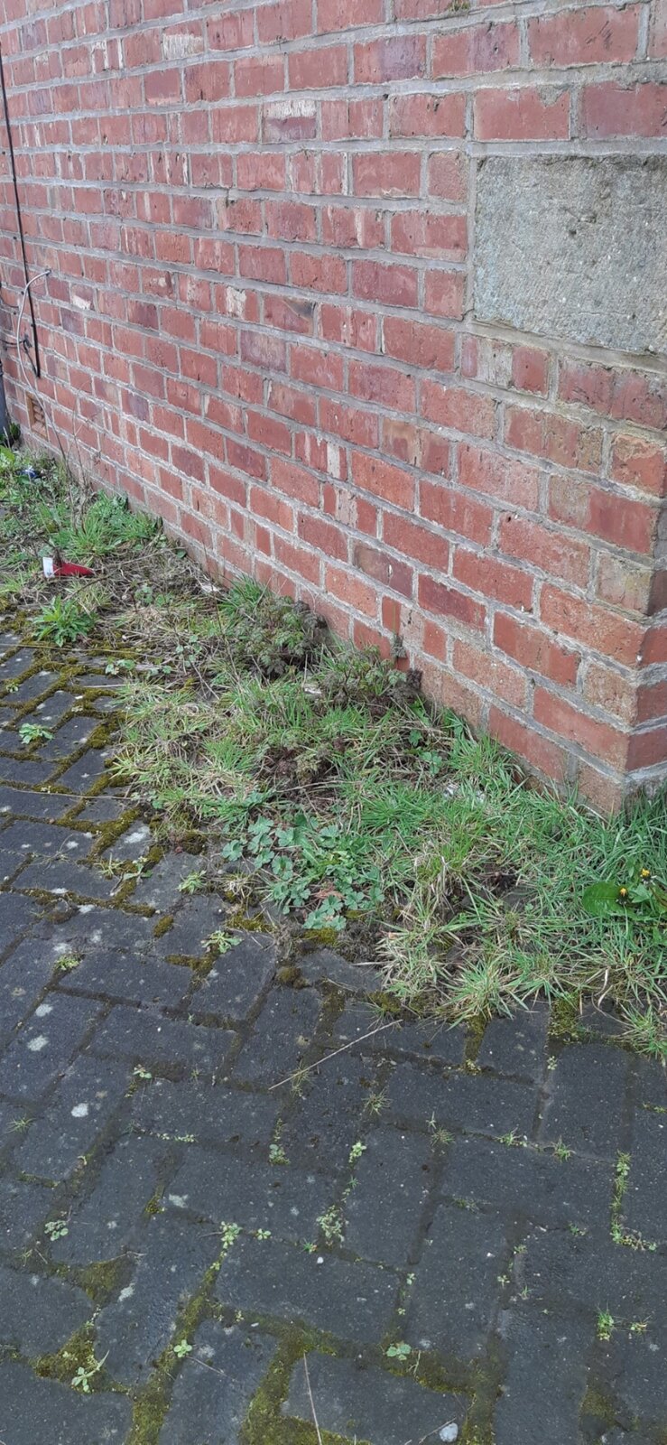

Find where the water is coming from, and repair the source. It is often a leaking drain or pipe, sometimes a spilling gutter, sometimes earth or paving heaped up against the wall over the DPC or holding puddles or rainwater against the wall.

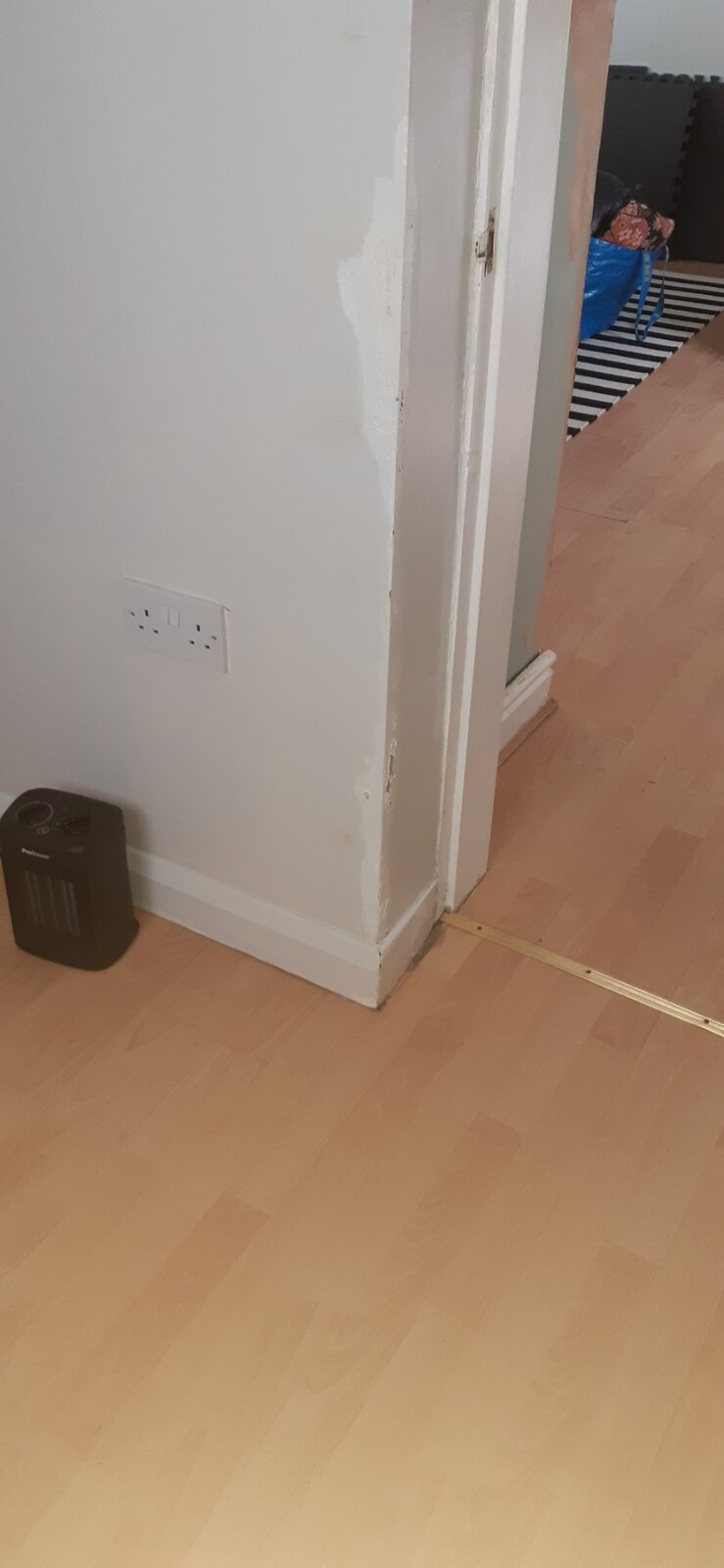

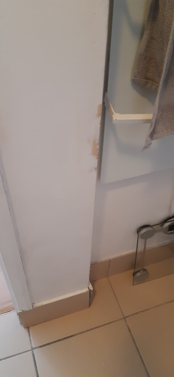

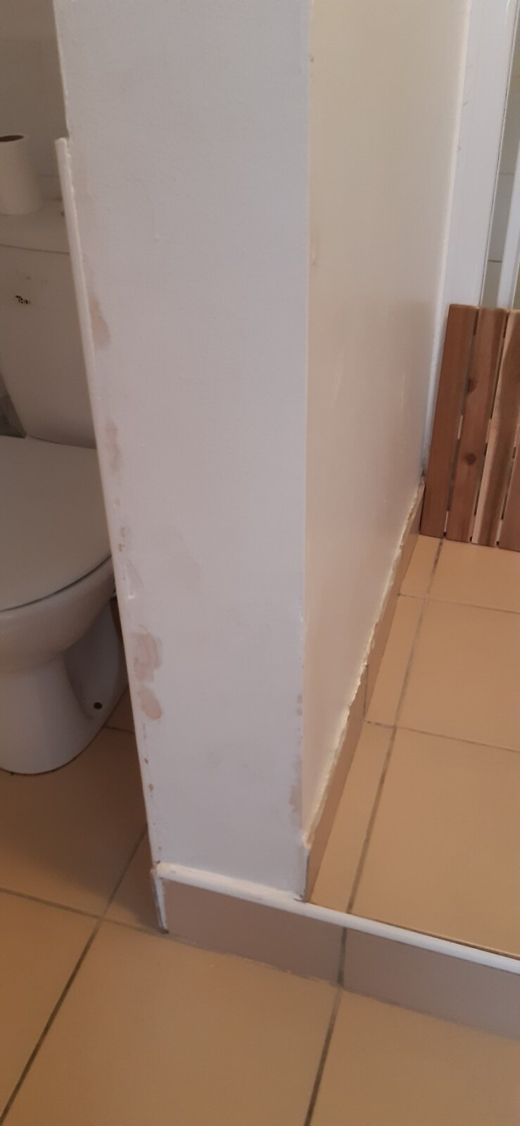

Thanks for your help, it seems to be all the external beaded corners going up to around 2/3 feet from the floor.
It's on the internal walls also.
Is there any way to tell if its just condensation or something more serious?
Also I have a bit of mapei shower tanking membrane spare, maybe if I paint over the corners with that it will seal in the rust?

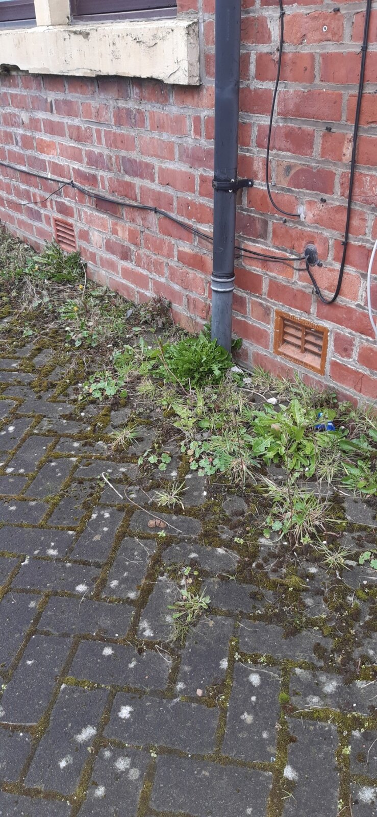

Show us your wider photos inside and out
Draw a ground plan of the house
Mark the damp patches
Show the position of drains, downpipes, sinks, taps, and the stopcocks that give clues of buried waterpipes.

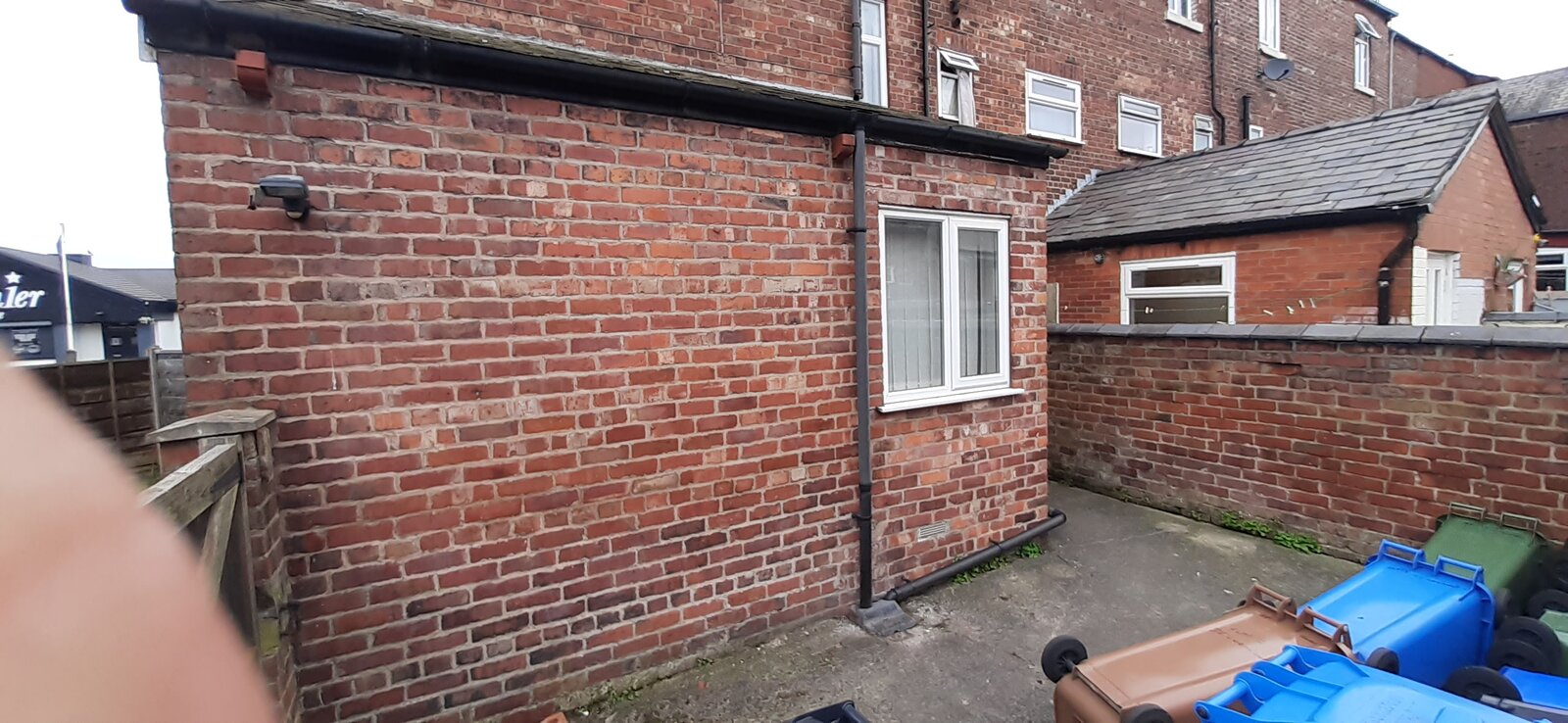

Thanks, it's mainly wooden floor, with a concrete floor to the back room.
There are no air bricks under the concrete part.

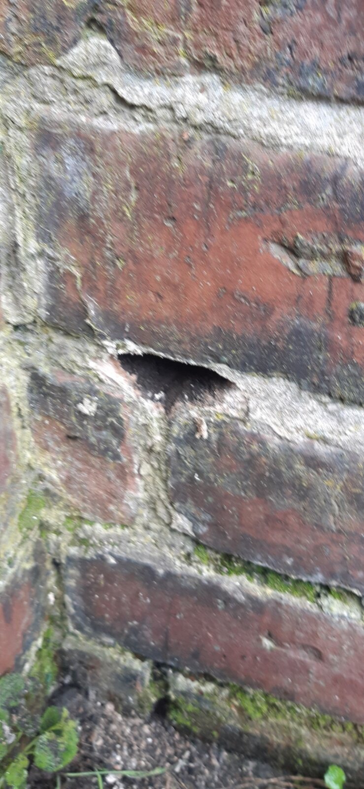

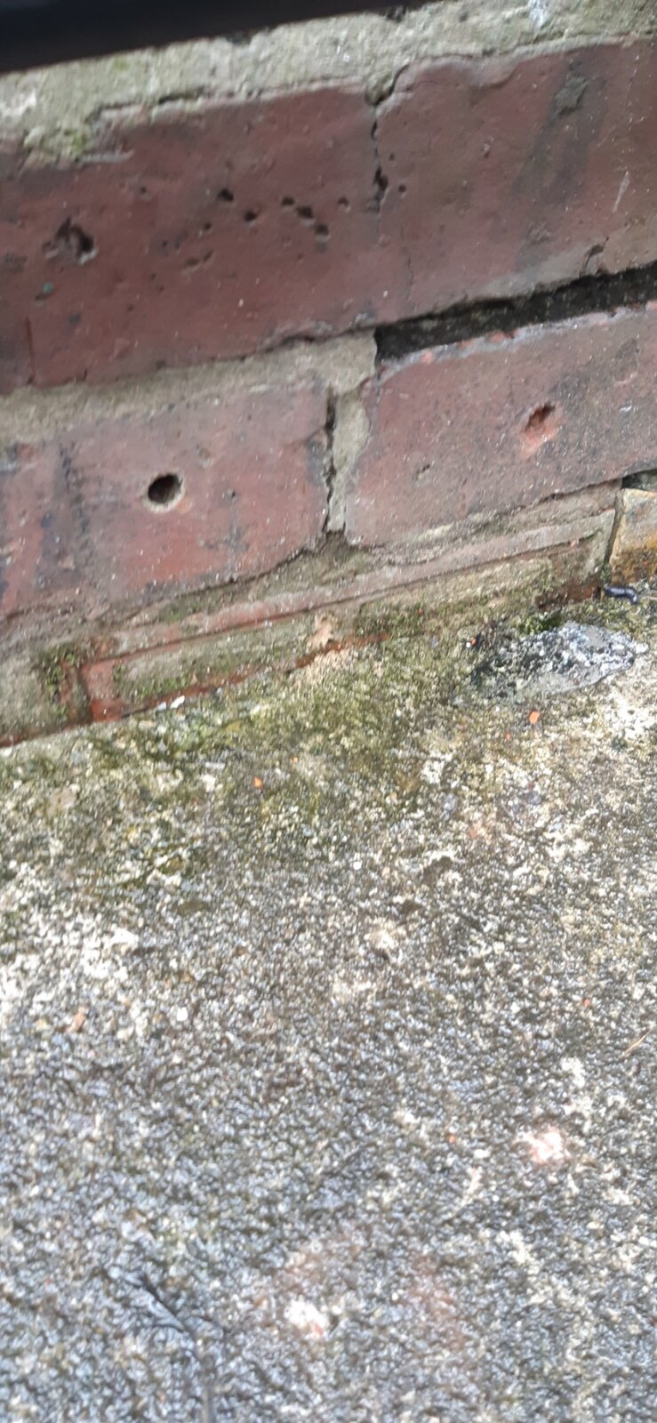

There is half a buried air brick, a small section also has chemical injection type holes.
I can see part of a dpc on a newer section, but cannot see a dpc anywhere on the rest of the house.

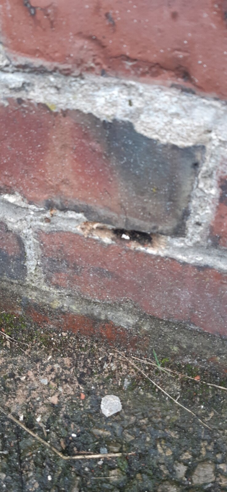

If I dig into the surface mortar I get soft black mortar.
The house is around 1900

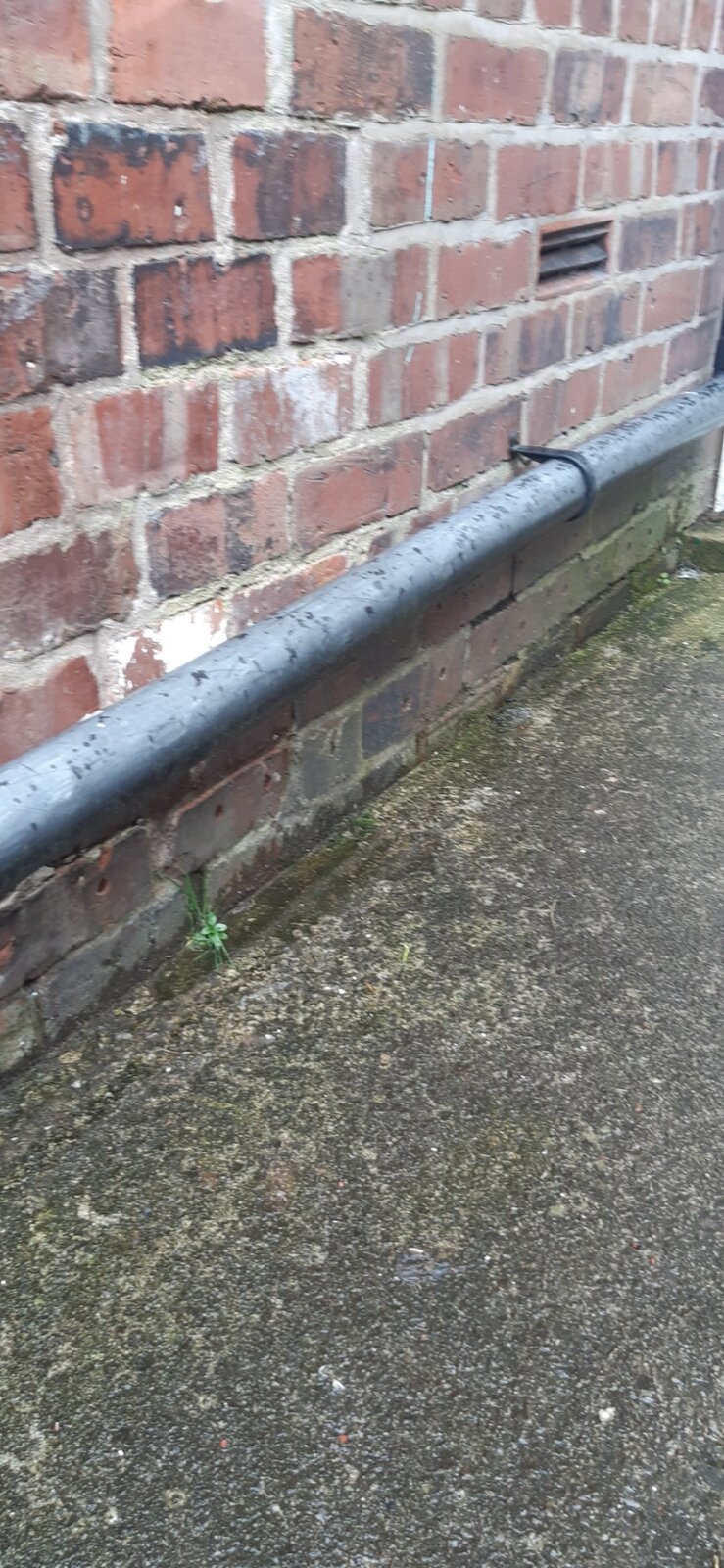

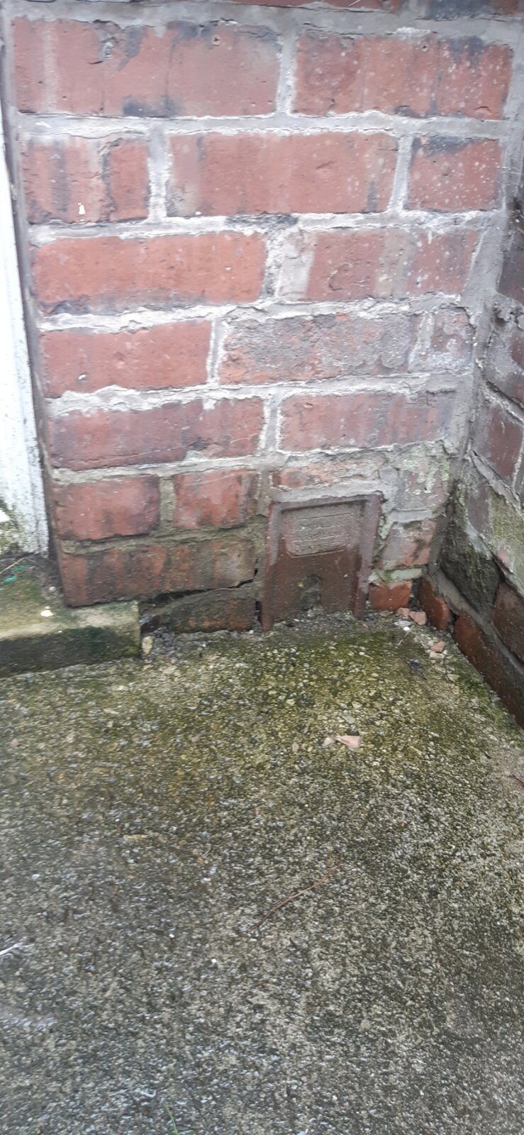

It looks like there is a source of water along that wet wall by the drain pipe
And it looks like the concrete against the wall is too high and bridging the DPC. The DPC was probably below that doorstep.
Please take some wider pics showing the entire wall, all the way up to the gutter and downpipes, and all the way down to the ground and paving. Show all pipes, drains, gullies and manholes.
Also draw that ground plan.
The soft black stuff between the bricks might be mud. Hose it out.
