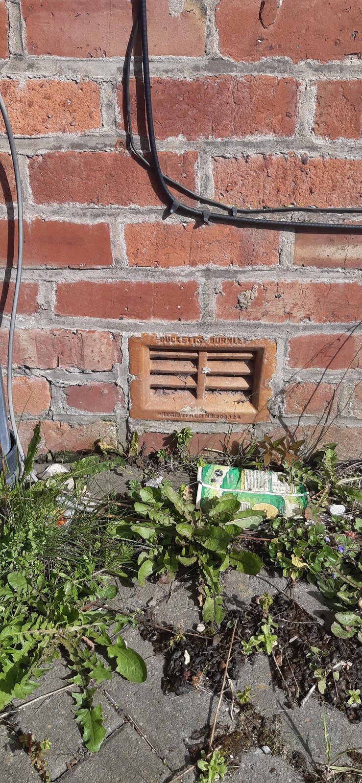

Hi John, any idea what I can do regarding no visible DPC around most of the house please?
It has been re pointed.
I have checked the water meter and the bubble isn't moving.
I'd be surprised if there wasn't one. The brickwork and iron waste pipes suggest it is not too old. Have a look under and beside the doorstep.
Typically it would be immediately below, or above, the original airbricks. It may have been pointed over. Have a look at similar neighbouring houses for clues.
I still suspect the source of water is drains leakage, if your water meter shows no sign of a pipe leak.
The ground hear thar airbrick looks wet, and there is some kind of drain beside it. Can you lift some pavers and look for wet ground?
