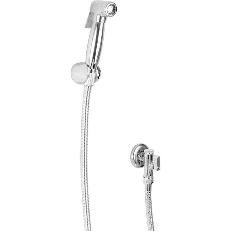

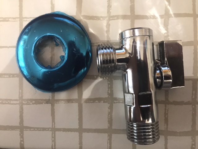

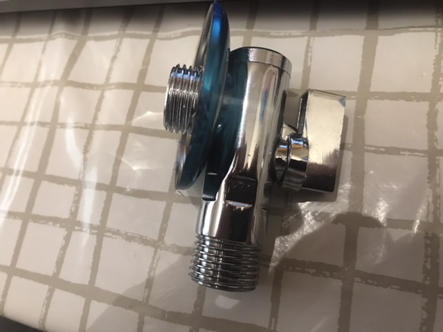

Hello, I’ve bought this sprayer from TS (as an answer to the shortage of toilet paper)
See pictures
I intend to attach it to the side of a sink cabinet by drilling a hole in it
The connection is 1/2” but I need to connect it to something robust inside the cabinet
Is there a specific bracket I can use?
What is this designed to be attached to?

Makes no difference, unless the water heater is tank fed. If it's fed directly from the mains then it's not permitted to connect that sprayer to the pipework. It must be fed from a loft tank supply, preferably on its own dedicated pipe
It is designed to be attached to a pipe in the wall. Even then though, that pipe isn't allowed to be connected to the mains water supply.
In the event of a drop in the mains water pressure, which happens all the time when everyone in the street is using the cold mains, then contaminated water could be drawn back into your drinking water supply. Enjoy your orange squash. (y)
Negative pressure? :D
No, any change in pressure can cause movement in the water that's contained within the pipes. That or if the water is turned off or there's a local burst pipe.
That aside, any bacteria that is caught on the end of that douche will then quickly multiply and then has a direct path back into your mains water, bacteria doesn't sit still. Hence why they aren't allowed to be connected to the mains supply.
