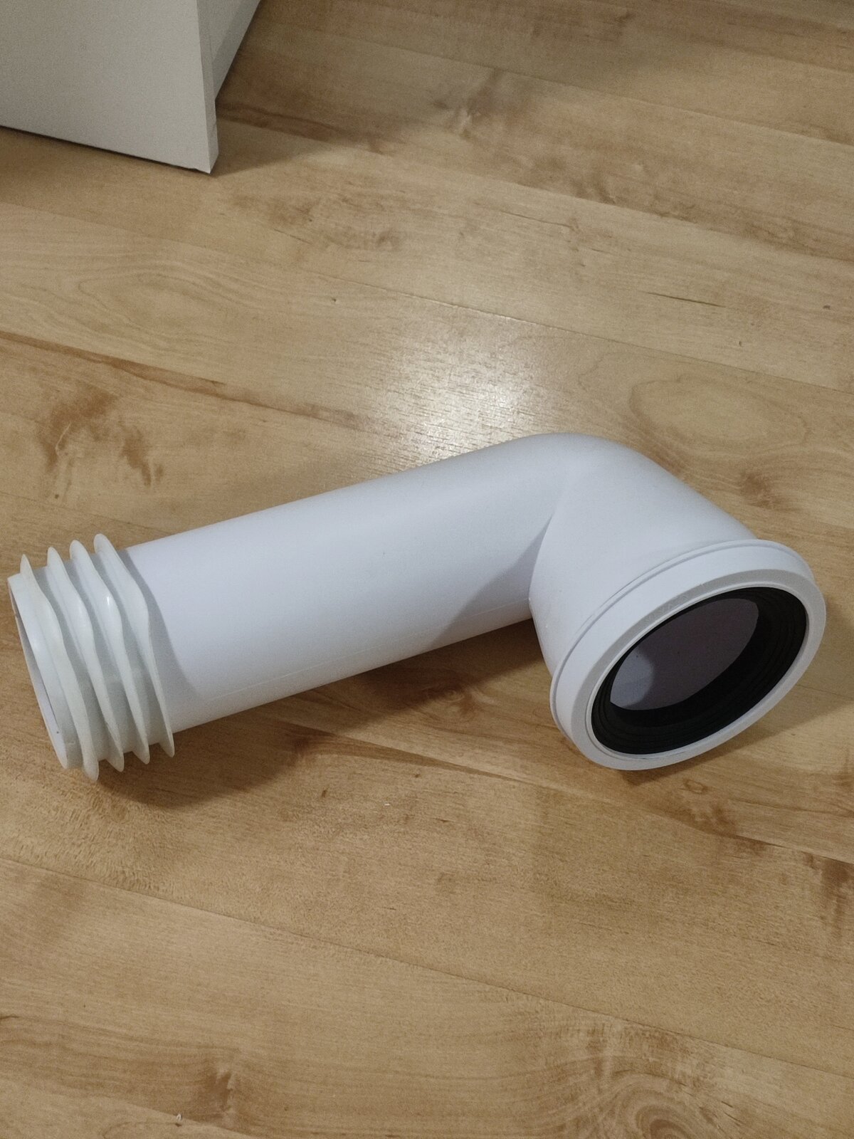

Bit of a disaster and sorry for the graphic imagery. Just installed a new toilet with a concealed cistern behind a cabinet unit that extends to the sink. I thought I had it all fitted then took a number 2 only to realise brown water came gushing out from behind the cabinet. I do a lot of DIY but never really toilets so have no idea what's wrong and what parts to get. Here's the setup:

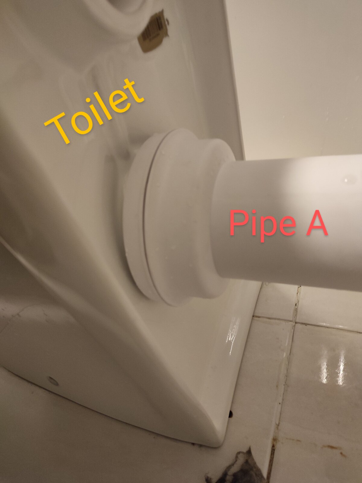

The toilet and pipe A are brand new.

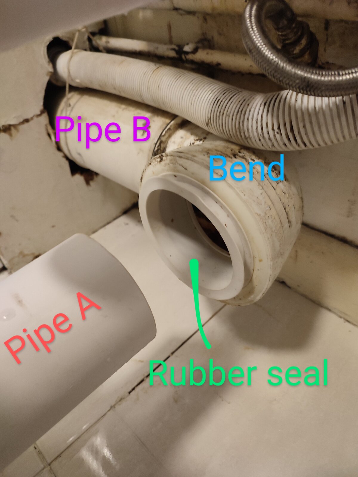

The water came gushing out around the rubber seal. When I took the cabinet off to see the pipes the seal was pushed in much further. I pulled the seal out a bit but it's still dripping. The seal is new and came with pipe A. The bend and pipe B are probably decades old. Pipe B goes to the soil stack for all the flats.

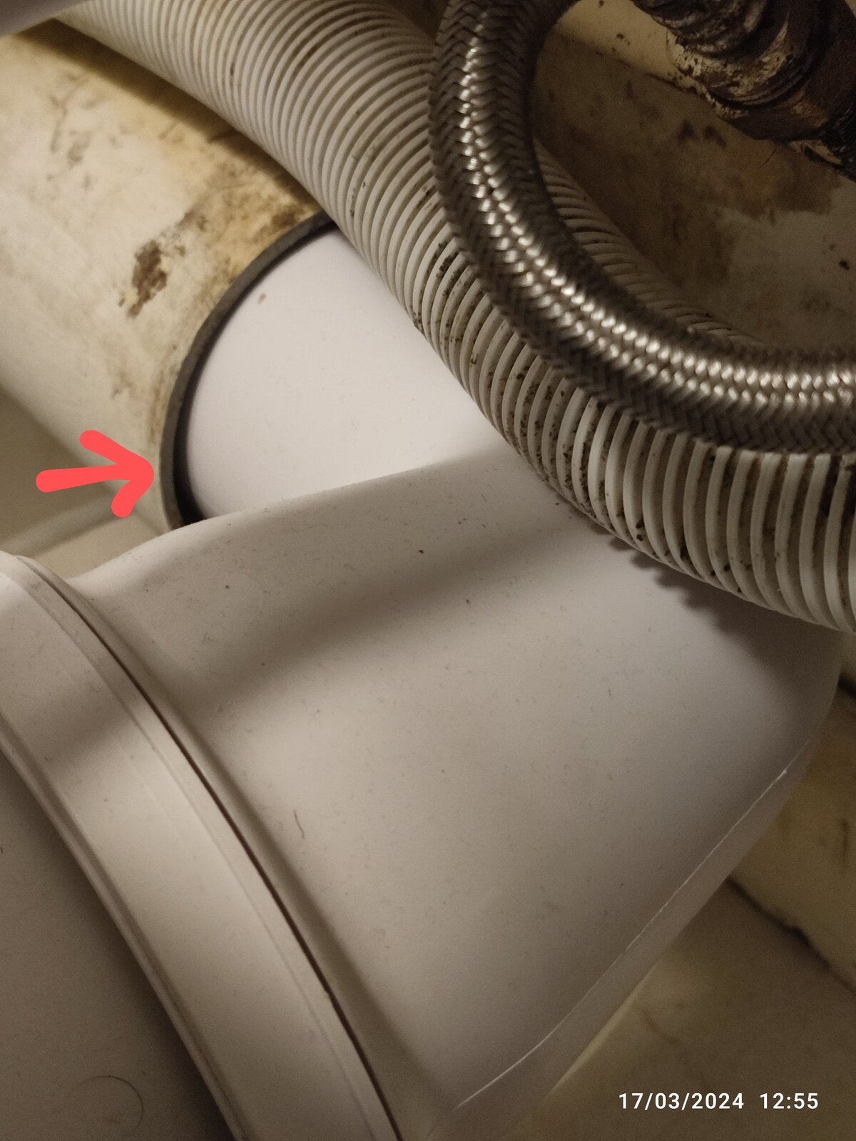

Even with the seal making the best connection it still drips, but thankfully doesn't gush out.

I also have this lying around. If I cut the left side shorter and fit it into pipe B and the other end straight on to the toilet, would that be the correct way?

When using a multikwik/pan connector to another, you’re supposed to use a small piece of soil pipe or extension piece trimmed down to help with the seal. My advice from my plumbing days is to flush a few times before use, rather than find out the way you did.
I think your new fitting will be fine. Leave yourself enough pipe to get a good seal and make sure there's no scale or grit in the join. That old bend looks too sharp to me.

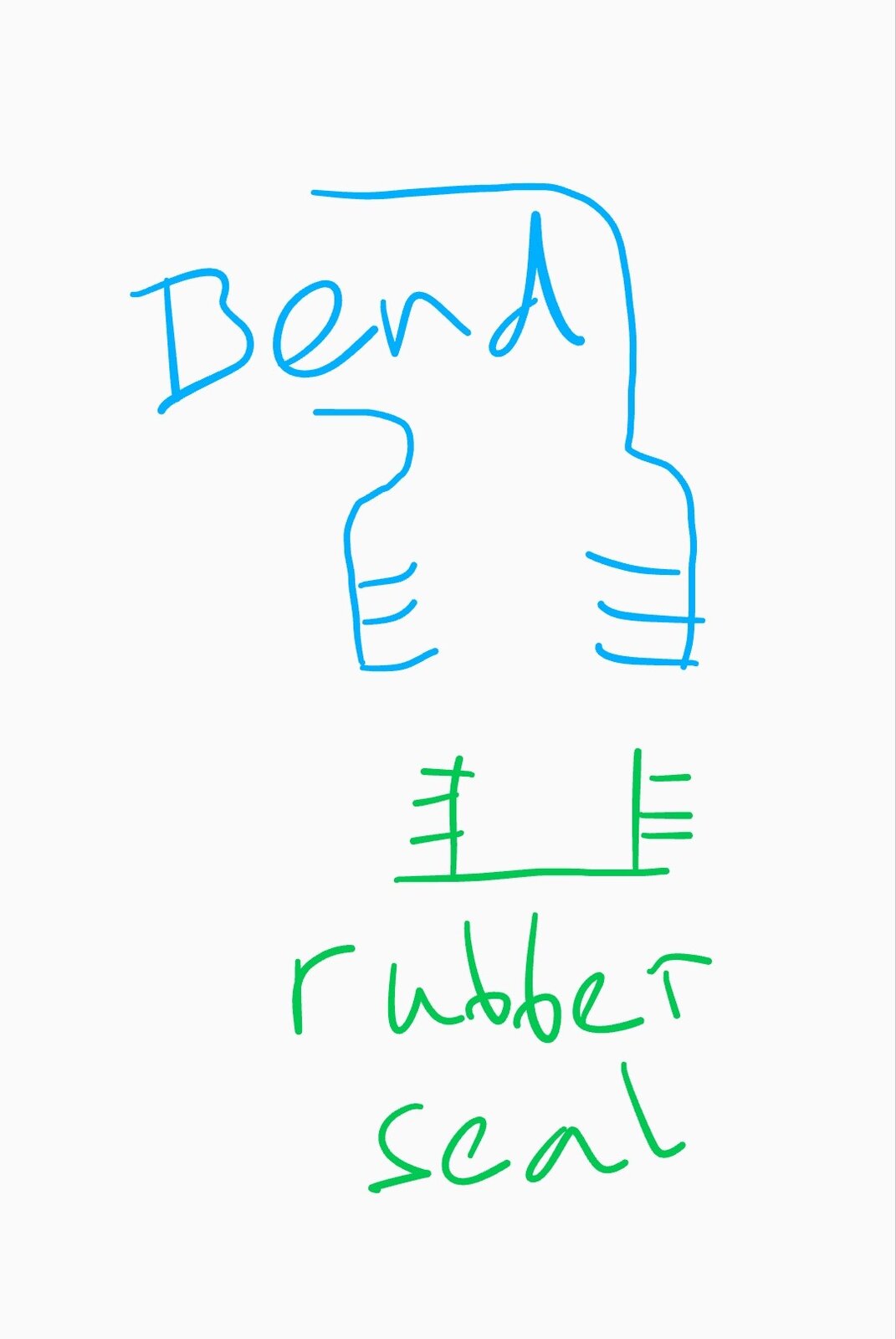

I might have to do that - I fitted the pan connector and it's dripping. So is it just a piece of brown 110mm soil pipe that goes between that pan connector and Pipe B as labelled in my diagram?

No, in between the rubber seal and pan connector
You have in your original pics a pan connector "A" fitting into another pan connector ( marked "Bend" in your pic). A right lash up with incompatible seals.

It's dripping ever so slightly out of the bottom of here:
That's the new 90deg fitting including the rubber seal as pictured above. I did make sure to clean inside the old pipe before fitting so the seal would get clean contact. It didn't feel that tight either.
Given that there are multiseals on that new pan connector it should be fine ,so maybe you have twisted them / mishapen them when inserting. Having said that it should be a tight fit. Are you sure the new pan connector is the correct size ? Some are smaller to fit into smaller waste pipes.
Give us the spec of the new pan connector
