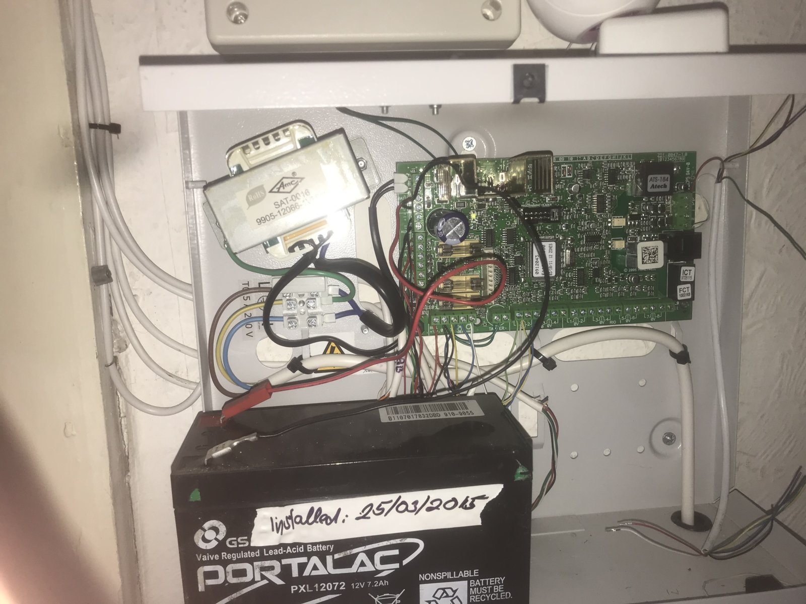

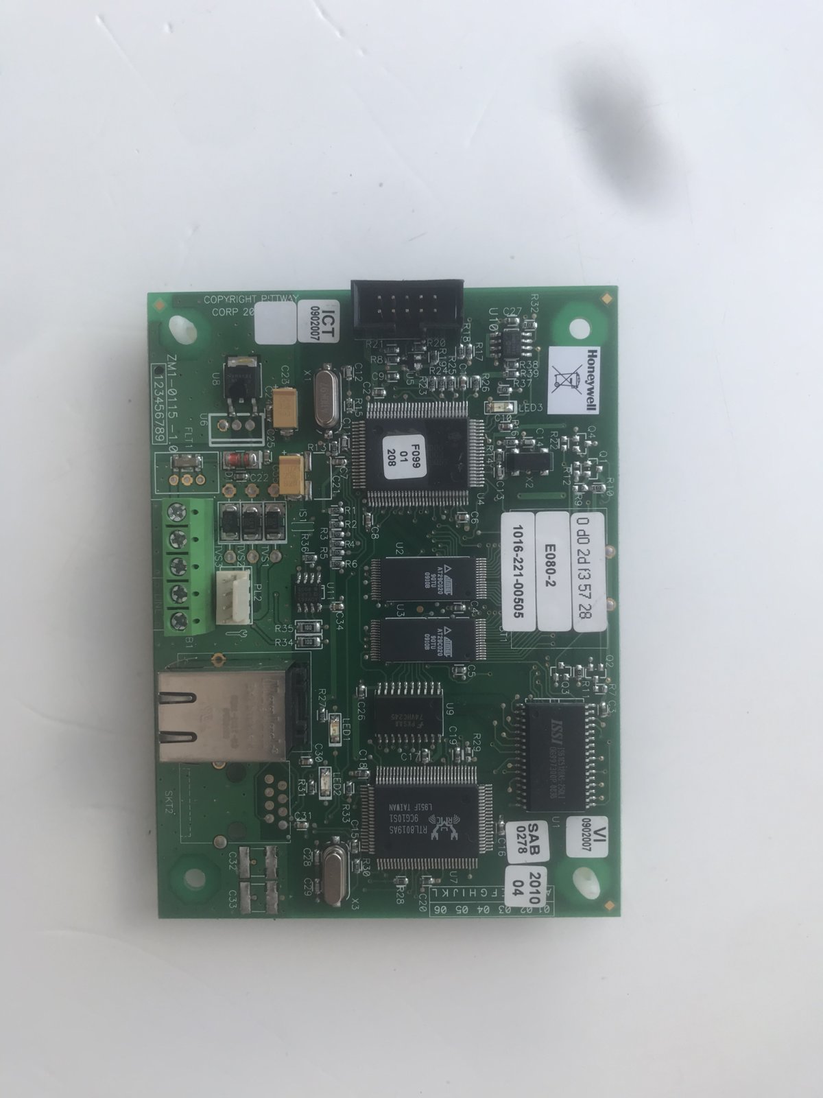

Alan, I am trying to fit an ethernet module on my panel, as you have already done this could you share the procedure with me please?
all help will be appreciated.
Hi, thanks for the reply.
The panel is a galaxy 2-12 C012
the module is E080-2
As per photos.
Cheers
Thank you, so if I just want to see the incident reports the module I have is adequate?
I have tried to connect it to the main board to no avail.
The IP address and relevant information is loaded via key panel. Does the module require 12v dc?
Cheers
