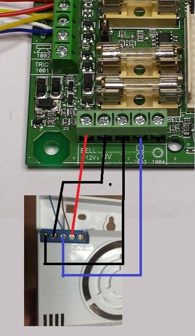

I'm have one that says bell 12v, and if I connect it to that then touch the other wire on the - the sounder goes off, even when the alarm is not set
I also have a letter T on the board, which I assume has something to do with the bell, because if I don't put the letter T to the - I get a bell tamper
So if I just use these too the T as my live and the - as the negative then I get nothing, even when the alarm goes off the sounder is silent
You need to connect the "GND" to the switched bells output. It is labelled with a symbol of a bell and has 1003 just below it...
I get a bell tamper, so can not exit out of engineer mode
The only way I don't get a bell tamper is if I attach the T to the -
Yes but you also need to make the other connections as I mentioned above in addition to the negative to Tamper link
sorry to sound thick, but i am not understanding what your saying then
if i connect the "GND" (blue wire) to the switched bells output 1003 where does my live go, i assume its the 12v Bell?
I then connect the T to the - ?
is that right?
If the internal sounder has a tamper you can add the switch to the circuit. If not, then just place a wire link between 0V and T.
pleased to say its working :)
