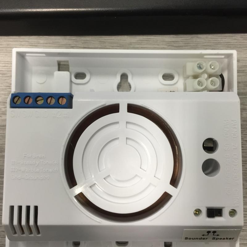

I also go this internal sounder as i am NOT having an external one, due to this being a shed alarm, i thought the internal would be loud enough
can someone also let me know where i wire this one in?

so now to wire up the box, can anyone answer my quesion about the sounder? a few posts back
It's hard to see from your picture of the sounder but it looks like you want to connect #2 to 12v on your panel and then GND to your bells output
Thanks, ok I did what you said but the sounder is going off
I connect the number 2 to the 12v bell on the panel, as soon as I touch the - with the other wire the sounder goes off even in engineer mode
i understand what your saying, but have no idea where i find that option, have you any idea where that option is on the menu?
i went to menu 53 outputs
1003 bell L with was POS
option 2 polarity
changed to 1 negative
made no difference!
