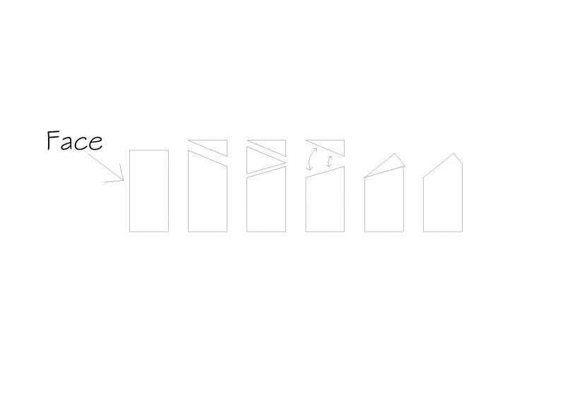

I've watched them cutting squints at my local Ibstock yard. They cut the angle out and stick the pieces back together with PVA. Dunk the join into the dust and it is almost invisible - unless you look really closely.
here's a sketch
You can get specials that are the same as the bricks you build it with, hard to find and very expensive, Squints at £2.50 and dog legs (for internals) £5.00 last time I did one.
Getting your bricks cut and stuck cost approx £5.00 a brick, you supply the bricks, get a few over for breakages..
I've done them myself with my cut off saw with a diamond blade, stuck with epoxy resin and dusted with the brick dust made as said before. It was very satisfying I must say and looked very good.
