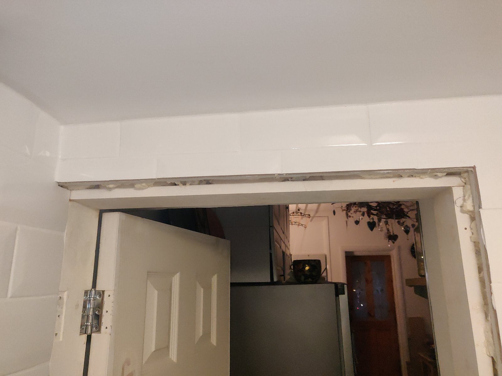

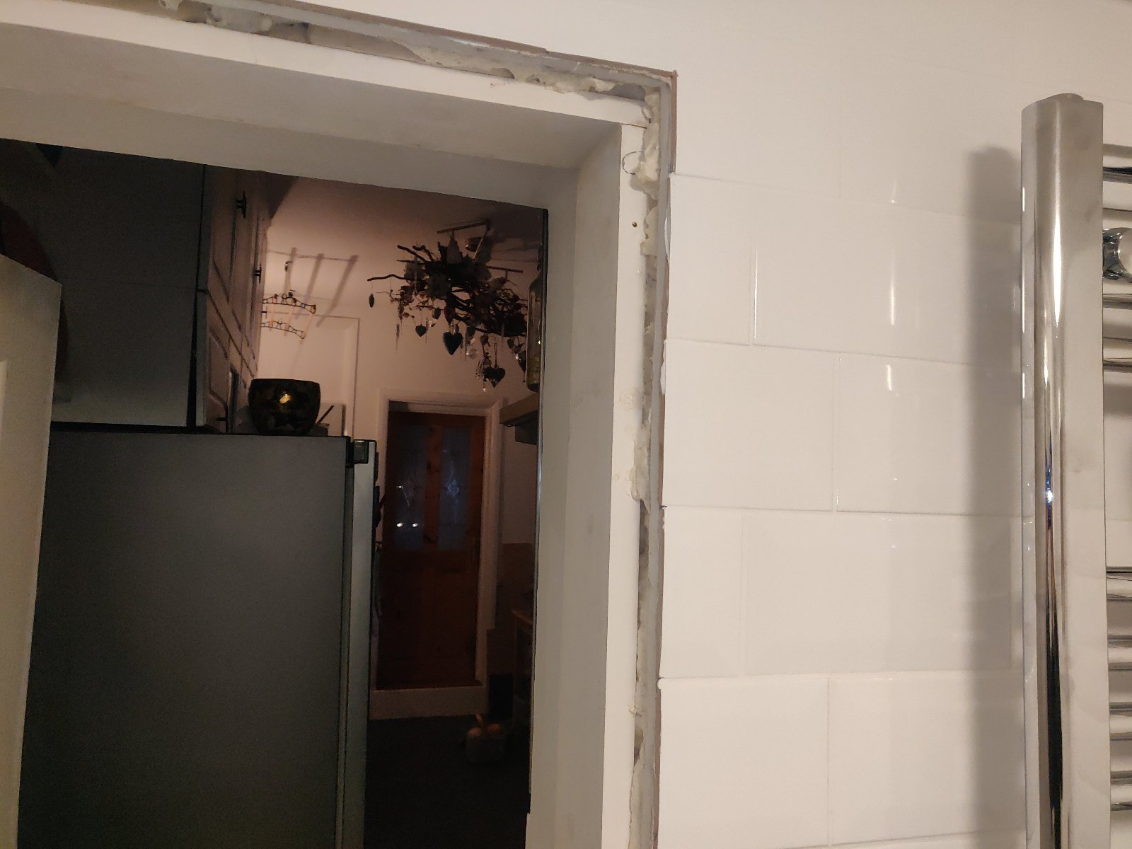

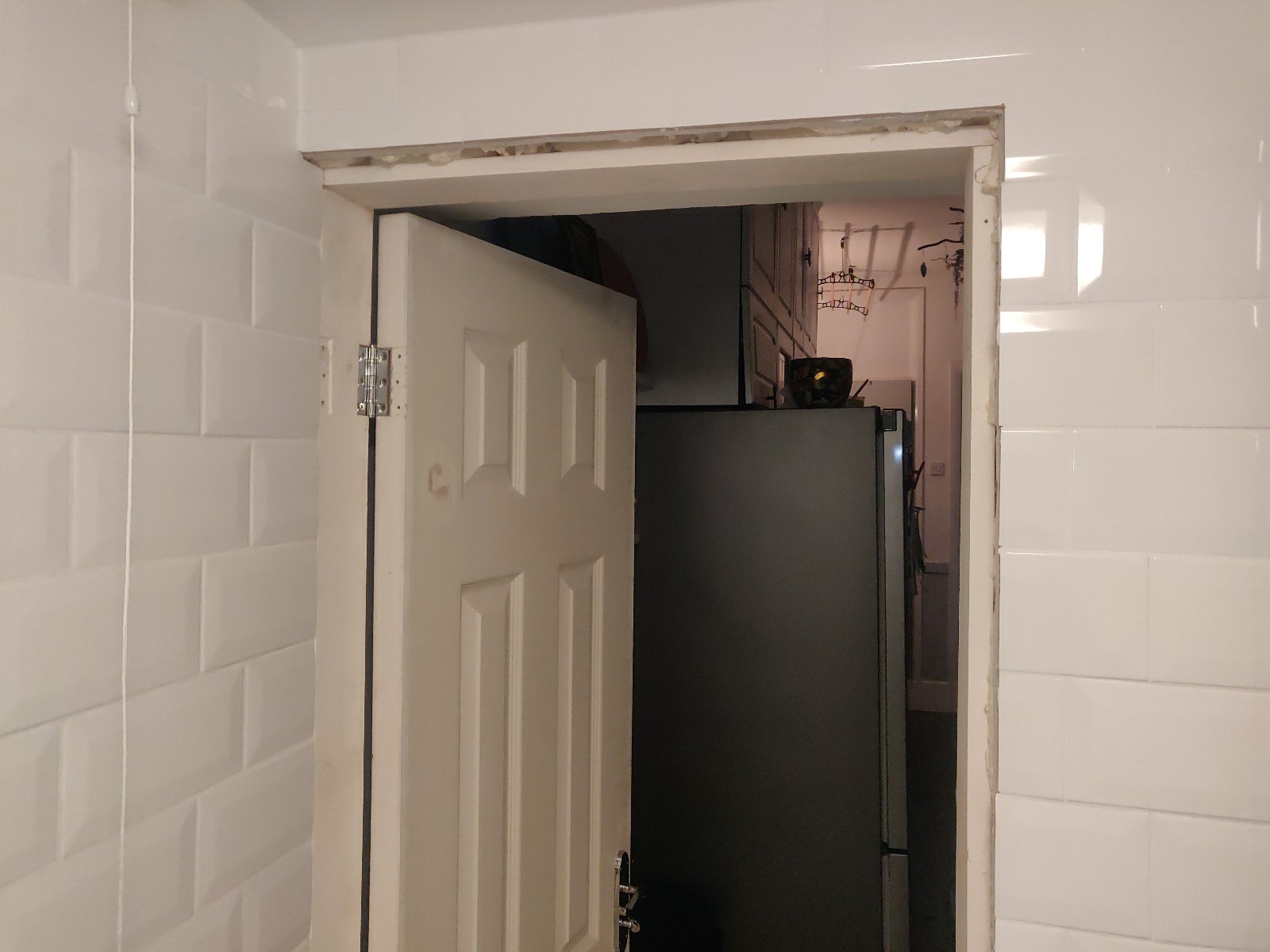

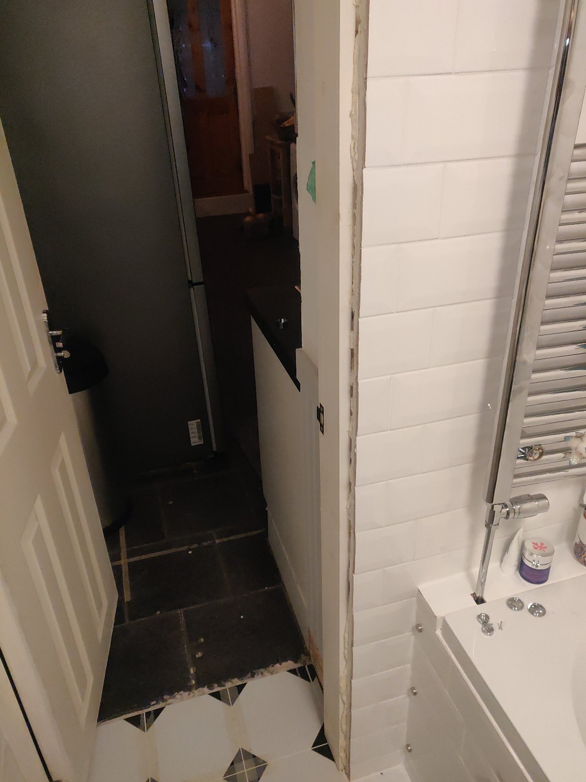

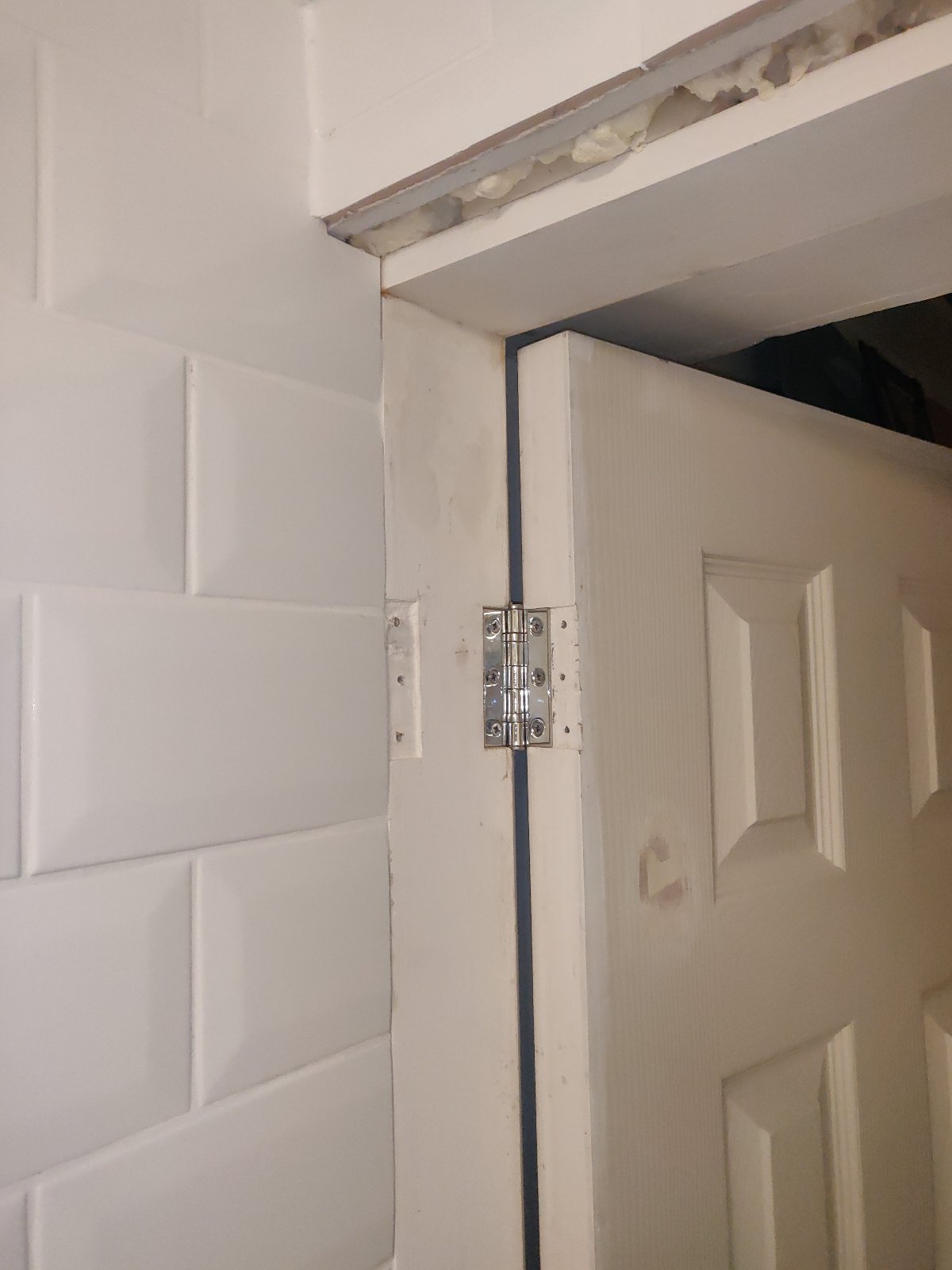

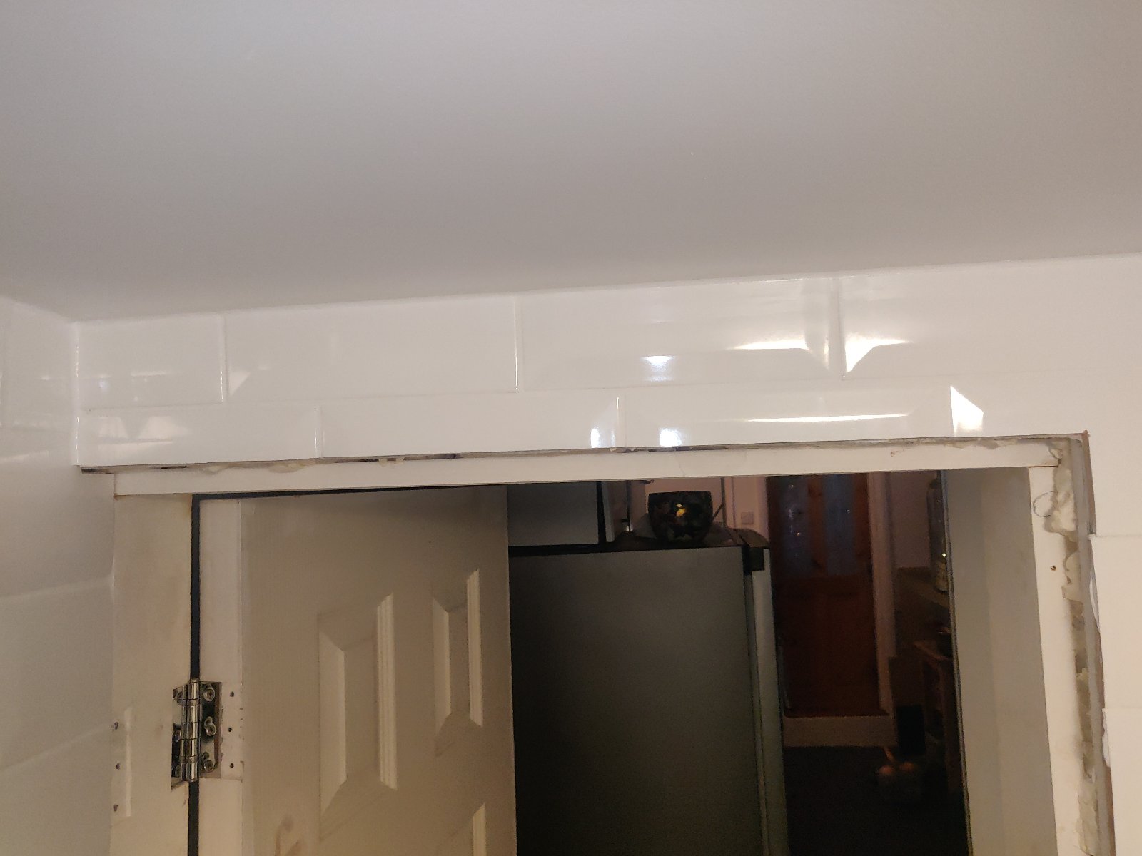

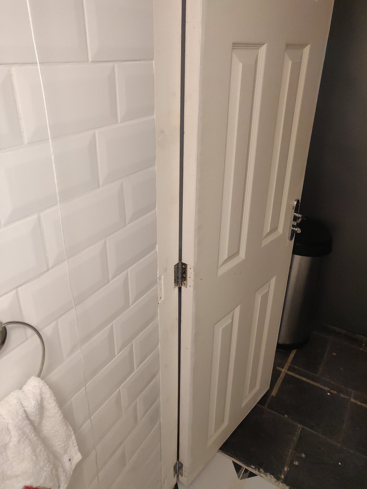

How do I fit this architrave around this frame without it looking a mess? Door lining recessed behind walls on inside of room
25 Nov 2022
29

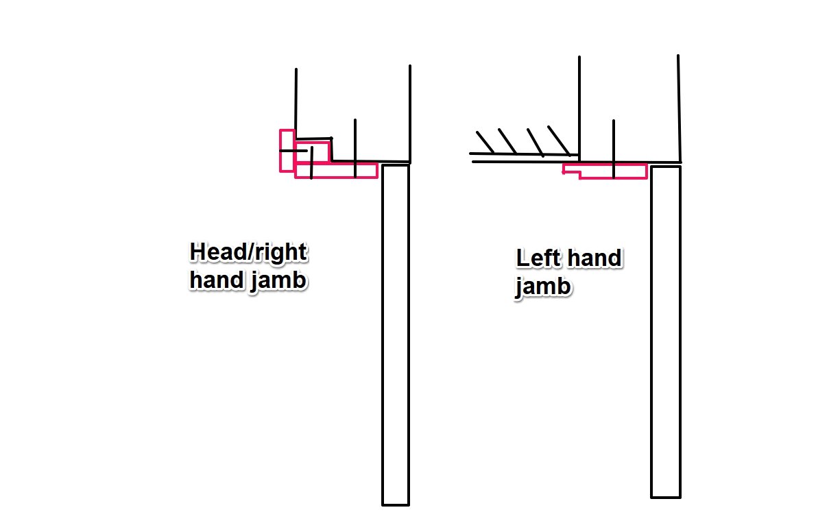

I'm thinking I could get some wide, planed timber for the door stops (top and bottom), wide enough for them to come out flush with the walls and tacking architrave onto them. Probably have to concede on the left-hand side and fill with grout.
Any good?

Tiles should have been higher (meet a vertical surface) at the end to prevent flooding and the end wall rotting with damp.
Was the tiling self inflicted?
i wonder if a tiled return would be the easiest option, as pinning to the door lining is the only real physical way to secure as the added thickness seems to be adhesive and tile ??
What about replacing the door linings?
The hinge-side is a lost cause - leave that
Replace the top and catch side with oversized framing that protrudes 1/4 to 1/2" into the batroom and then just silicone the return. No need for any architrave
