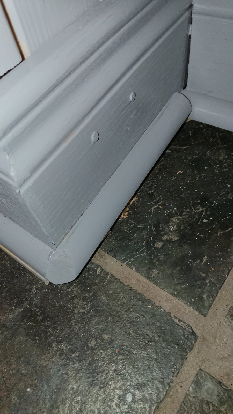

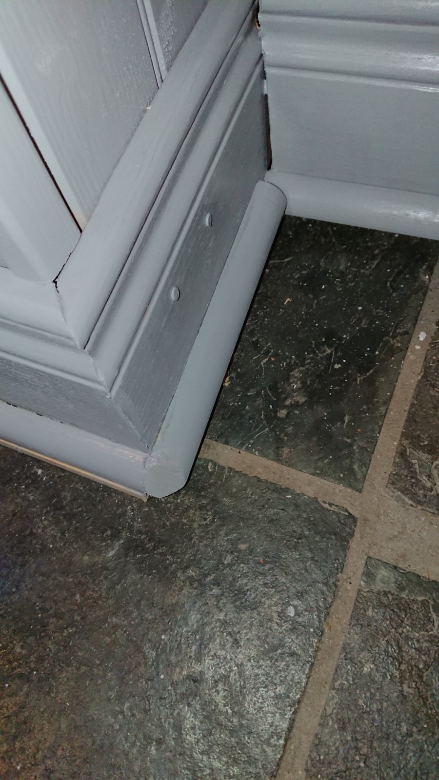

Any ideas how I can fix this corner please (see pictures) ?
It's bearing along bottom of skirting as floor is a mile off!!
Re-do, but use 22.5 degree mitres instead of 45 degree ones. This means that you'll have a small triangular fillet on the very corner, but it will look far more professional. Bond the pieces together using Mitre Mate or similar mitre adhesive after cutting (but before installing) and install as a single piece (glued up from 3 components)
