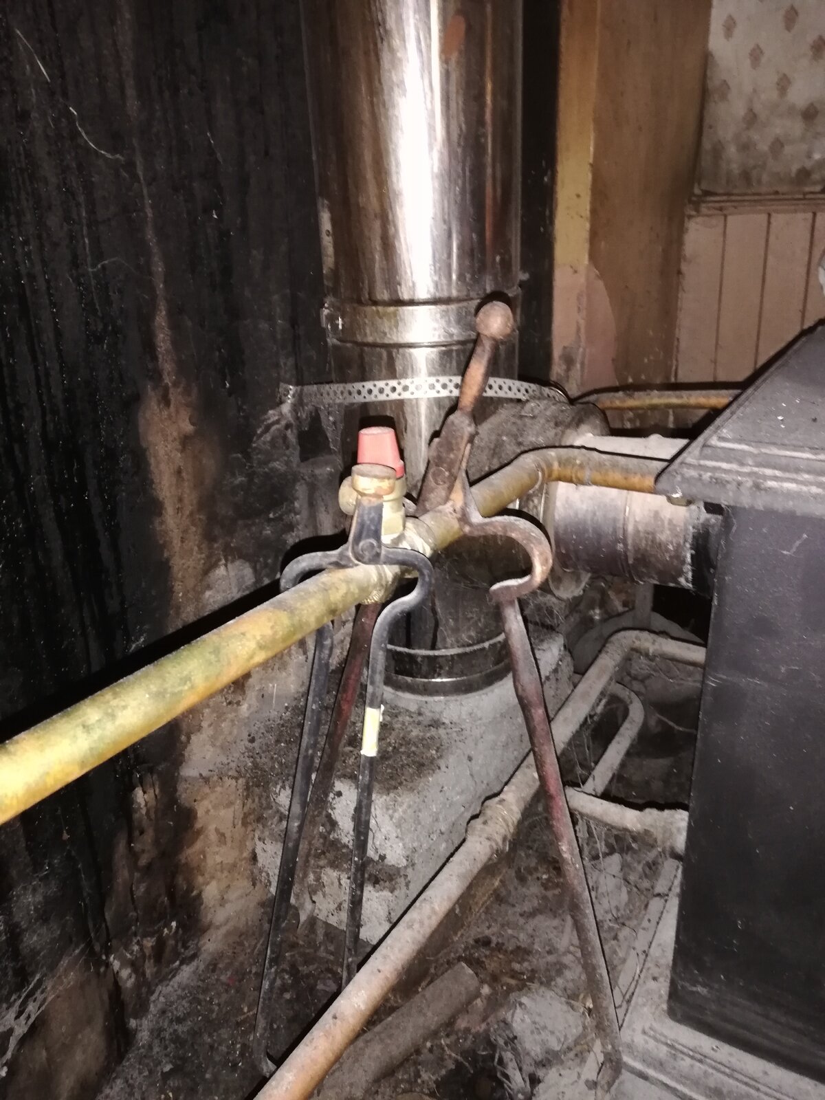

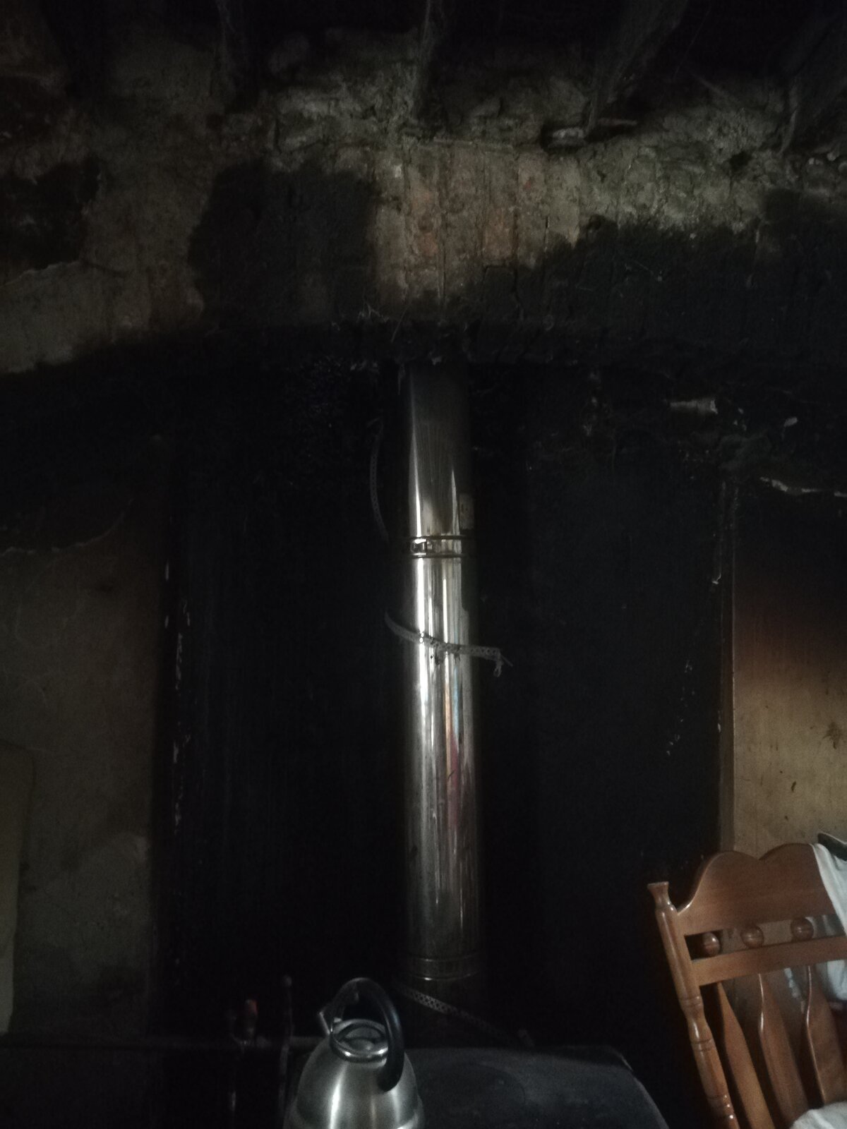

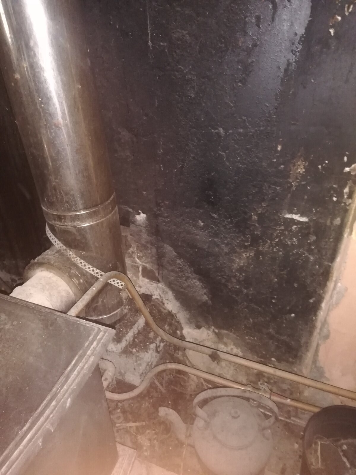

How do I hide these pipes from the stove?
4 Apr 2021
10
Ireland
I'm only concerned with covering them nearest to the wall because obviously I can't cover the stove. There are high up on the left side and then low down on the right. It's a really old and wide chimney that arches at the top so I'm worried brick work would look weird and also come out too far from the top. I'd appreciate any reference pictures :) Also please ignore how gross it looks haha
Horizontal from stove to vertical section is too long and the cap at the on the lower Tee box should be removable so any deposits that fall down the flue can be removed before they block the horizontal section .
rules where your flag represents may differ to Uk but its a safety issue wherever you are
I'm in Ireland.
I'm in Ireland. That doesn't sound good. This isn't the original stove we had when we had the flue installed, the other one was much bigger so maybe that's why. There's another horizontal at the top of the vertical because the chimney is crooked
