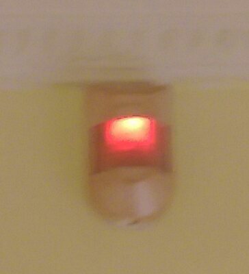

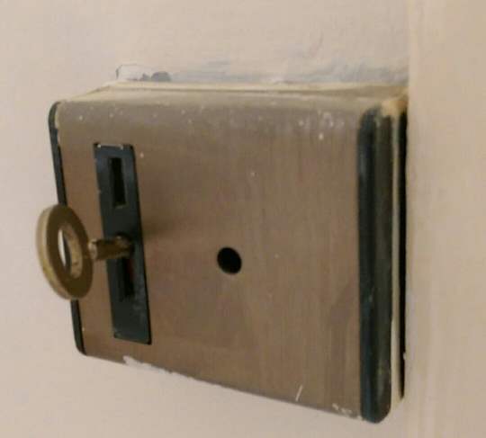

There are the remains of an old alarm system – can’t see anything on the outside of the house, nor anything like a control panel inside. However, there are a couple of sensors which still blink on and off when you walk up the hall etc, and a tiny little box with a (broken) key in it on the bedroom wall.

Yes, you should have a control panel somewhere in the house, try under the stairs or somewhere discreet or even trace where the wires are going. The thing with a key is a panic button.
Thanks, panic alarm eh - wouldn't have figured that out. I can't trace the wiring I'm afraid - it's in the plaster. I guess the system was part of the original house, built in 1994.

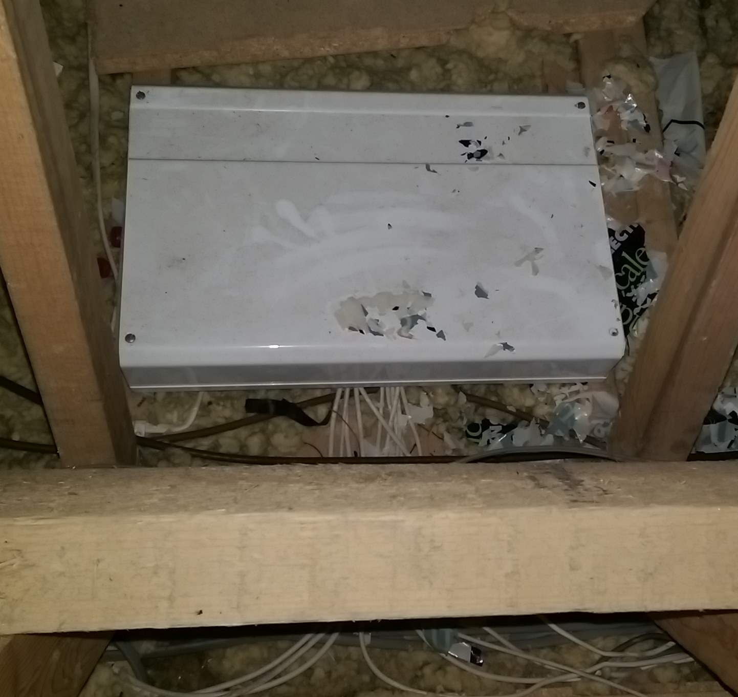

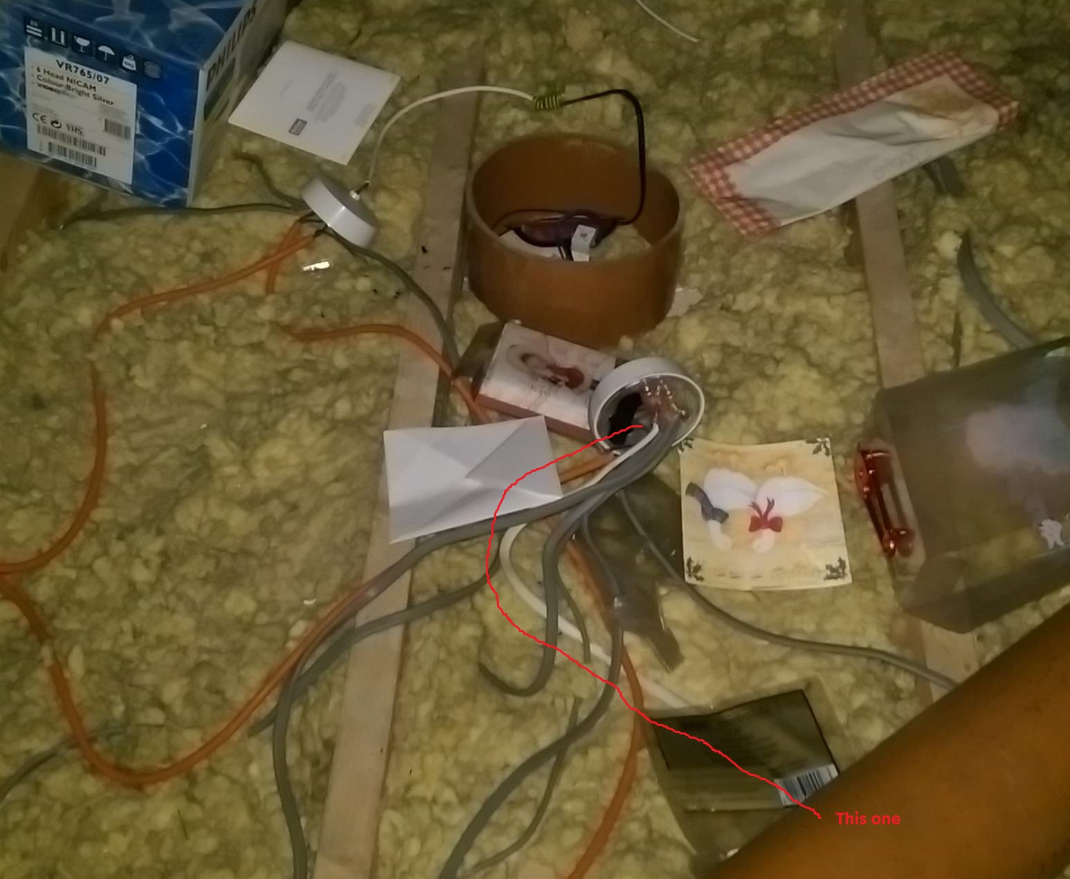

So I finally got up to the attic just now, and found the control box (NOT the keypad) – pic below. As far as I can see, it’s fed by the white mains cable that seems to exit top left, and joins the junction box in the other pic.
Can I just remove that from the junction box, and so power the whole thing down? Or is it likely to have a battery backup inside, and start squealing?

Open box , disconnect battery , pull out internal fuse .....now see if the bell rings outside ....if there is one ?bit of luck the bellbox battery is no good or it has a 20 min cut off timer ...worst case open bell box and disconnect battery
