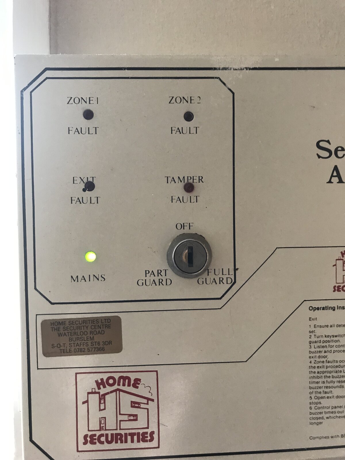

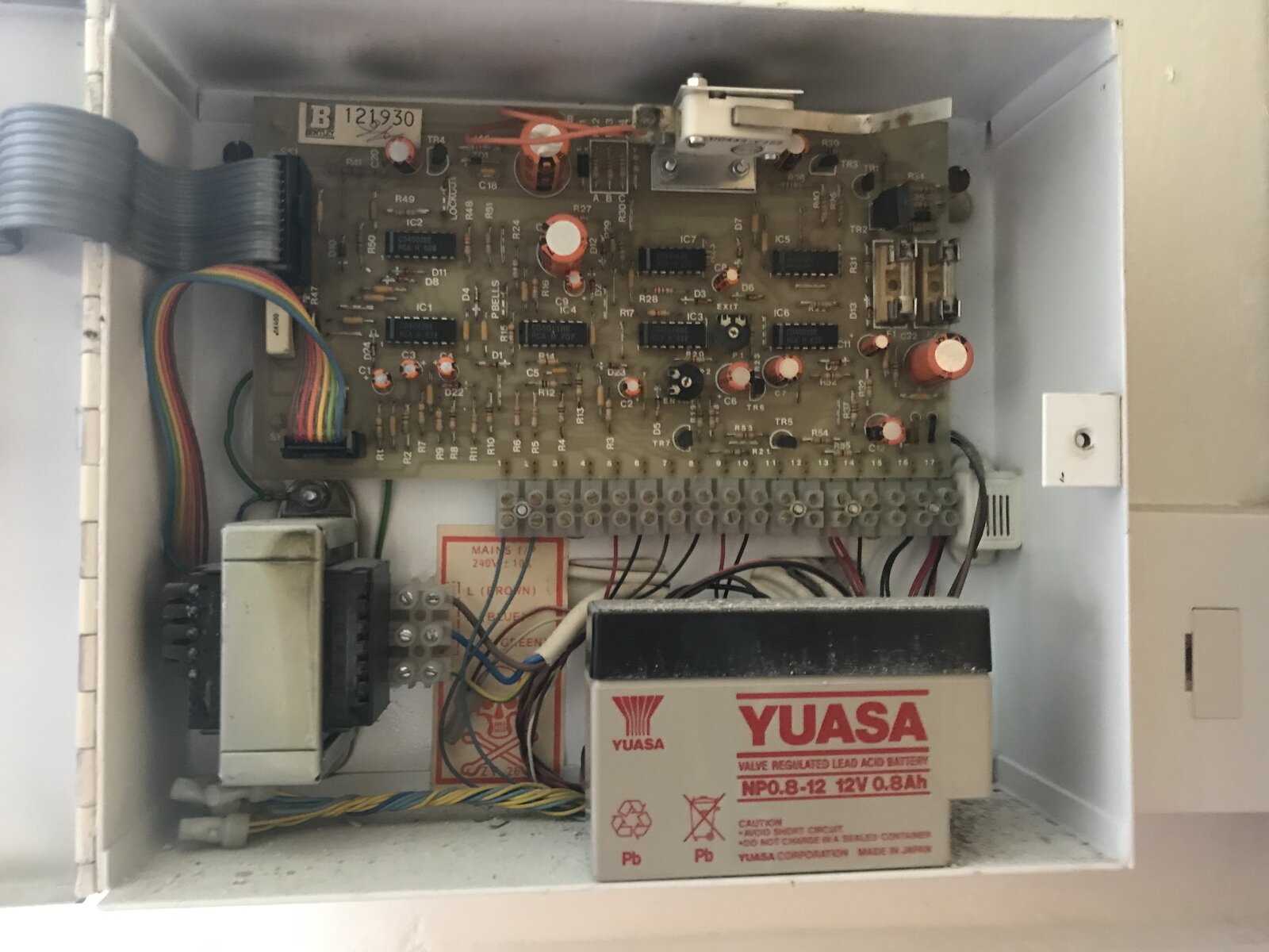

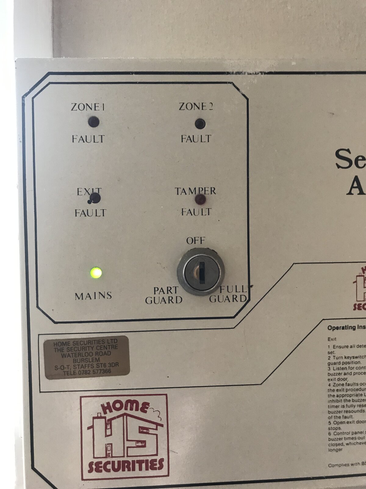

After 5 years of not being able to find the key for my house alarm and numerous internet searches I finally managed to locate the key number and purchased a new key. This is an old-ish wired alarm, no key pad or fancy bits, just a key to turn on and off but had been excellent until the key went missing.

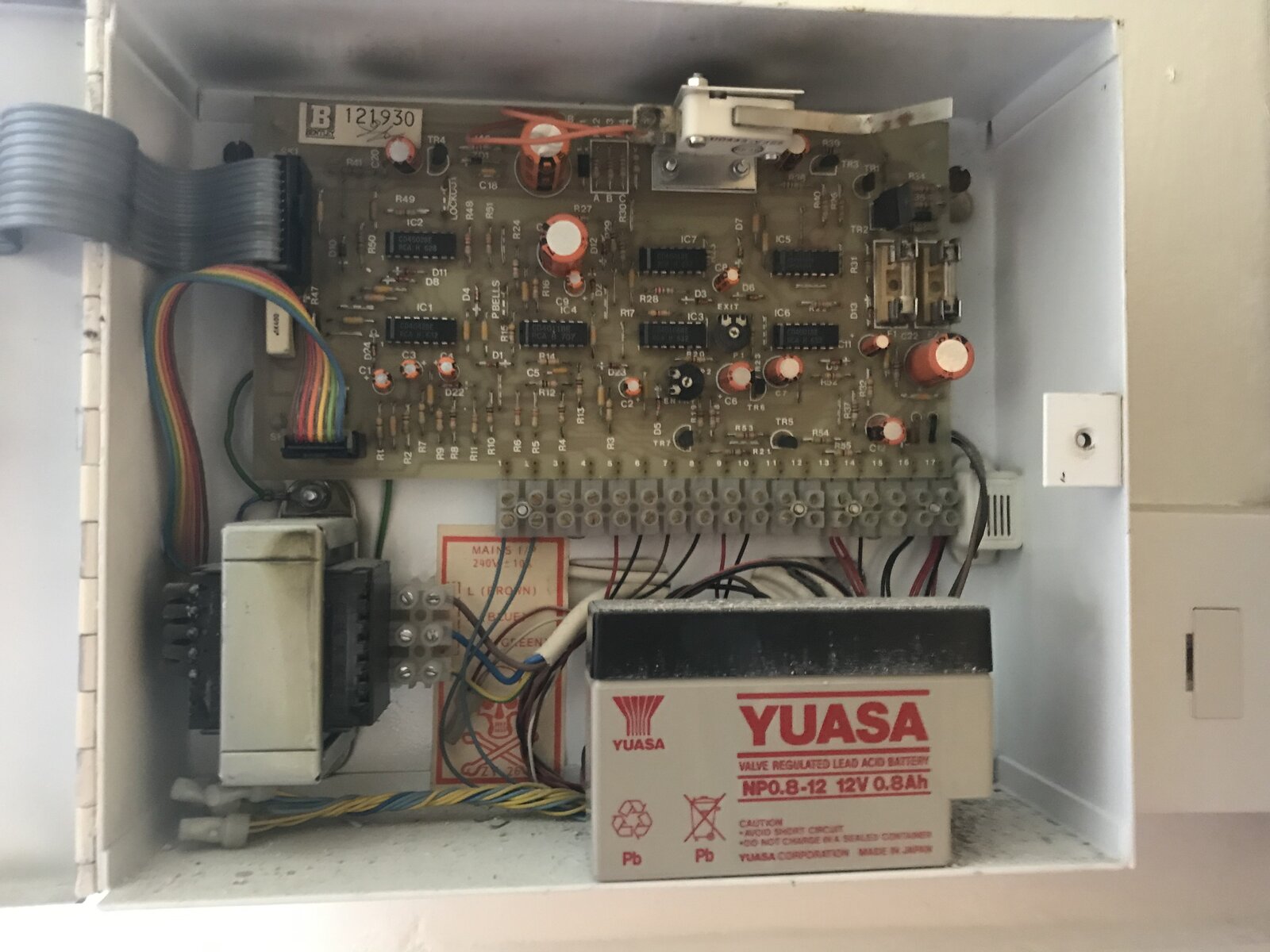

I've switched it on and it showing red indicator lights as there being faults. Obviously this bit works. The panic button works, and the outside alarm box is very loud when the panic button is pressed (plastic key to turn this off). There is only one sensor high in the main room and this seems to work as it intermittently flashes 'red' when it senses someone, this is how it has always been.

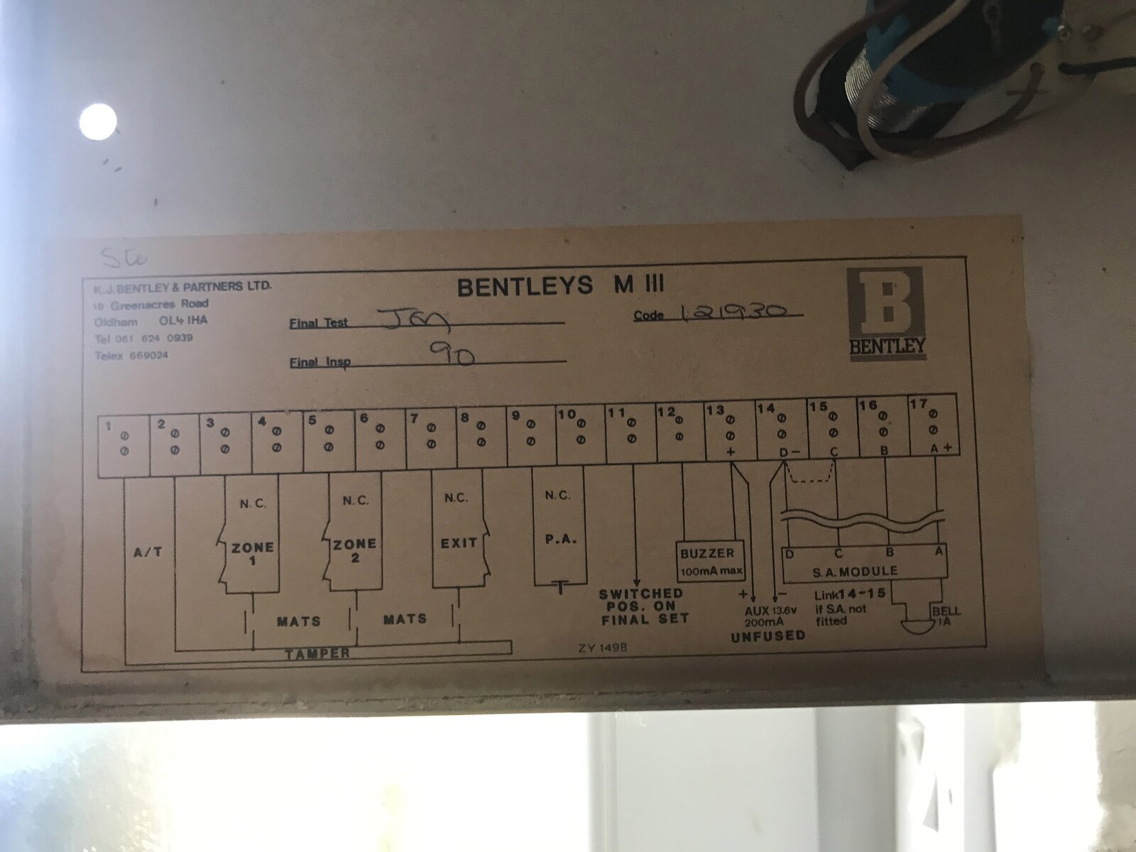

I've attached some photos, if anyone can help with this I'd really appreciate it otherwise I'm looking at £££££ for a new alarm which I just cannot afford.
OR, am I wasting my time ?
Can anyone see anything that's not quite right, apart from its age.

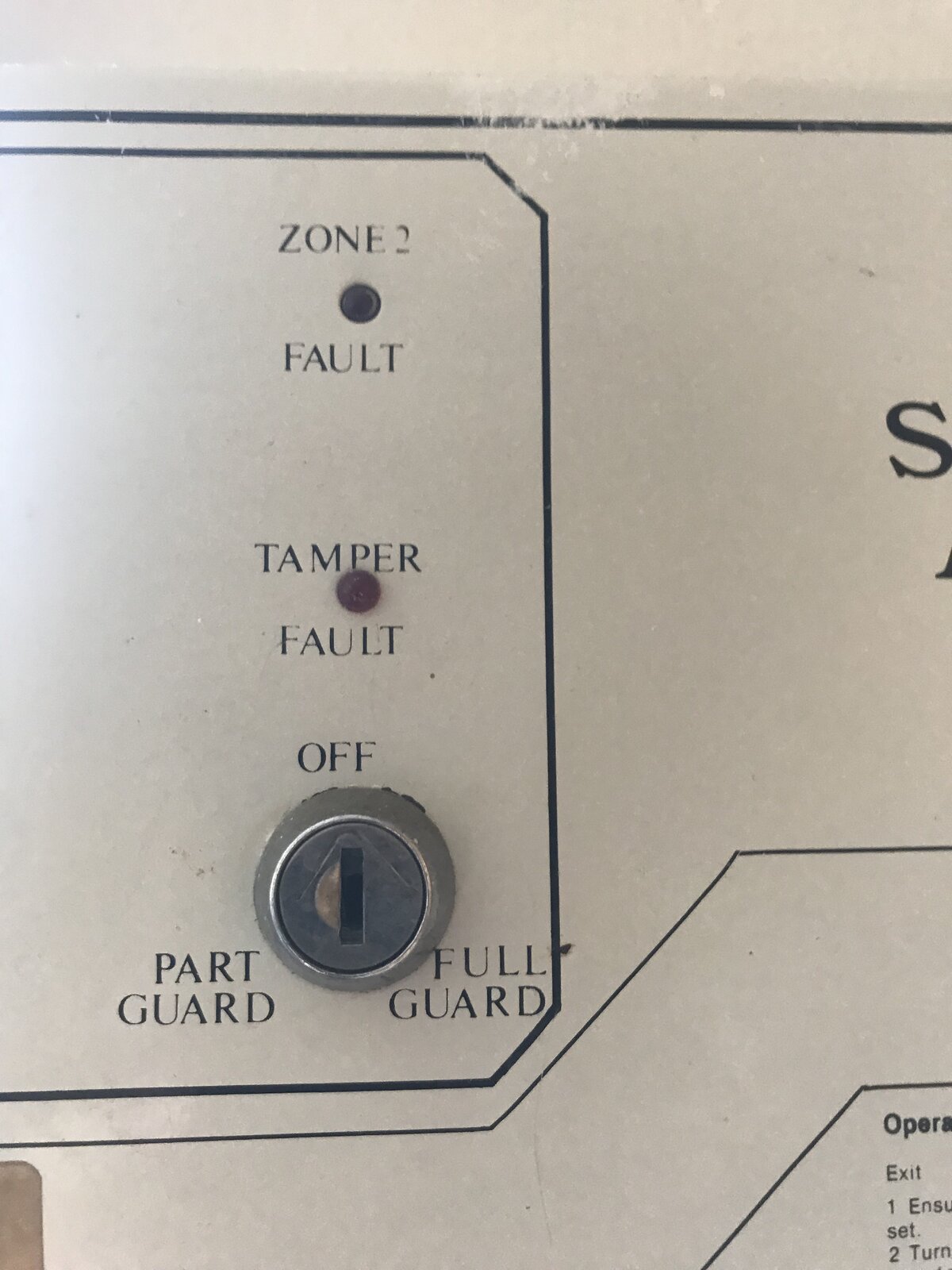

When the key is turned to switch on there are 'bleeping' sounds, the 'exit fault' lights red and the 'zone two fault' lights red.

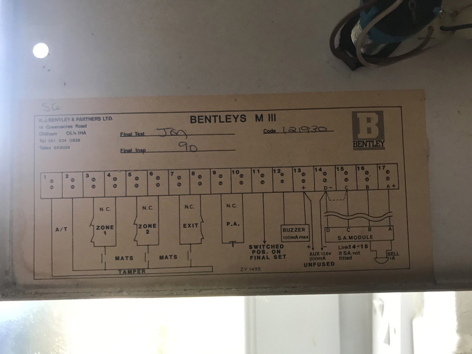

3&4 have been bridged out so no circuit one, 5&6 on circuit 2 is probably the living room detector, 7&8 is the entry/exit circuit so if you haven’t got a contact on the front door, that more than likely will be your problem. Try bridging out 7&8 and see if the alarm sets and works properly. If it does, you need to find the wires that go to the front door and fit a door magnet switch.
Looks like the mini buzzer should be connected to 12 and 13.
