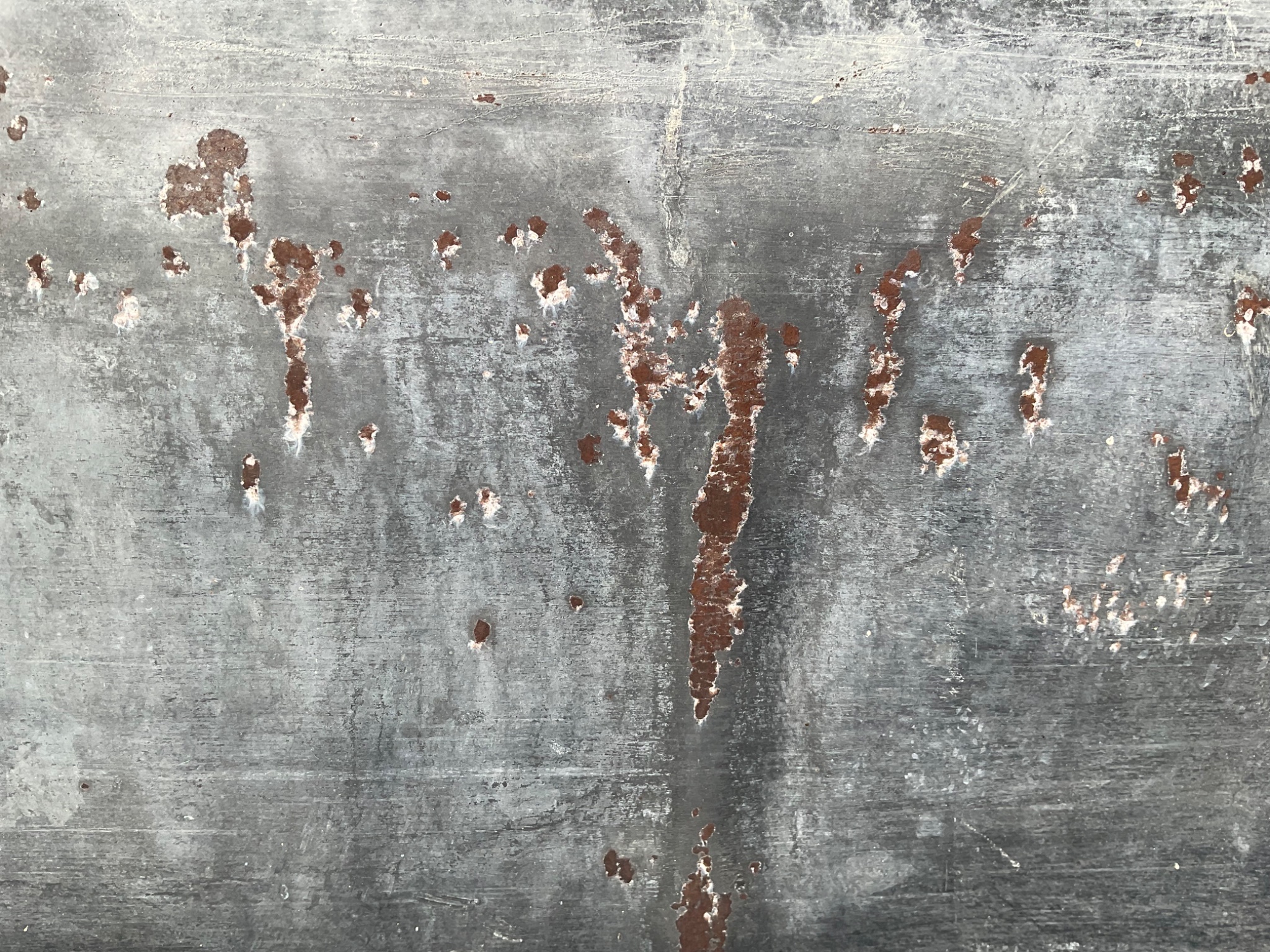

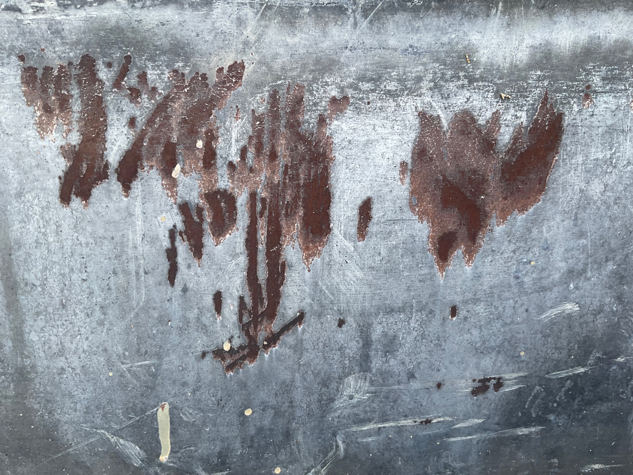

Your advice appreciated on how to remove these stains on old lead flashing please:
Already tried white vinegar which does a great job on the white oxidation streaks, but it doesn’t touch these dark brown ones.
Thanx
Lead flashing cleaner.
You can get oil for lead flashing to make it look better after
What that rust? Use a specific rust remover, try the purple spray commonly sold for car wheel brake dust.
Thanx
Has someone been grinding metal near to the lead?
Woody : My understanding is that rust is an oxide of iron/steel. This is lead, so although it looks like rust, it can’t actually be rust.
Look's like wood stain to me.
Not covered when staining windows
When lead is stored in damp conditions prior to installation it can cause degradation of the surface. Not sure this is what's happening here but it might be.
I've found that Bostik Flexacryl in black or grey is a good covering to paint onto discoloured lead flashing. Unlike normal paints it doesn't flake off.
I gave Hammerite rust remover gel “Back to Metal” a try, just in case it was pitted in rust:
No change whatsoever.
Next I tried Midland Lead Cleaning Gel “ a specialised trade chemical designed to remove dirt, grime, oxidation, and stubborn rust or orange stains from both old and new lead flashing.” -
It took a very long time, with the assistance of ultra fine wire wool, to remove a single 2” stain!
Next stop is Oxalic Acid.
