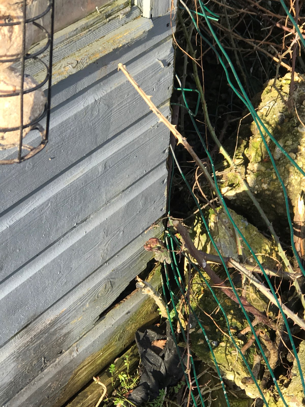

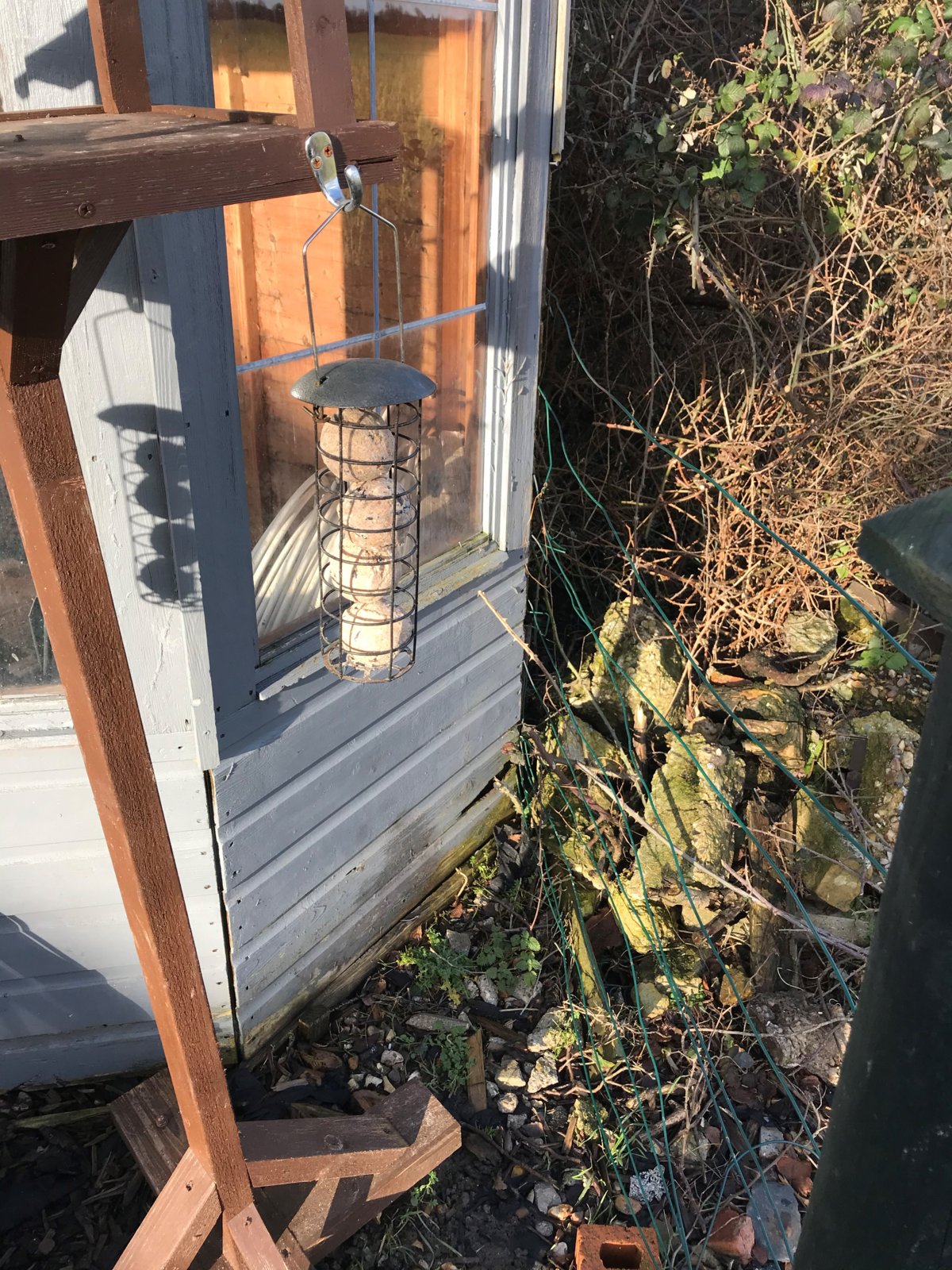

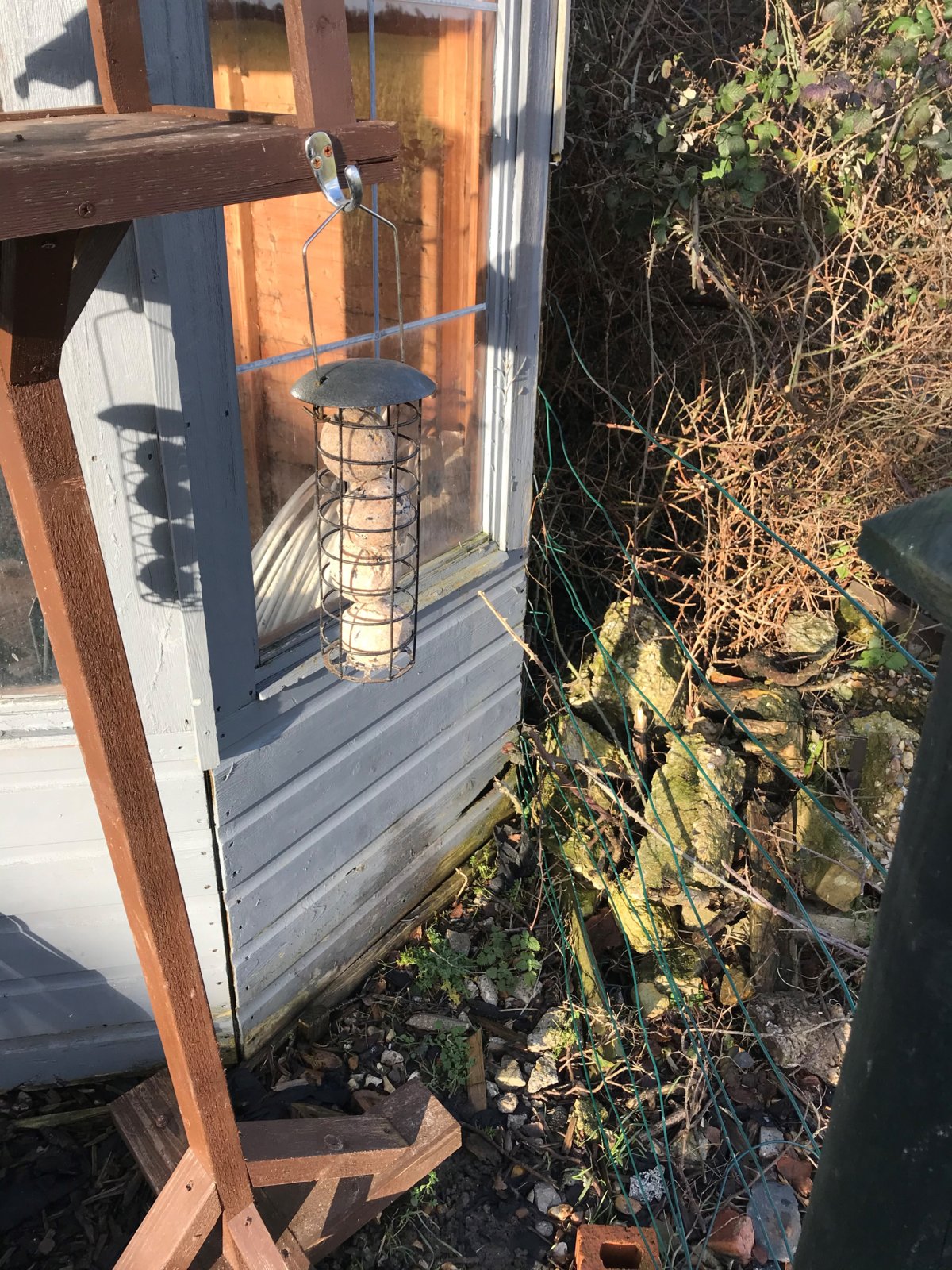

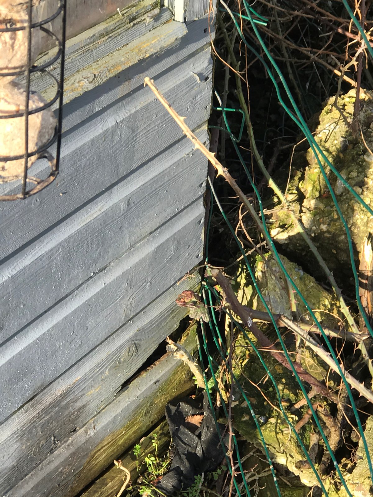

How do I repair this damage on my summerhouse
30 Mar 2015
3,828
58
It looks like tongue and groove boards to me. I was wondering how I can replace/repair this please.
Thanks in advance.
Shiplap.
You need to see if can get a matching profile and replace the boards
If the biards arent identical, Id replace all 5 boards thennyou havent got the problem of the rebates not matching
The ones at the bottom are very prone to damp and rot, so after cutting to size, and drilling the screwholes, treat your new ones very thoroughly with wood preserver (not stain) before fixing. It can be useful to prepare a few extra boards as spares for next time.
Use brass or stainless screws
Only put one screw through the board at each stud. If you use two, it will split the board between the screws as it cannot expand and shrink as the weather changes.
If there are no gutters, or they leak, rainsplash will accelerate damp and rot.
