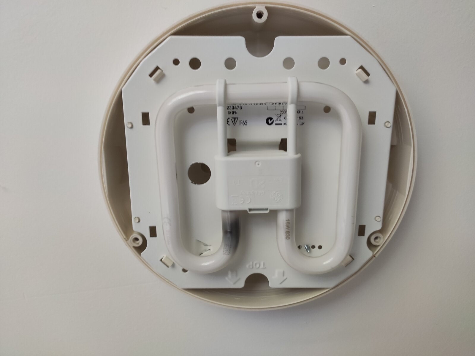

Hi,
First post and pretty useless at anything DIY related ...
The bulb in the bathroom has stopped working so I took the cover off and found a contraption I'd never seen before.
How do I get this bulb out and get a new one in?
Thanks in advance.
Oh, here's the 'contraption'.
Grasp the plastic section in the middle, then pull directly out from the fitting.
Looks like a 18w 2pin. Might be difficult to find a replacement. You may find it beneficial to replace the entire fitting with an LED version.

Thanks for all the help. Most appreciated.
I'll have a go at taking it out tomorrow. If I survive I'll put new one in.
