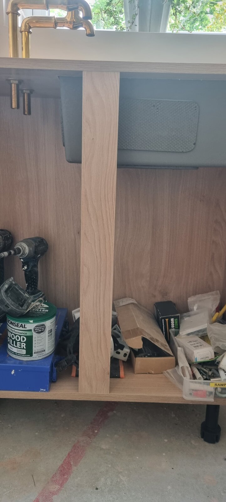

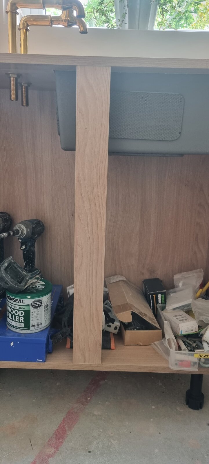

Our groundsman installed this soil pipe for us as we wanted plumbing under the sink. How would you suggest i plumb the sink P trap to the soil pipe? Do i go out the back of the cupboard down the wall and cut into the side of the soil pipe with one of those boss straps and cap the top? Thoughts appreciated!
Plenty of adaptors available, the plastic ones will need a 110mm socket rather than just the pipe.
