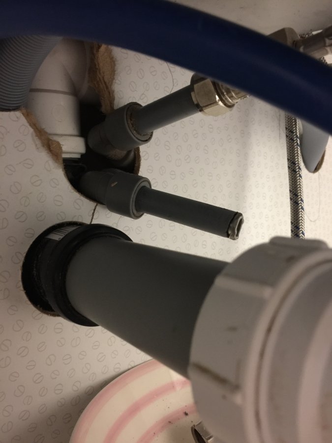

How do I take a feed from these pipes for a dishwasher?
Using one of those yokes you'll need a male fitting.
To put the extra bit of pipe and reattach the valve after the T, is so you have an isolator on your sink tap again.
Screwing the ends of your flexi's straight onto compressions ends too tightly is an easy way to cut the rubber washer, the end of the fitting has a sharp edge, and it will leak.
Using an adapter or male iron, the mating face of the connector is wider and doesn't cut into the rubber washer when tightened.
Well spotted on the male fitting requirement for the brass Y connector. Missed that.
I was just confused on the need for an isolation valve when there is already a shutoff valve on the T connector. Granted the T connector shuts off water to both connections but I would have that would be ample. Any how thanks for your input. I'll let ya know how I get on ;)
Nope, the valve on the T only shuts off the washing machine /dishwasher outlet, it doesn't affect the throughput of the water to what would be the tap flexi feed
Awh, OK got you now. I was looking at it that it shut off water to 2 outlets. Once you mentioned "throughput" I am now looking at it differently. This may be a silly question...but let's take this image..
Why isn't the male connection closest to the red plastic jobbie not connected to the main water inlet and both ends of the T connected to dishwasher & washing machine? Would that way not mean the blue twisty thingie would shut water off to both of them?
Because it's an appliance servicing valve. It allows you to isolate the appliance without isolating everything else downstream.
Because the male connection is where your appliance hose screws on, hence the lever controls the appliance only.
In your case, one of the remaining compression joints takes the incoming cold supply and the other takes a tap tail adaptor and feeds your kithcen tap.
