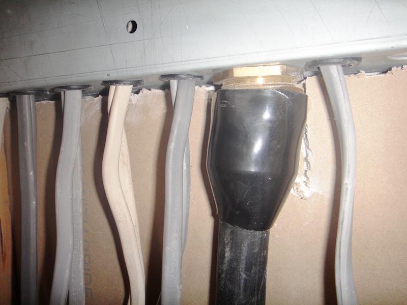

As for attaching the SWA, I've attached a photo but if I pulled the plastic sleeve back then I don't think I'd get it back on with it how it is. I copied this from the previous installation, which had no other earthing. It does touch the CU box, which is definitely properly earthed. And it may have been earthed at the other end, I guess that would make more sense.

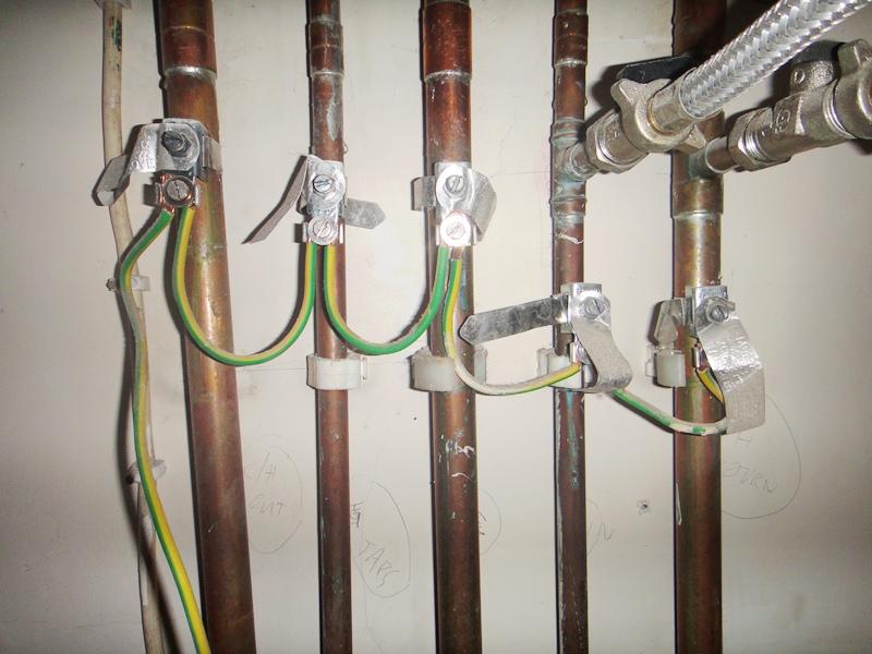

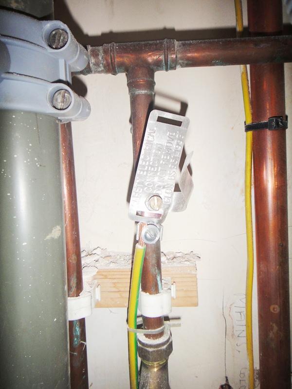

Couple of people also asked about the bonding. Here are a couple of photos, but this is just what was already there, this isn't my work. But looks ok to my untrained eye...
Glanding looks wrong to me.
No support for the incoming cables outside the CU?
You mentioned earlier that 25mm incoming earth would not fit in the board that could be because you only need a 16mm from the main earthing terminal to the Consumer Unit. You also only need 10mm for the main protective bonding which generally includes water and mains gas.
(a)10mm cable should be connected within 600mm of the utility entering the house on the consumer side of the stop cock and run back to either the main earthing terminal or the earth terminal in the consumer unit.
Your picture of the pipes being bonded together does not show this and I would conclude is wrong.
You appear to have your ch and hot water pipes bonded together why?
You should ensure that (a) is in place first.
Finally your consumer unit tails should be 25mm2 are they? They look more like 16mm2 to me.

Let's have a look at the SWA gland.
You should be able to remove the shroud and put it back.
I trust all the armouring is in good contact with the gland.
Let's have a look at the SWA gland, then you might get some peace and quiet.
