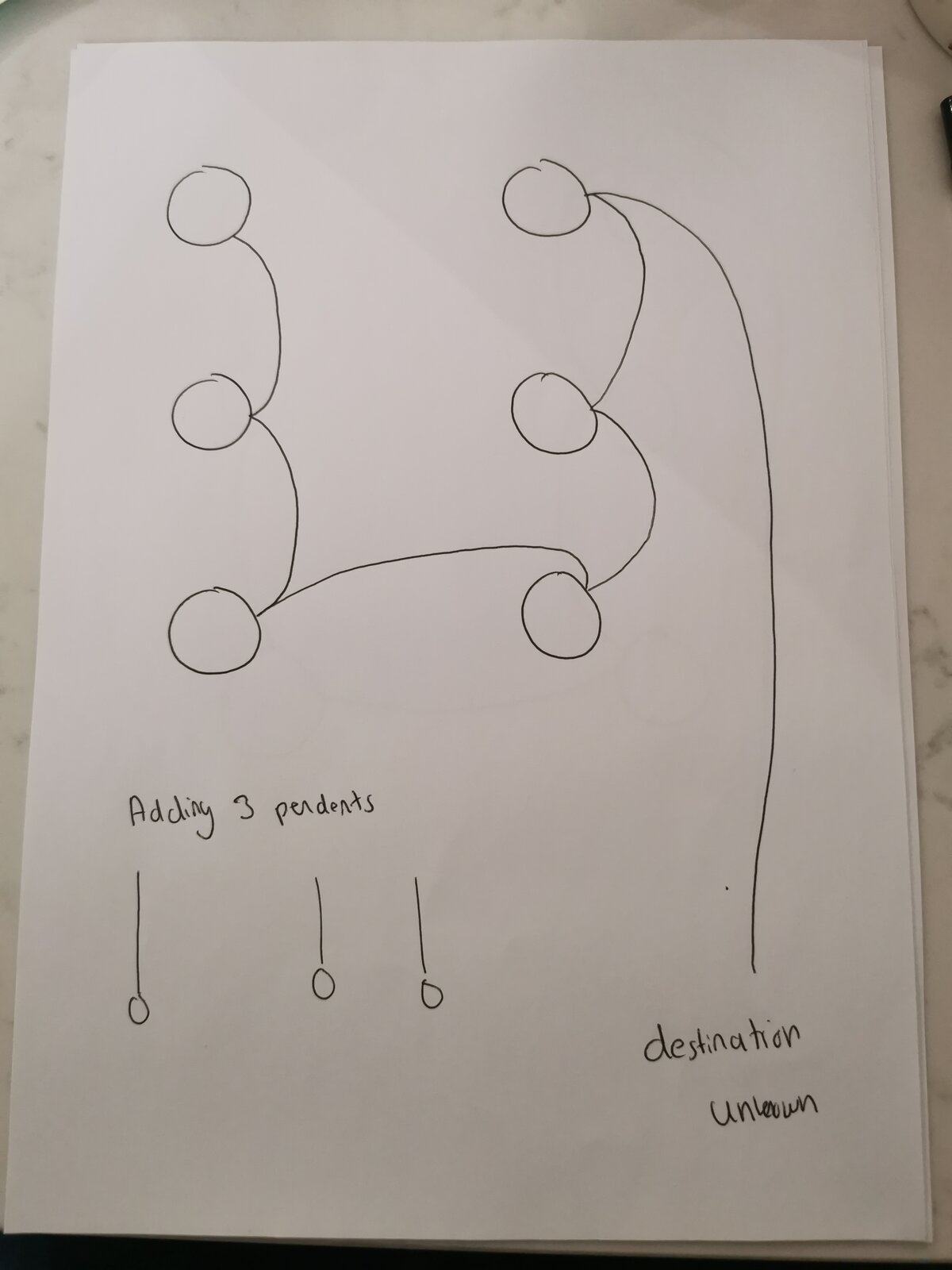

I am looking at adding some lights to a kitchen lighting circuit. Iv had a poke around to establish the initial circuit and it's going to be a "leave it to the professionals" job, however, I would like to satisfy my own curiosity and frustration. If anyone would be kind enough to explain I would be extremely grateful.
I have drawn a diagram of what I know so far.
Where would the "unknown destination" cable be going and why can't I find a switch cable - could it be wired from a terminal to the switch directly?
In which case, how would I extend the circuit?
I only have one MCB feedback all my downstairs lights.
The switch arrangement is two gang. Two cables into one switch and 3 in the other for another set of lights.
As it is drawn, presumably the unknown destination is the switch and it is a switch cable.
I don't think you are using the word terminal correctly but - yes.
Run a cable from the switch to a new switch and then the lights.
Ok. You will have to use the switch with the electric supply.

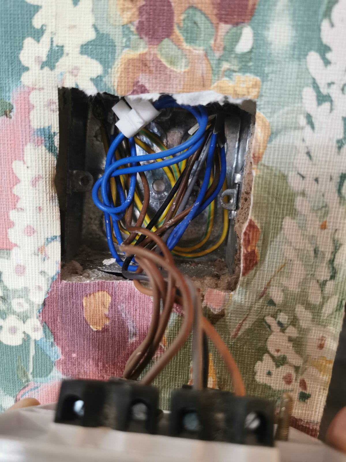

The standard British wiring uses the ceiling rose as a junction box, so when it is replaced with down lights, we should have a junction box
to replace the ceiling rose, the other method is to use the switch back box as a junction box, as done in many other countries. But where the change has been done DIY we often find a mass of tapped up cables.
If there are three wires in a switch it is likely two-way, i.e. connects to another switch somewhere else.
Often wiring of lights is dictated by the access we have to wiring.
So what?

I think I meant - the wire from the fuse board goes to a junction box directly to the switch and from the switch feeds the light circuit, correct?
I want the new lights to be on the same switch, in which case, could I just continue off the last downlight, it's connecting to a 3 way terminal block for the new lights fitting.

The standard British wiring uses the ceiling rose as a junction box, so when it is replaced with down lights, we should have a junction box View attachment 406239 to replace the ceiling rose, the other method is to use the switch back box as a junction box, as done in many other countries. But where the change has been done DIY we often find a mass of tapped up cables.

Yes, that's right. The 3 cable is feeding a two way. So does that mean that the 2 cable is one power cable going into the switch and one cable going out to the first LED i.e. The unknown destination wire.
I have no idea where the junction boxes are hidden

Feed in, feed out, maybe a 3 core for the 2 way going to the next switch, feed to downlights
No junction box needed.
Thank Pete. I see, so the live cable would go to one switch and then just feed all other additional switches?
