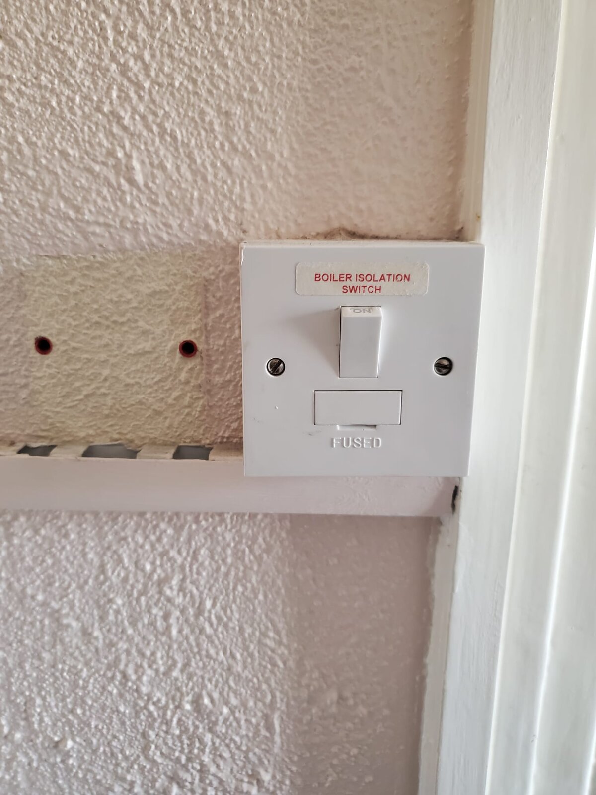

We moved into a house last year and are about to decorate the hallway. It's a smallish hallway and there is a switch (The boiler isolation switch) stuck right in the eyeline as you walk in. Our plan is it literally move in 3-4feet to the left and 'hide' it (not box it in) with a plant.
As you can see the cable runs along the bottom of it and in a conduit. That conduit goes along that wall the whole 3ft then up the wall. There is nothing else attached the the cable along that wall. To me it looks like a normal spur plug but with a sticker on it.
We don't have much money as we've since become carers for a family member (long story) and are doing everything on a strict budget. So called in three electricians who quoted us £250 to £300. Neither of them looked in the plug or even at the cable. They just looked at the outside of the plug and gave me the quote so i don't believe there is any hidden nasties.
Now, i know they're very skilled workers and I doubt I could do 99% of what they do but that seems a bit excessive for moving this box 3 feet along a cable that's already there. Am i wrong in thinking this?
So, this is my question. I have, in the past, moved a normal double plug back along the cable and it was very straight forward. Is there any difference for this? If it isn't recommended how 'easy' is it to change the facia to something a bit nicer looking?
additional: The holes next to the plug were from the old boilers wireless control.

2 cables - 1 for the supply and 1 for the load/boiler ?
are they both running in the conduit =- OR does the cable come to the spur from behind in the wall
take the front of the spur off -
does the front of the conduit click off
wheres the boiler in relation to the Isolation switch

The two cables are running through the same conduit (should have said that sorry).
The boiler is somewhat above the switch itself. I don't know why it didn't just go straight up through the ceiling tbh rather than half way to the kitchen then up.

the switch does NOT do anything else ??
Maybe the extractor fan in the Kitchen - as you say why go along the wall and then up - maybe the upperfloor was easier to get to , to run the cable from there - assuming it goes up through the ceiling
if it really is just 2 cables - Supply & Load coming into the Isolation switch , then no reason why it cannot be moved along
- just a case of shortening the cables
But as i said - maybe open the front of the isolation switch - and take a picture of the cable - just to make sure - if it really is that simple to move
Maybe a photo of where the cable goes UP ?
Well it will be a Switch with a fuse - lookup "fused spur/connection/isolation switch" on various sites and see what they look like - can have different finishes - for example
Clearly, any switch can be moved, but I look at the wall finish, and that will be hard to copy so can't see where the switch was. So I would be looking for something which stays in the same place, but looks better. Maybe a flap

Does it actually isolate the boiler and has it been tested for being live if not?
Can you not move the switch to the floor above, where the boiler is, and have nothing in the hall?
Where does the cable feeding the FCU come from?
Does it come from a socket or straight from the consumer unit?
If the boiler is upstairs, and there is an adjacent socket nearby, you can feed the boiler from a closer socket. Be that a plug or a FCU. You can then remove the original wiring.
