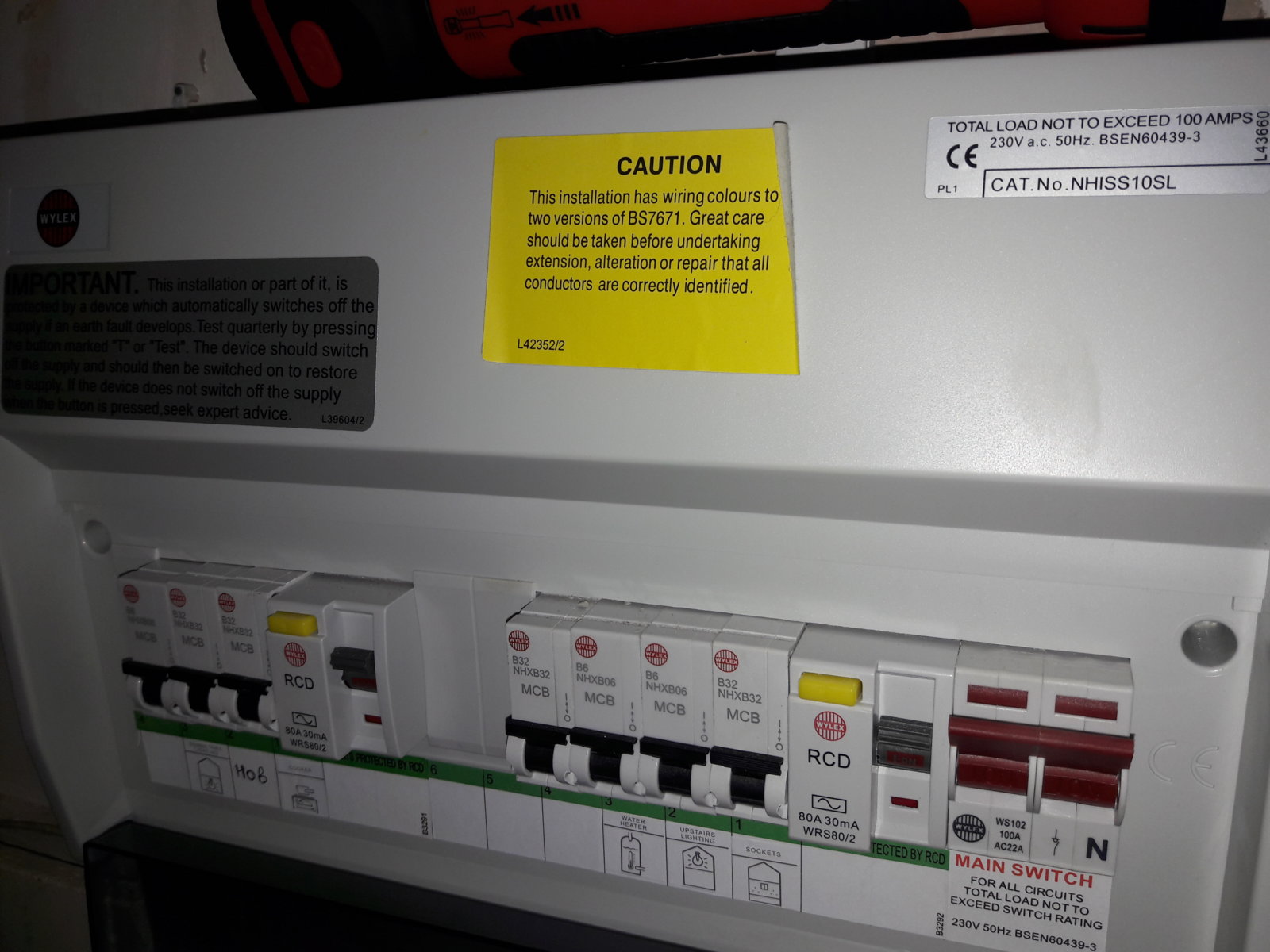

Hi,
I'm in the process of buying a house at the moment and there's a query over the consumer unit. It's a Wylex NHISS10SL - photo below.
The issue is that the seller can't produce a Building Regs compliance certificate for it. He claims that it was installed prior to 1st Jan 2005, in which case there would have been no requirement to register it, but he can't produce a receipt or invoice confirming the installation date either. There's no sticker or anything on the unit itself showing the installation date.
A number of other renovations were done in the house around 2008, so I suspect the consumer unit was done at the same time and the work was never notified.
I've contacted Wylex to ask when this model of consumer unit was launched, but they haven't replied.
If anyone here is familiar with this model of consumer unit and can tell me whether (a) it was on the market prior to 01-01-2015 so could have been installed before that date, or (b) it came onto the market after 01-01-2015 and the seller is telling me fibs, I'd be really grateful for the advice.
Thanks!
There was a Wylex recall in 2010, and shortly after that they redesigned the MCBs in the style which you have.
Wylex have never got back to me regarding a query I had in 2010...
According to 'PriceLynx', the launch of the NHX range which you have was announced around November 2010.
As others have said/implied, it really doesn't matter a jot. Even if it were installed after 1/1/2005 without notification, the 'crime' will have been committed by a person, not the house or a subsequent owner, so it would really be of no consequence to you if you bought the house. As has also been suggested it's such a relatively trivial matter (and, in any event, the seller can claim that they have 'taken it into account' when setting the asking price) that I don't think you would get anywhere by trying to use it to get a price reduction.

Be worth getting the electrics looked at given that it has a "Water Heater" on a B6 which I suspect could be to ignite the boiler? The downstairs lighting is no doubt on the left hand MCB on the left hand RCD?
So one circuit that may or may not feed things that need labelling up.
Edited as I first looked at this and hadn't noticed the blank far left!
