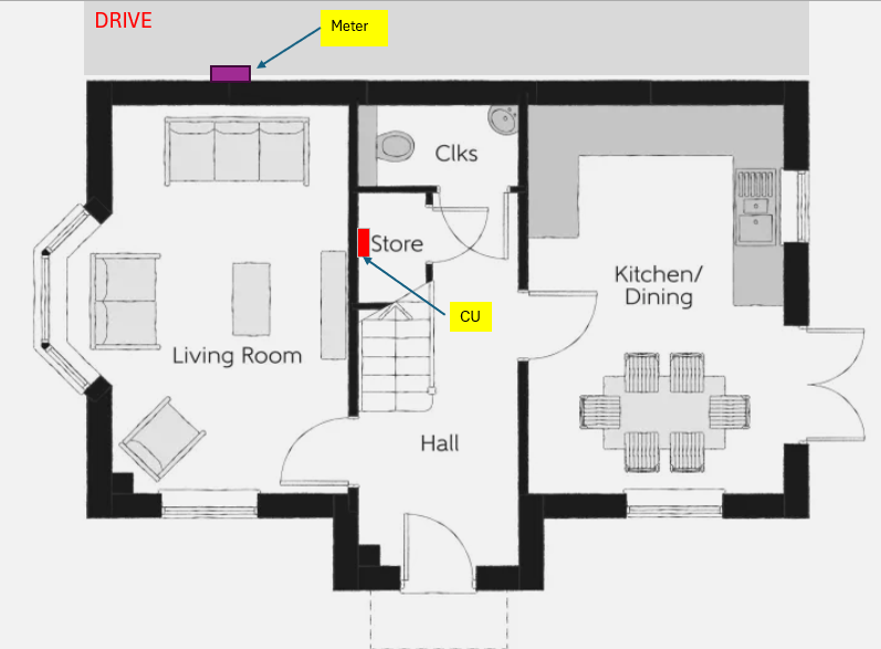

Thank you all. It still seems very murky and it be easier not to buy the property. I know that someone said there might be a clean cable route out from the CU. I attach a plan of the house. The cloakroom is tiled so routing through the room is not desireable.
It could easily run at about ceiling height in mini trunking, which can be painted to match the wall or ceiling.
Nothing makes surface trunking look good in a house
Personally I'd go for the very mormal method of picking up at the meter box.
Despite what others say, CU's IP rated for outdoor use do exist from very reputable manufacturers and many many thousands of them are in use for the purpose.
