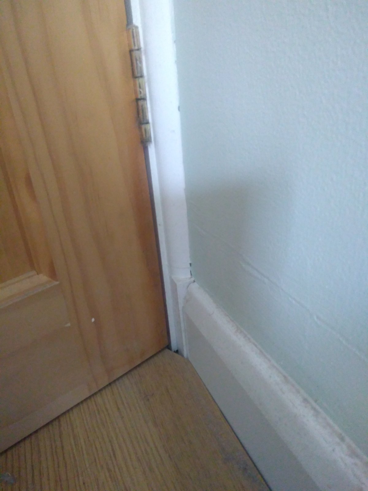

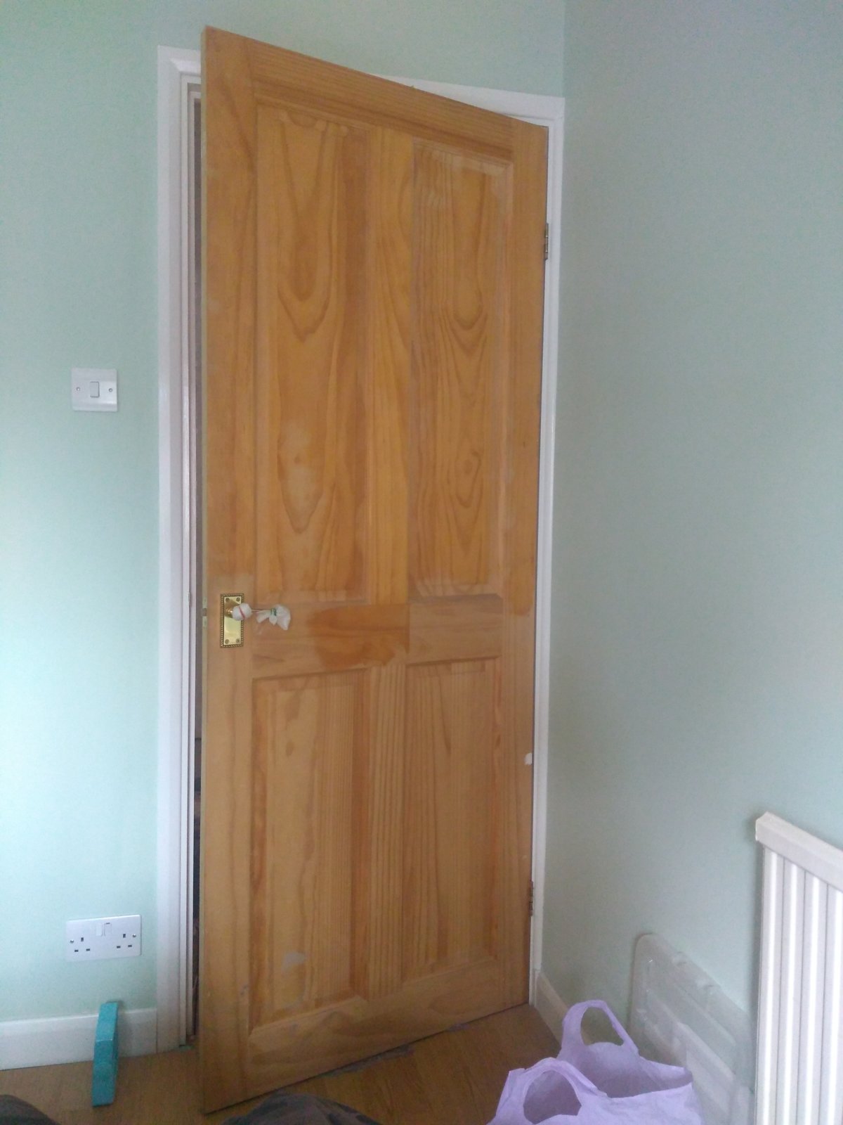

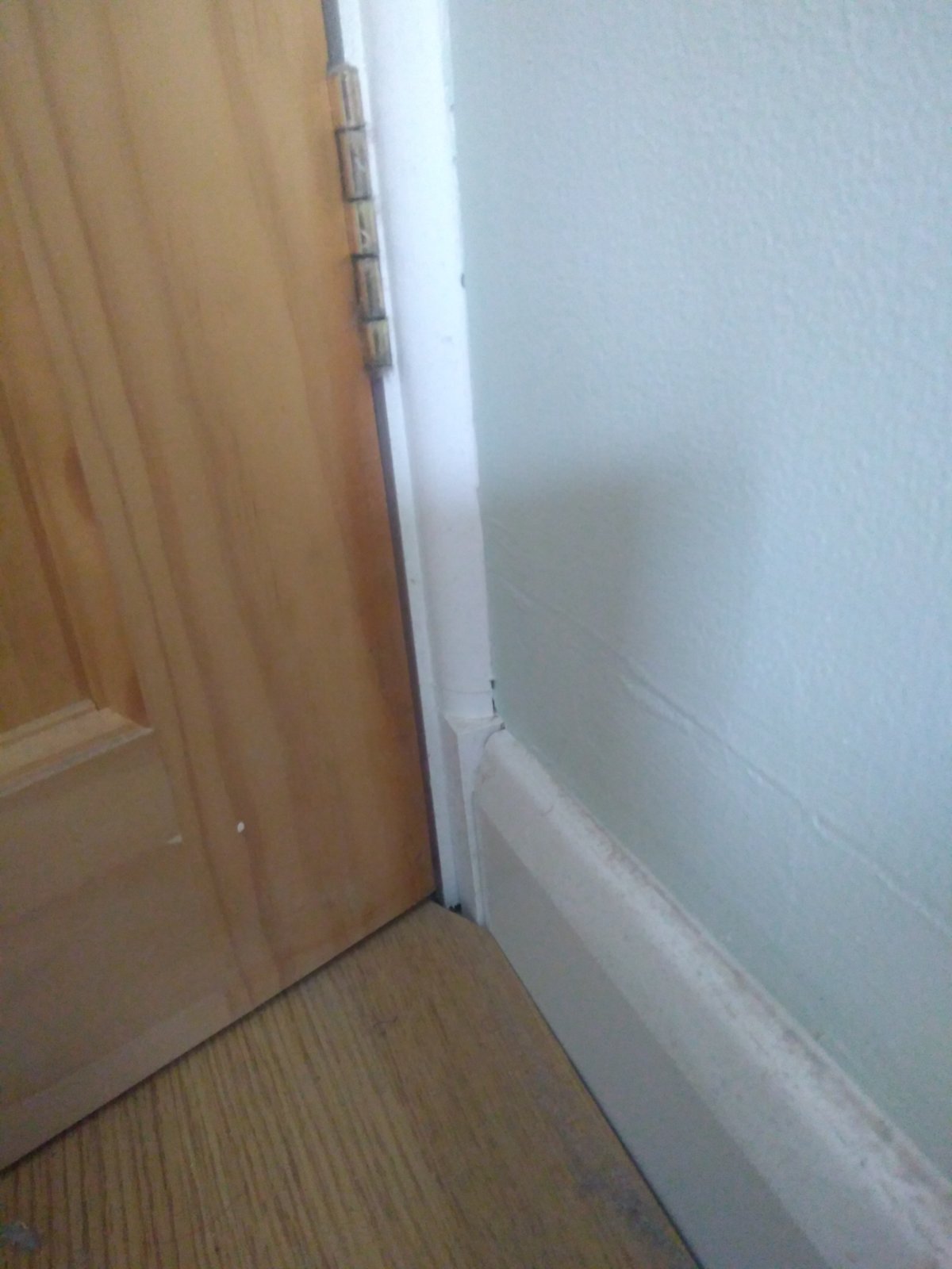

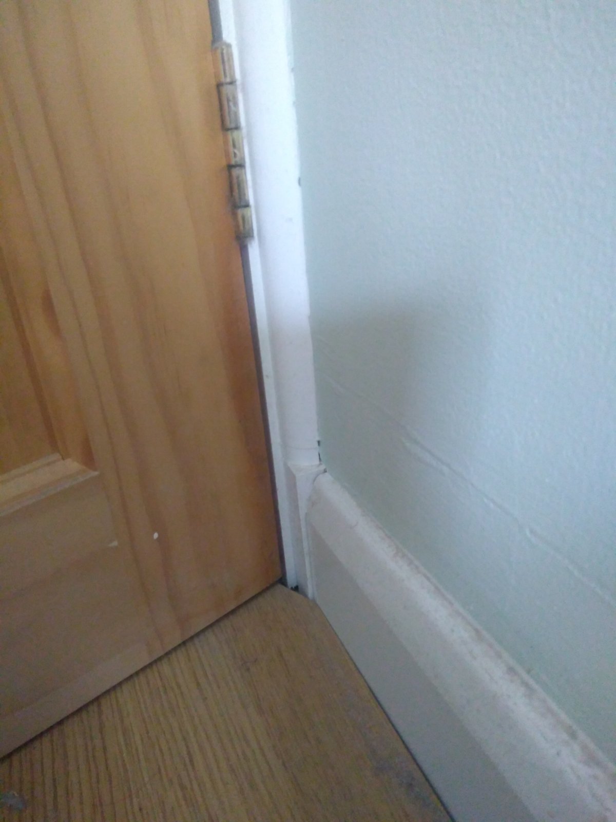

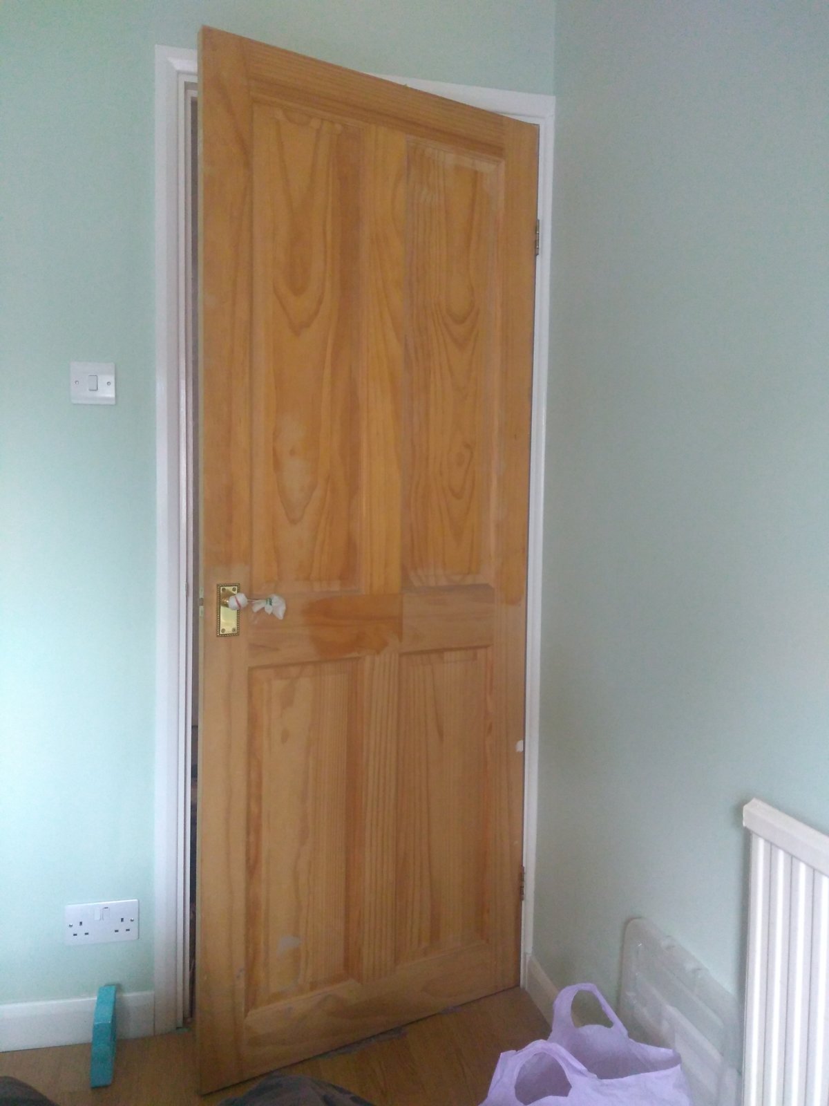

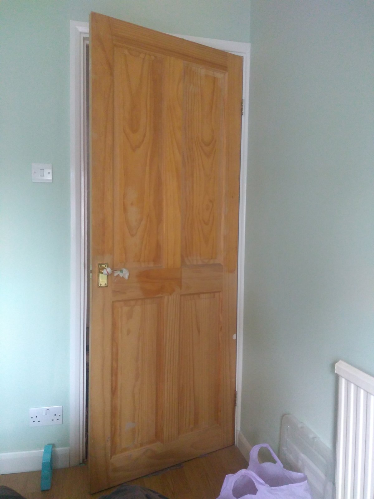

We have a door on the wall, only the lining thickness is off the wall and we just have a quadrant beading in place of the architrave. Looks fine.
The only issue when replacing it all was getting the architrave to all match up at the top and bottom, i used a square block to end the skirting and drop the beading onto to avoid having to scribe it or something.
The door position was set in the 20s when the house was built

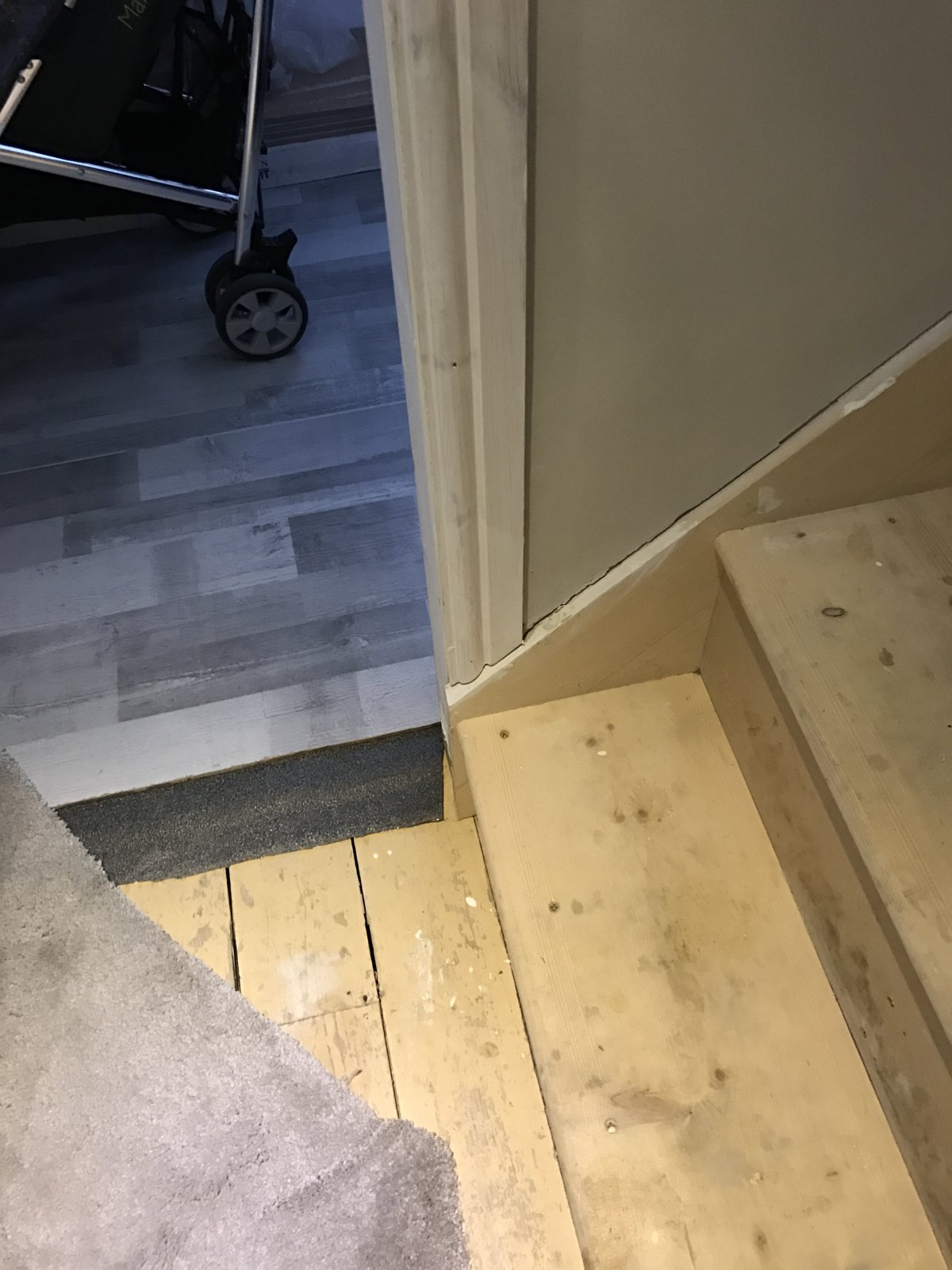

Here are the photos as described above

My downstairs toilet door is hinged right in the corner with a cut down architrave
My bedroom door has architrave but no "extra" wall as it opens into the room with a small square bit of floor forming the door sweep area before opening into the main room.
Just don't choose a massive handle or it will take chunks out of the wall
I have 2 610 doors - into a utility "corridor" and then into a wc at the end, both right against the walls with cut down architrave to cover the lining. I also have biggish handles (and stops to prevent said handles hitting the walls) so they don't even fully open. They're used on a daily basis without any issues or any contortionism! I do have a section of removable door stop so I can get the washer and dryer in and out.
