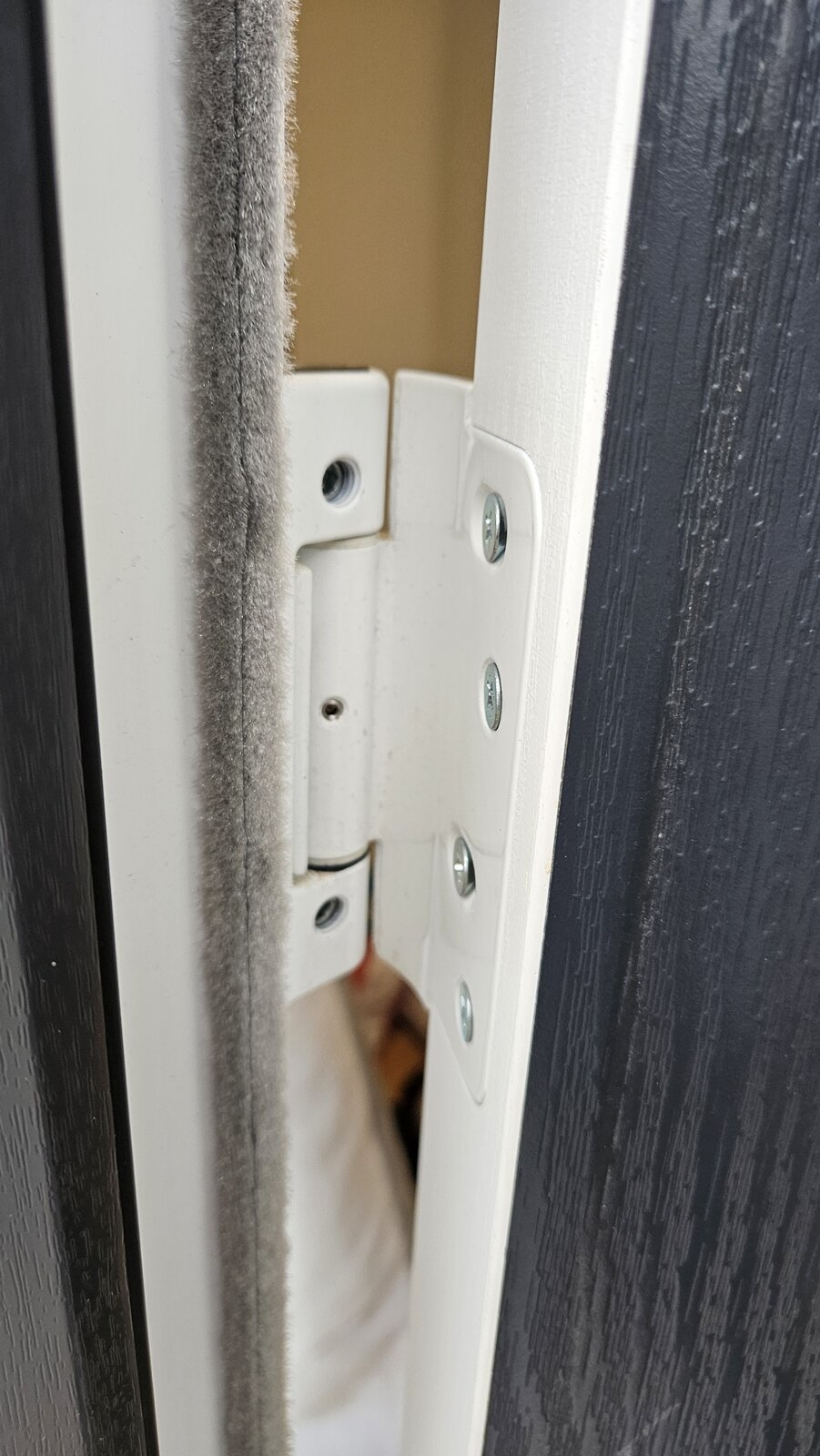

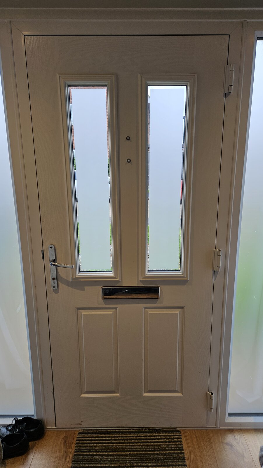

I have seen various guides online of how to adjust doors but nothing specific to mine. Can anyone help. You can probably tell in the pic the door is not central in the frame and needs lifting on the left.
You have Mila Ideal composite door hinges, if you turn the 2 silver allen grub screrws they move the pin sideways, not the best hinge for lateral adjustment with only +/-2mm adjustment
Thanks, what does turning clockwise/anticlockwise do?
Did you read my post, think I already explained it
You did sorry I wasn't clear, both grub screws do the same thing? You have to adjust them equally? Anticlockwise pulls the door in and clockwise pushes it out?
