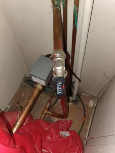

Any idea how I adjust the setting on this currently on .05 need it back on .03 ?
Its an auto something or other has bar settings on it next to one of the port valves
its an auto bypass valve, just turn the plastic cap till your back at .3.
It'll do next to nothing set to 0.5 bar...and those boilers that need a minimum flowrate will need the valve set at much lower settings...0.1 -0.2 etc.
Why do you think it needs adjusting?
It was set at .3 when fitted and some other guy came in and messed with it when ibhad issues with a pump when there was no need sonset it back to how it was when it was installed last year

Yeah I wanted it back to hiw it was installed last year another guy came in fitted a pump and changed it without me realising so wanted it set back to original ...setting ao no idea why on earth he'd wanted to change it
