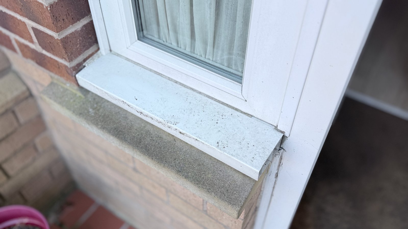

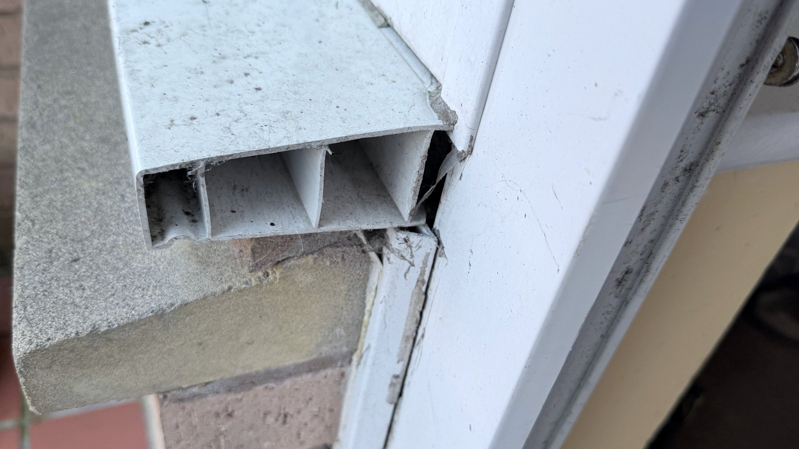

OK so the end capping has at some point detached from an external PVC window ledge and disappeared. Just wondering how to replace it ? Do I cut out and use PVC sheeting + sealant (do such sheets exist?) Not even sure how to google search what I'm wanting to do tbh. Hope the attached pics will help explain.
Any advice much appreciated.

Get a small piece of white plastic A5 sheet from ebay and cut your own, use something like stixall, OB1 adheasive - hold it in place with some masking tape until its set.
