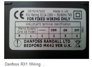

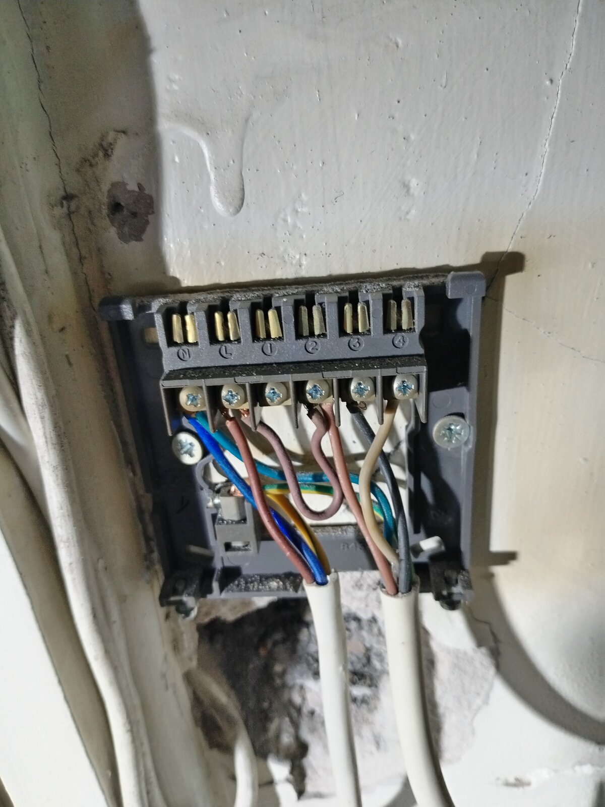

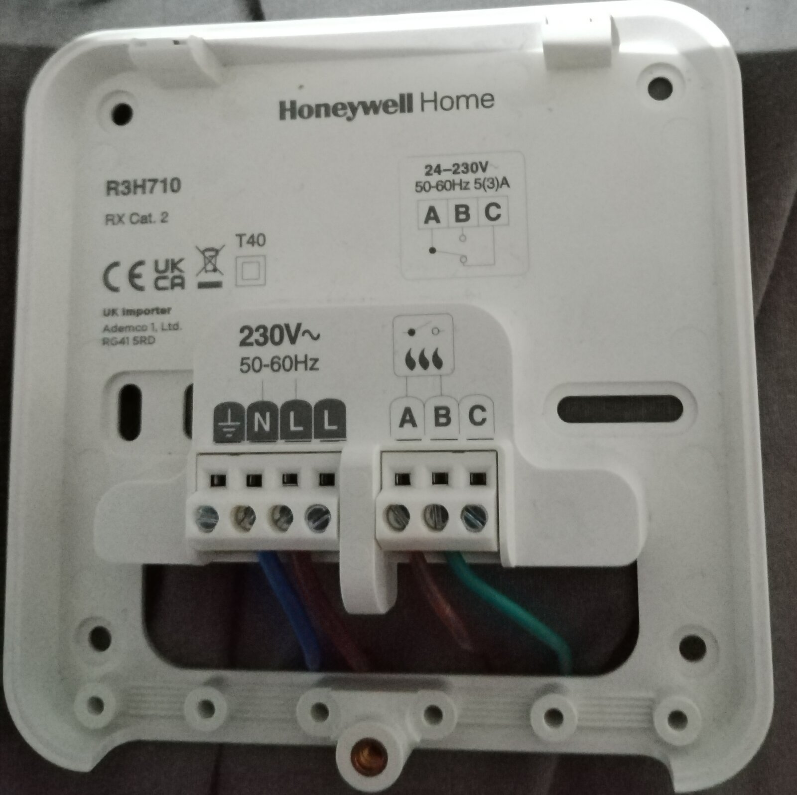

Hello, can anyone help and show me how to wire the 5 wires from my old Danfoss RX1 to the replacement Honeywell Home T3R

The connections for the Honeywell are shown in your photo, and the connections for the Danfoss are usually on the back of it. I think yours will be as below. If it is the same....
....the wires are moved from the Danfoss terminals to the Honeywell terminals that have the same function, like for like.
DF N = HW N
DF L = HW L (Both HW L's are connected together internally so are effectively are the same terminal)
DF 2 = HW A
DF 3 = HW B
Not sure why there is a wire in DF terminal 4, that isn't normally used, but the equivalent terminals are
DF 4 = HW C
